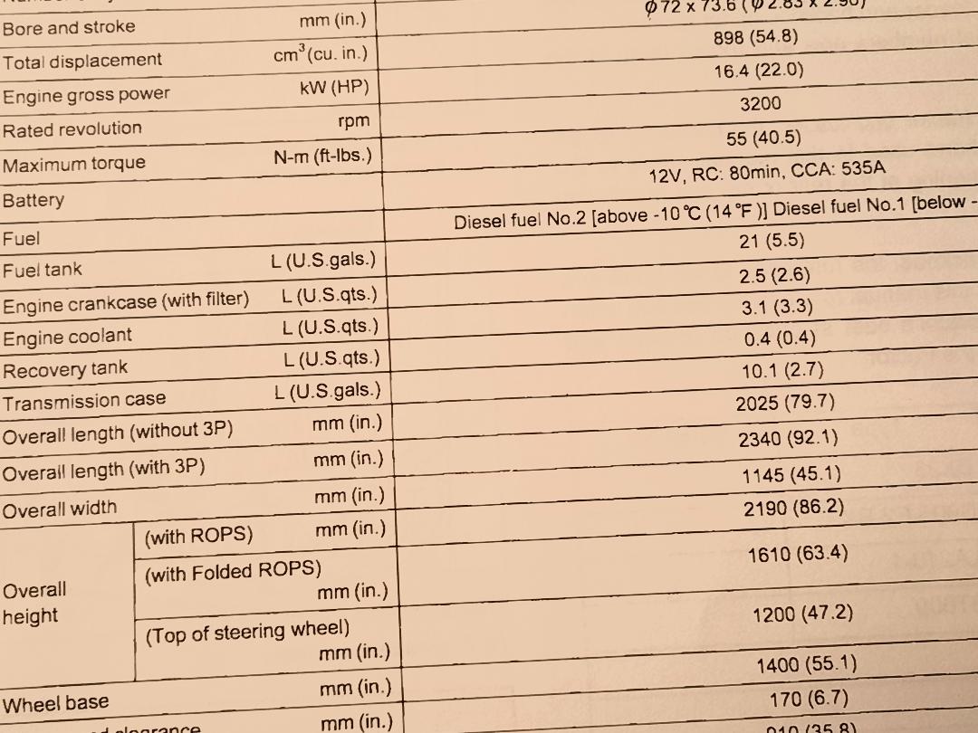

My info says 3.3 quarts of oil in crankcase.............. never ever seen it listed in the 2+ range !

Comments about erroneous info in manuals are certainly valid. Not a Kubota, but I had an asphalt compactor which specified 2.8 qts…. when the ACTUAL capacity was GALLONS. Oriental translations can be tricky.

Picture from manual to valide NIW statement about manuals are often wrong and to show that I am able to read.

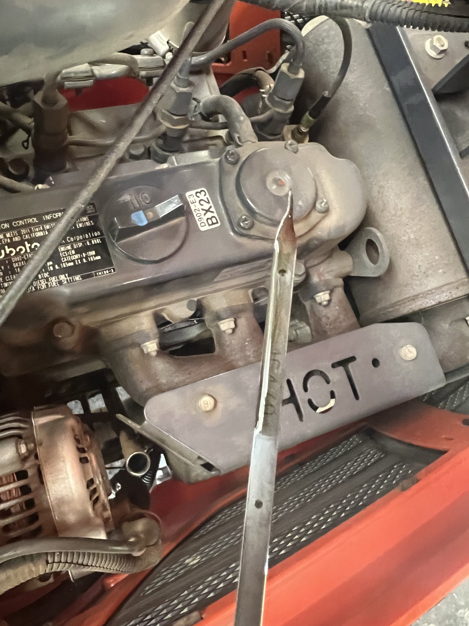

@Tractor Gal - I changed the oil in my BX2360 just now. Same engine as yours.
I fill it to full on the dipstick, or pretty close - don’t overfill.
Thinking it took a little less than 3 quarts. (I started with a partial gallon jug, so not sure exact amount)
About 3 quarts is pretty much the normal for mine and I’ve had it 11 years, so changed oil many times.
After a short idle I get this on the dipstick. Pretty close to full and guessing shortage is the volume of the filter. Close enough for me.
