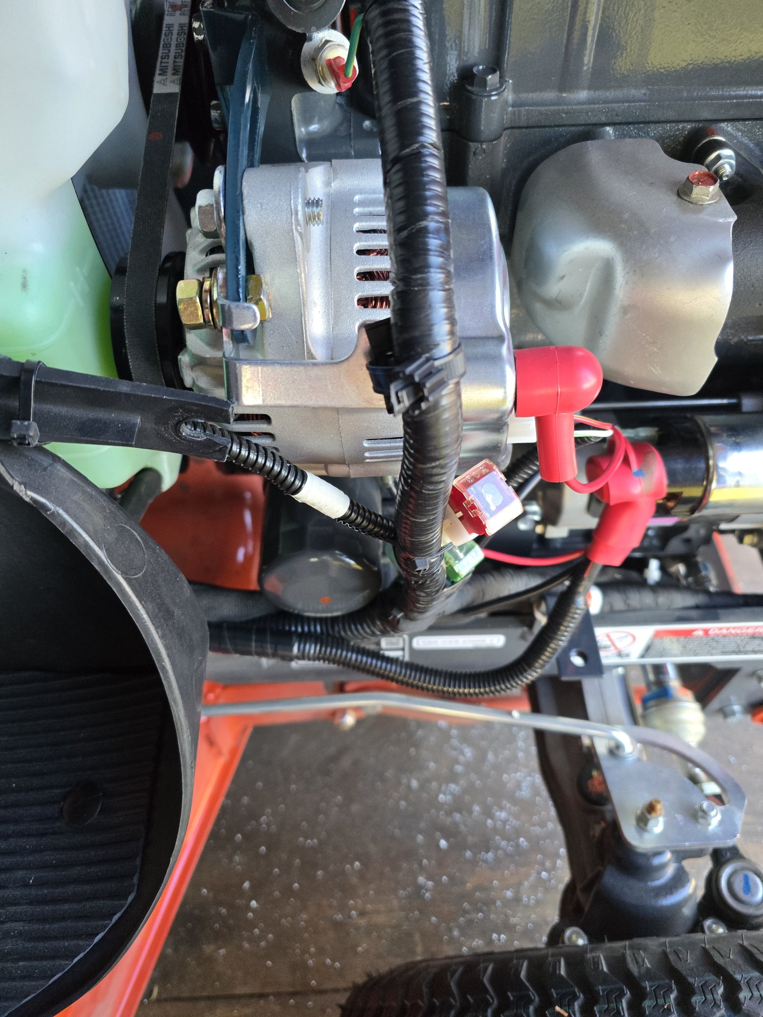

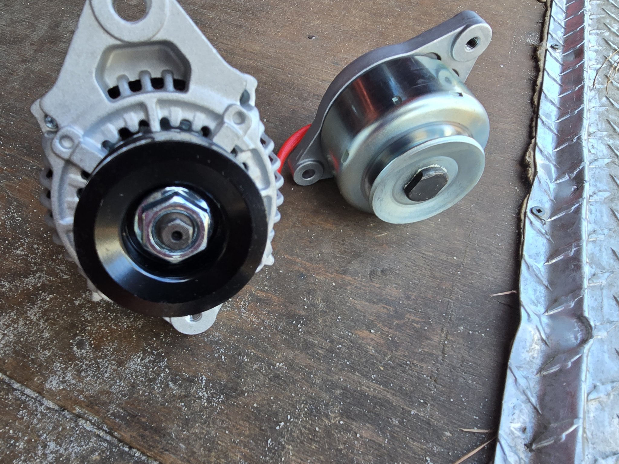

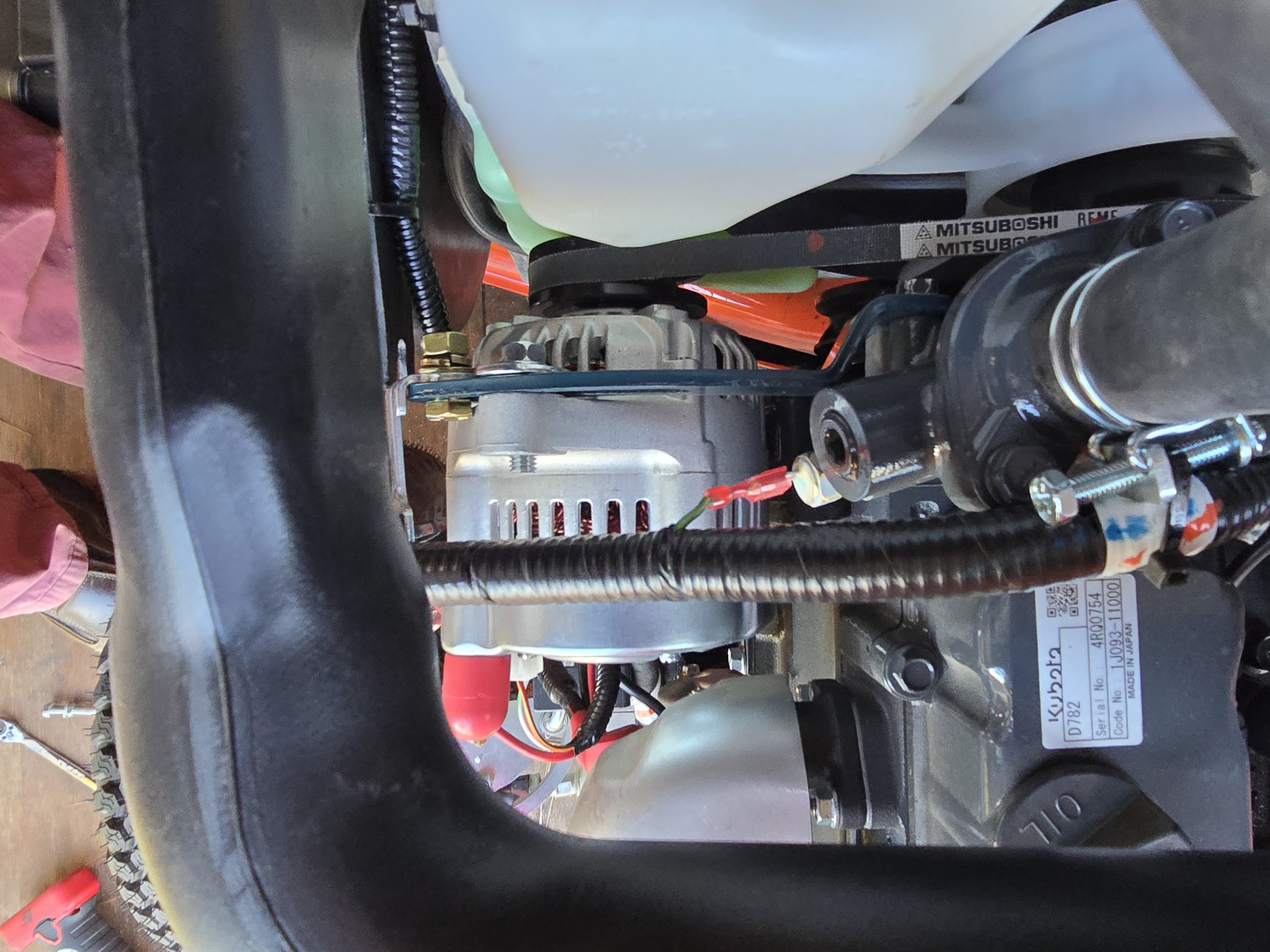

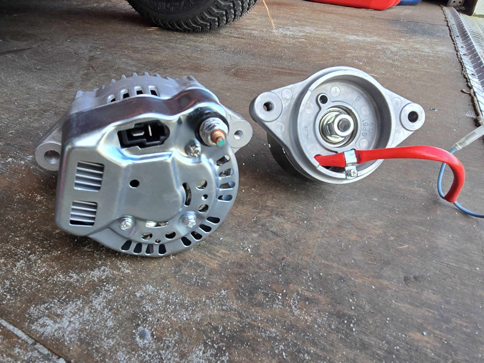

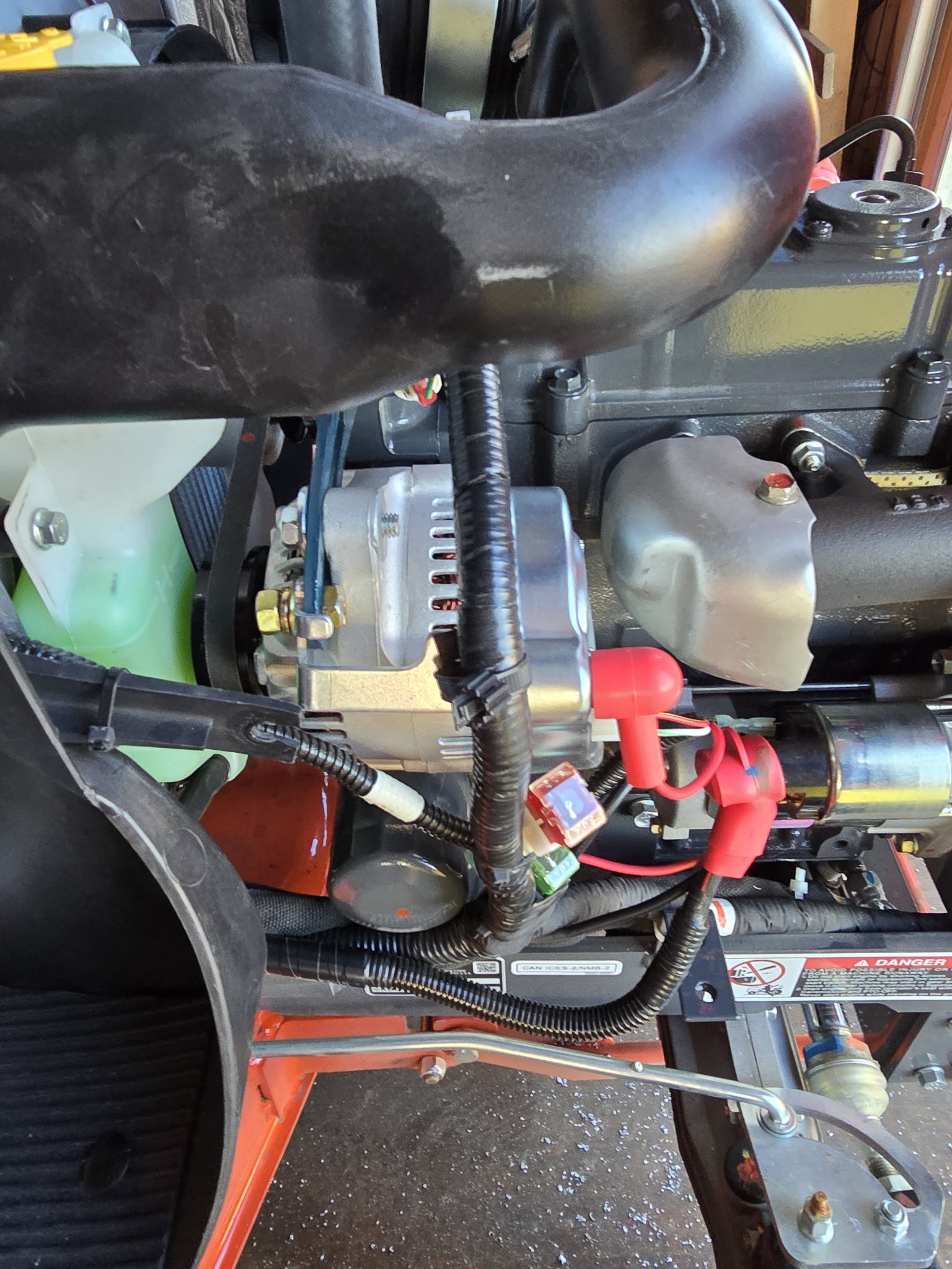

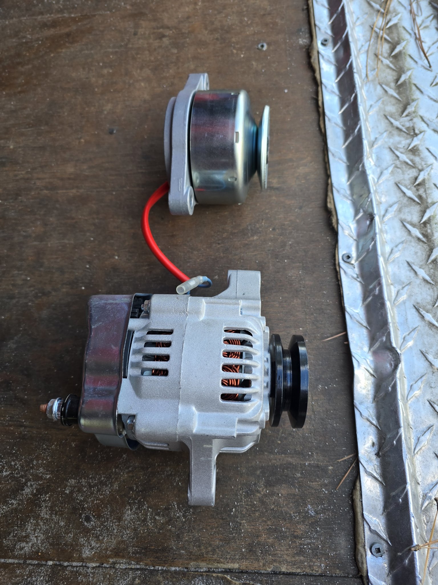

Put an Alternator on my GR2120

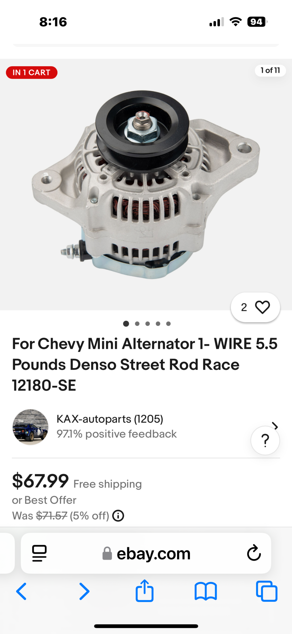

Should work out well. I use the small denso 1 wire alternator on many different applications. Easy to make brackets . No extra wires. The price cant be beat at 58-69 bucks my cost. 35 amp i believe on ones i use. Nice work…

Where have you been purchasing them that inexpensively? I need to replace the one on my Lister Petter Satandby generator

Try on ebay. Many others sell them. Dont go to popular tractor parts places i see they more than double prices .My supplier wont sell to individuals.

bet the OEM dynamo is maybe 10-14 amps(based on wire size....)
that alternator is good for 3x that !
I use scrapped car CS-130 series alternators for 4 previous tractors, price was FREE.....
still have a spare on the shelf ,somewhere....
that alternator is good for 3x that!
Aux lighting port out back is good for 30A, plus the headlights and glow plugs, fuel pump, and other stuff lead me to think it can power more than 15A, what's the main fuse rated at?

Finally found the spec.... yeesh stuff like this should be easier to find.
14 amps for the OEM dynamo. which makes sense when you eyeball the size of the 2 blue wires....
Can't believe the Aux skt is fused for 30 amps, will try to find the wiring diagram for that curiosity !
I've done similar upgrades, heck it was faster to do one, than design/build a proper 'generator testing station'.
15 amp rect/reg units do NOT like to be 'maxxed out' . Normal operating for that machine might be say 8 amps ? Add on some high power LEDs for dusk to dawn mowing, stereo, etc. and .... r/r goes poof.\
...time passes ( coffee slowly brewing...)
OK, found a GR2100 'series' WSM
points of interest
1) main fuse slow blow 40 amp
2) NO fuse between regulator and battery
3) IG/M is 10 amp fuse ( so operating current < 10 amps )
4) replacement dynamo about $120
5) replacement regulator about $50

I did it so it would have the same type of alt. as my bx and I plan to add lights to it. My experience has been a true alt is a lot easier on your battery too. I found this alt. cheaper than what that dynameter cost from Kubota if I had to buy a replacement. This is not a just a lawnmower. Show me any other Lawnmower with a 3 cyl. water cooled diesel engine on it.
