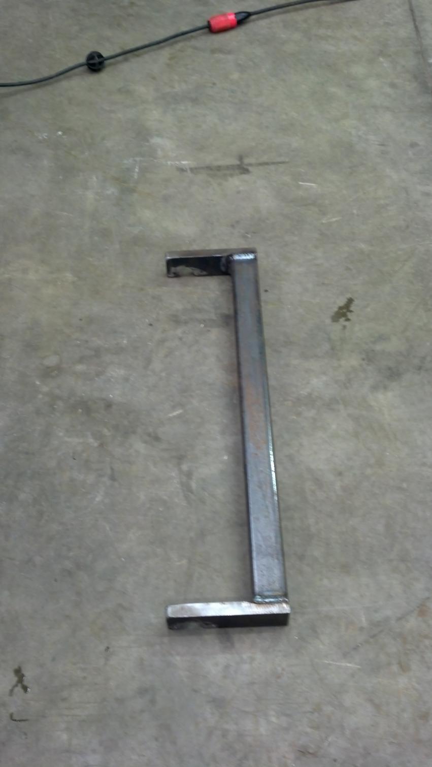

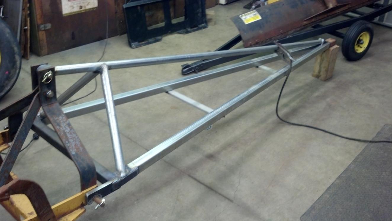

Decided we needed a pull type box scraper, to level the drive way.
Bought a 4.5' King Kutter brand BB for my B2150.
Brought it in the shop and started Welding up a tongue for it.
The tongue will be detachable and the wheels won't be, but they will raise up enough not to be in the way to continue to use it as a BB

Ahh,,,not to sound to stupid,, but what are you going to drag this with?? You have a tractor with a 3 pt,yes?
bulldog_shotgun
B2150HST
Feb 3, 2013
59
SW, Ohio
Yes but a 3pt BB just moves the dips and high spots. the long tongue will allow the tractor to go over bumps and through dips without changing the grading height of the blade. i have used an 18ft pull type behind a large JD for grading in the past. it is amazing how level they can get a piece of ground in one pass. i built a 3pt 2" reciever awhile back and will actually pull it with that. so i can adjust tongue height as well for finer control.

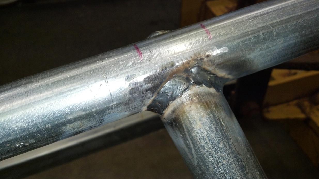

Good looking welds.
I never thought about offsetting the blade behind like you are doing; that's clever.

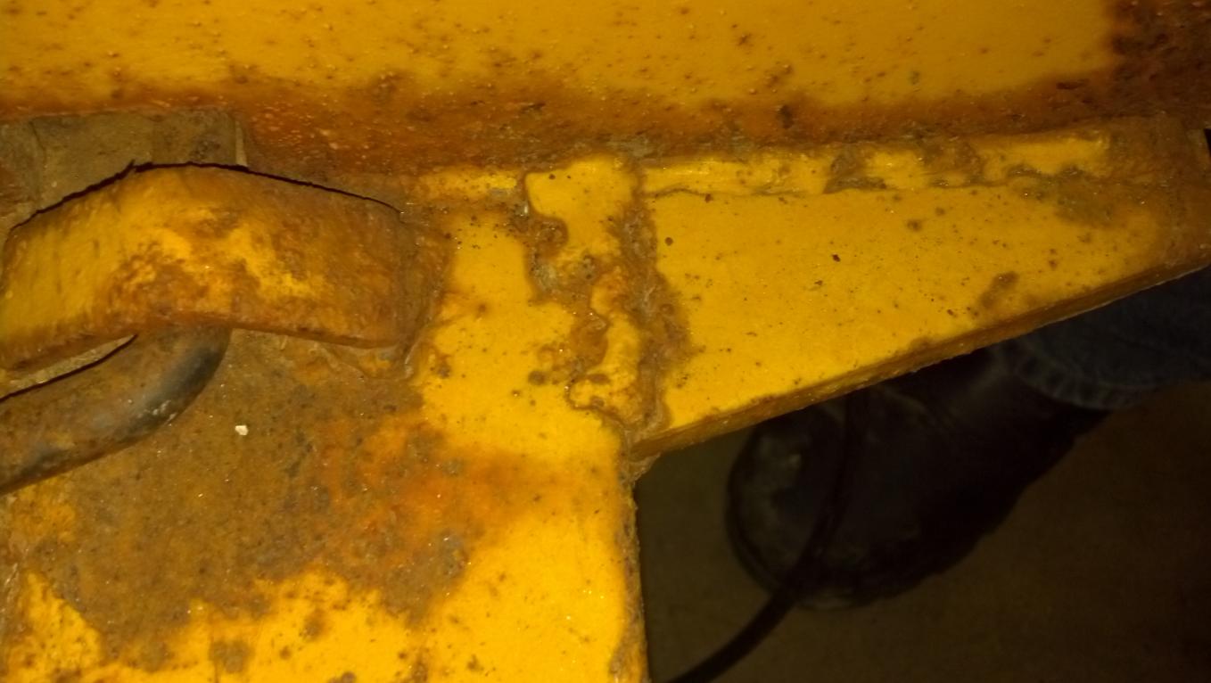

Thanks, there not perfect, but there better than the welds on this BB. i think drunk Ivan musta welded it on his first day on the job, heres a couple comparison pics. I passed a 2F GMAW test for a job interview a few years ago. my welds would look better with better prep since i'm welding galvanized here, but i was being lazy.

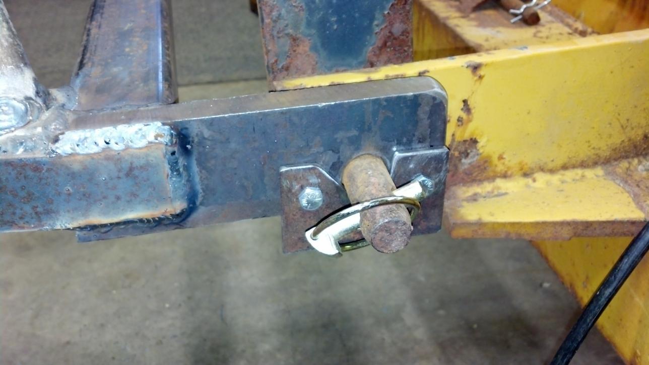

How does the tongue frame fit over the lower pins on the box blade? I can't tell from the pics.
I attached a pic, there is a 3/4 plate with a 7/8"'s notch cut in it. Then there are 1/4" plates with a notch cut in them swivel up and pin on.

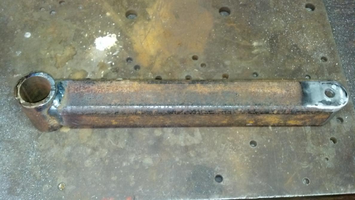

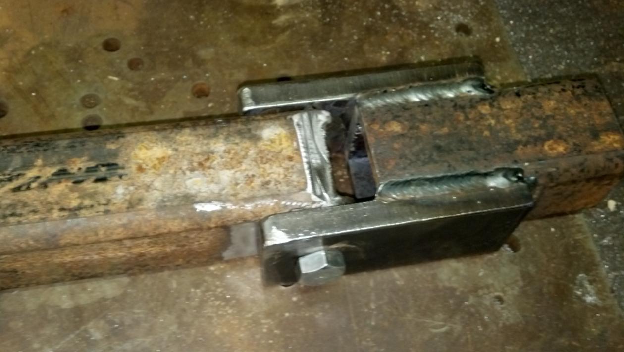

I got some more work done tonight. finished the hitch, and started on the wheels.
there will be one cylinder to raise and lower both wheels together, and a seperate cylinder to just raise and lower the left wheel an additional 3" each way, for making a crown etc.
waiting on my spindles and wheels now.
