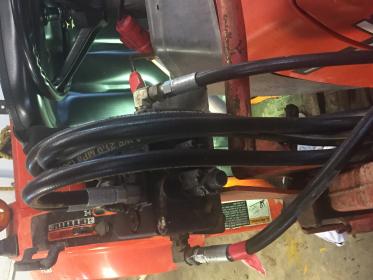

It has a filter screen on each side witch have been cleaned,I also wondered about the inside of the screens because you cannot see in them,it has one screw on filter on left side of tractor if your setting on tractor for the 303 this is the only time it has been it,I'm going to drain it out,just trying to find the problem,wolfman I will get some pic,of the fel lines may be a few days I'm not where the tractor is now ,thanks for you help

Is there only the 2 lines off of the valve (Besides the 4 loader lines)?

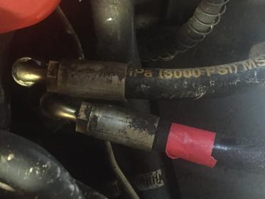

Wolfman my son took the pic,two lines comes out of Hyd block on tractor the red tape marks one line where they are hooked up,I drained all the 303 out got s udt to put back in cleaned the screens ,I can see the coil spring inside the screen they look clean but who knows,I forgot to tell about two weeks ago the box for the joy stick on fel was so hot it would about burn your hand,and another question how to get knob off of pto adjuster front of seat I can't get to move is it threaded or splined ,and the screen in front of radiator has been cleaned

If there is only 2 lines you have a FEL spool valve that is;
1: not plumbed properly
or
2: not the right spool valve for the tractor.
There should be a third line called the tank line.

Hydraulic fluid will heat up as it is worked and pressurized. But an open centre valve should have a constant supply of fresh fluid flowing through it, keeping it close to the temperature of the oil in the tank.
As Wolfman points out, there should be a third line. I wonder if someone has plugged the Power Beyond port and ran the Tank port back to the hydraulic block. If that was the case, then the fluid would be under constant high pressure against the relief valve when the controls are in neutral. That might explain the high temperatures at the control valve.
Is this a Kubota FEL and control? Or aftermarket?

I think Wolfman has hit the proverbial nail on its head. It sounds like the previous owner (all blame shall always fall upon the Previous Owner -- it's a cardinal rule of the internet :D) did not correctly understand how an open centre system works.
I would start by identifying the control valve set -- try and determine the make and model and then do some research to see if it has "Power Beyond" capability, if it needs a special adapter to convert to PB function, etc. Then obtain said adapter and re-plumb things correctly. IE: leave the supply line from the hydraulic block as is, plumb the PB port back to the hydraulic block and add the third line from the Tank port to the tank.
I can't guarantee that will solve your puking dipstick issue, but I'm pretty sure it will extend the life of your fluid and probably save you from future damage to components.

Your tractor is the first version of that model, it has 2 filter screens that are the same, and one HST spin on filter.
I'm pretty sure your foam issue is the FEL spool valve or the FEL spool valve piping.
