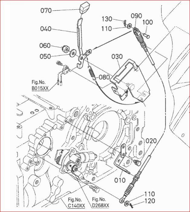

Here is what your looking at:
Something still is not right......
D268xx needs to move either cw or ccw......which way is it in the picture?
Is it engaged or not? pulling on the cable takes a linear motion and converts it into rotary motion, so either the cw/ccw is backwards ....or?
looking at the picture - looking at the safety switch - is it engaged or disengaged as the pto is placed into motion?
so my question - how could it be backwards? unless the cable is routed to pull rather than push ?????
11,057
2,974
Which side of the tractor are we looking from? I'm assuming the left side is the front and the right the rear of the tractor.
ON this tractor......what hand is used to throw the lever? Left or right?
34,839
10,129
on part 030 (two slots) --where is the on position - forward or back? Towards the switch or away from the switch?
