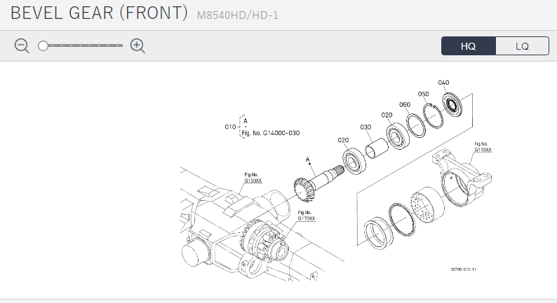

To remove the axle:
Support front tractor frame.
Remove the 2 steering hoses.
Pull these eight bolts and nuts.
Pinion is easy:
Pull the seal and the snap ring and pull the pinion out.
If your still troubleshooting, you can pull the pinion and see the ring gear to inspect for damage.
Now pulling the ring well that's involved.
You'll need to pull the RH geaar case
Then you will pull the axle and differential out that side and replace ring.

I just replaced the pinion on a couple of these tractors. Kubota sells a kit with a new shaft and pinion. You don't have to replace the ring gear as a set like you do with most tractors. Have you checked oil levels in the front axle? Or you using gear oil?
