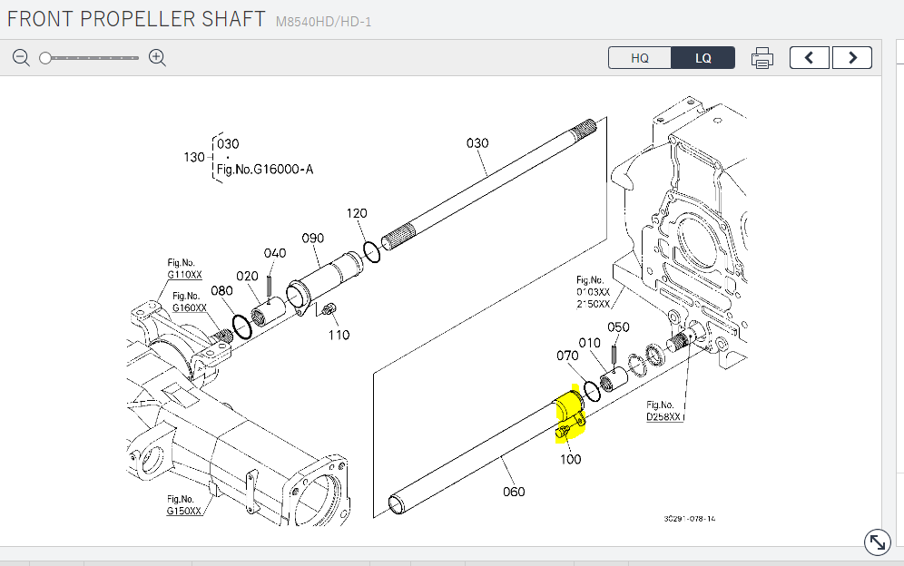

Bottom line, I see what you are doing and am trying to figure out a solution. I'm thinking driveshaft - shield misalignment, but pictures would help.
The inside of the front coupler looks exactly like the photo in video #8..could the problem be I only replaced the damaged one going into the front shaft as the rear coupler did not show any damage leaned and greased both couplers and splines on the shaft

Check the rear connection of the the propeller shaft cover.
If nothing looks off, pull the covers off and see if there is still a noise.
36,316
11,157
The two cover tubes slide inside each other, and if they won't then there is probably where your noise is coming from.
No it is the coupling.
Tried to drop the shaft to try and align the 2 screws thinking it might be a balance issue now can not get the shaft out the back coupling is free but the front one will not move
With the roll pin out you can tap the coupling on the side to get it to move.
It's sounding like it might have tried to spin it in the splines.
You can remove the rear coupling and pull the shaft out that way.

Tried both there is not enough room to pull the shaft removed both roll pins tried prying with large screwdrivers coupling on on the pinion gear will not move enough to release the shaft
36,316
11,157
Sounds like you've twisted the coupling on the shaft, you can try and use a pipe wrench to turn the propeller shaft to just the coupling loose.
If you can't then things get interesting, like removing the front axle interesting.

Do you have a schematic of the pinion assembly and the 2 bushings .mounting brackets that secure case to tractor.
