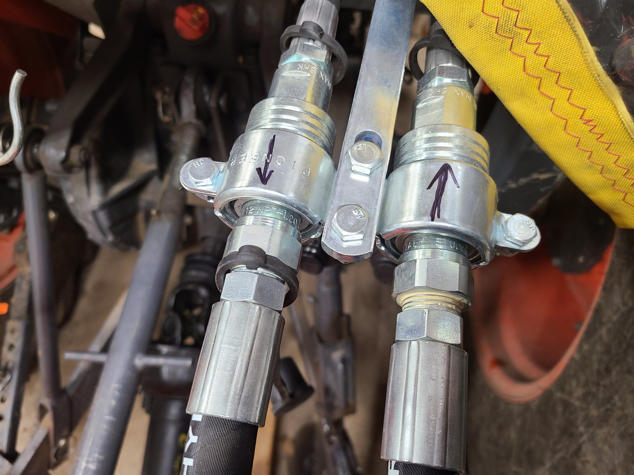

Please confirm on my third photo: are you saying that the Orange Hose is the Power Beyond Port? (This is "Port B" shown in the manual on photo #1).
Thanks

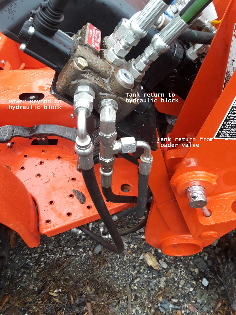

The port on the loader valve labeled BY is the power beyond port. That hose should be moved to the T port on the 3rd function. A new hose should be used to connect the BY port on the loader valve to the P port on the third function.

As shown in the document I linked, the third function valve should be after the loader valve. As Wolfman shows in his diagram, the hose that used to go to the C port from the loader valve should go into the 3rd function P port and a hose run from the 3rd function T port should go to the C port.

Ok, so I just ran a test with no hose ends in the existing configuration. I had fluid flowing through 1 hose. In The attached photo the "out" arrow pumped fluid no problem.
I then swapped the hoses on the 3rd function kit and basically I had the same result but the fluid came from the opposite hose. I assume this makes sense because you can't have fluid flow from both hoses until the system is a closed loop and full of liquid (right?).

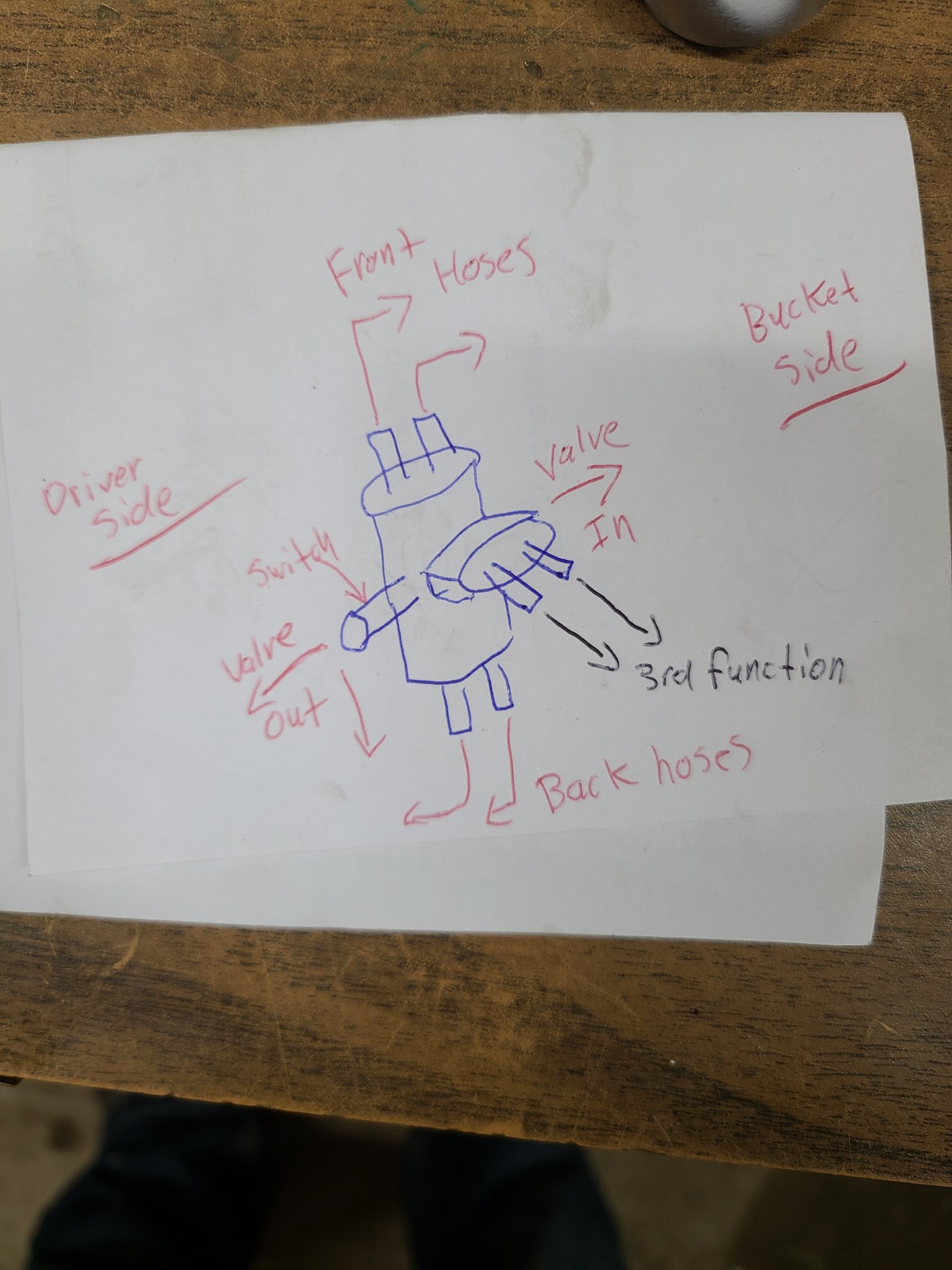

Here is a sketch of the switch valve operations and set up.

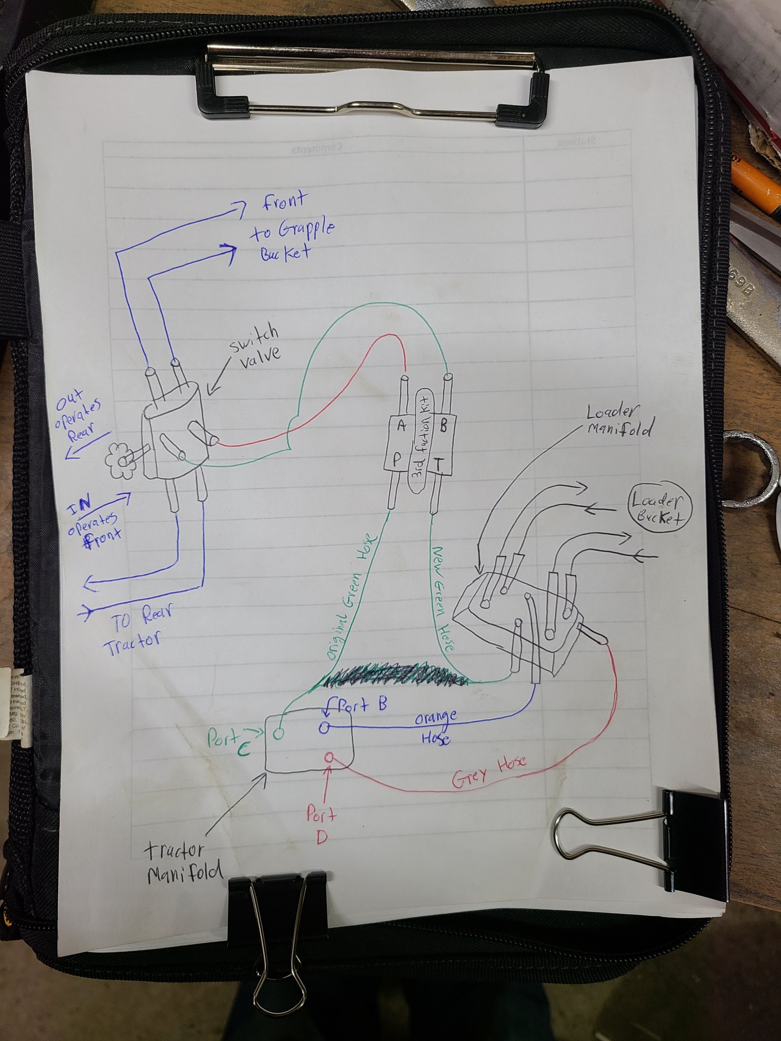

Here is a full sketch of the full hydraulic system. Let me knownif you need more information. I can get you whatever you need.

Here is a sketch of the switch valve operations and set up. View attachment 74681
OK - it appears you want to use the selector to switch the 3rd function valve between the grapple cylinders and the rear outlets. That is fine.
The lines going to the third function should be connected to the cylinder ports .
The lines labeled front hoses should be connected to the grapple cylinders.
The lines labeled back hoses shoudl be connected to the motor ports
Is that how you have it plumbed and are you 100% POSITIVE you have the third function work ports connected to the source ports on the selector valve?
If so you when the spool on the selector valve spool is moved to select the rear outlets you should; get flow out of one one rear hose when you press one of the joystick buttons and flow out of the other rear hose when you push the other button. When the spool is moved to the other position pressing one button should open the grapple and pressing the other should close it.

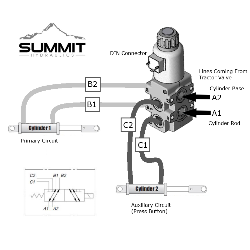

Edit: Just saw your sketch. If the valve does not operate as I described in the previous paragraph you have the ports on the selector valve mixed up. Here is what I would expect the porting to look like. You appear to have A and C reversed.
