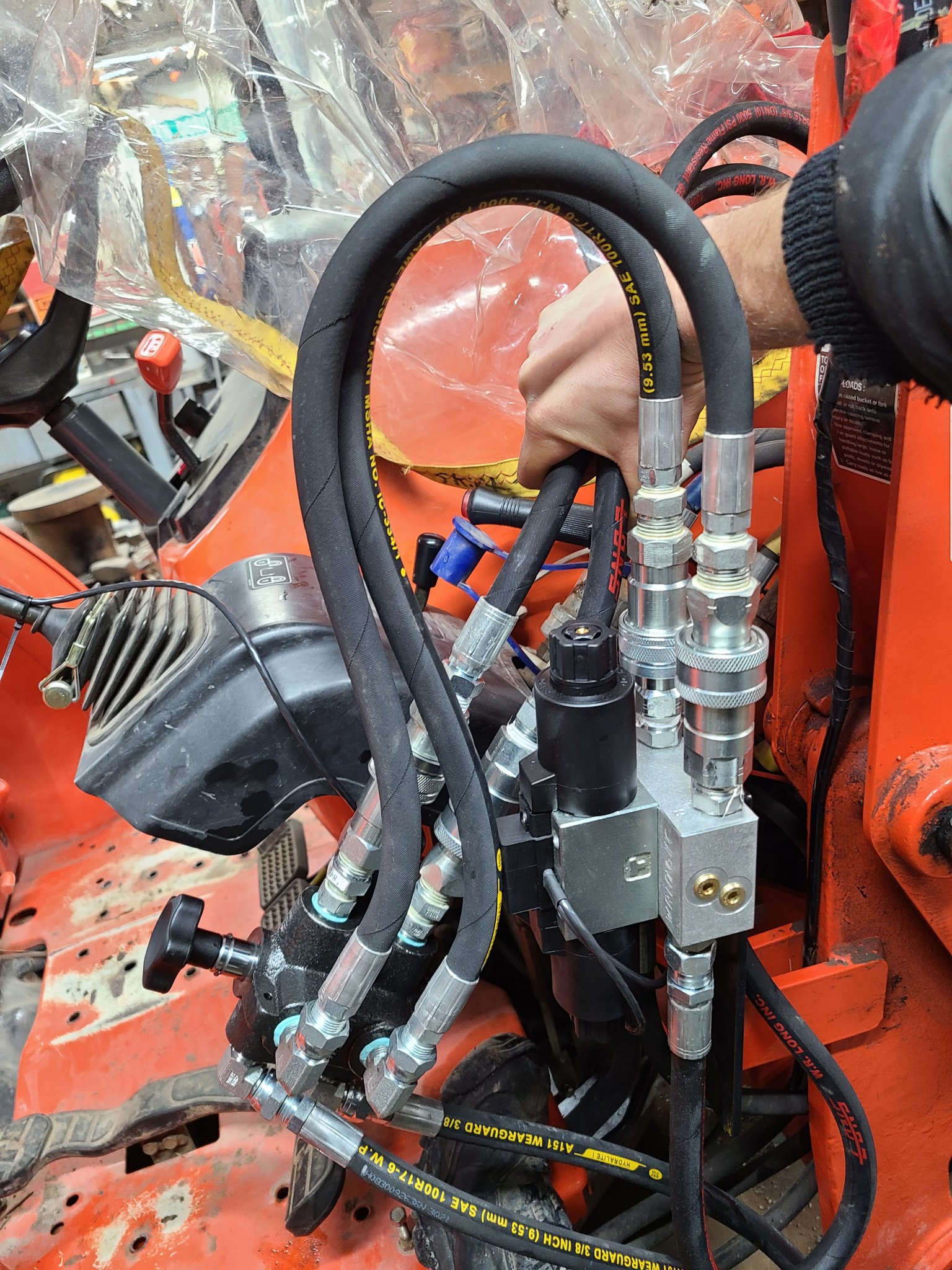

Here is a photo of the selector valve and 3rd function valve.
The 2 hoses I am holding go to the grapple bucket. The 2 hoses in front of my boot go to the rear snow blower.

I removed the switch valve entirely from the sequence and the fluid still only comes from one hose. I am starting to think my 3rd function kit is faulty.

The 2 hoses I am holding go to the grapple bucket. The 2 hoses in front of my boot go to the rear snow blower. View attachment 74683
I believe you have the hoses coming from the quick connects on the 3rd function valve going to the wrong set of ports on the selector valve. They need to go to one of the end sets but I can't tell you which end. Consult the documentation you got with the selector valve, One end is for the hoses coming from the directional control valve and the other end is for one of the cylinders. The other cylinder gos to ports on the top center of the valve.
I just looked at a data sheet for a Metro selector and it is ported as you have it plumbed. If you are only getting fluid out of one of the hoses coming from the 3rd function valve I would suspect one of the quick connects is not working. Reseat them and if that does not fix things remove them from the ends of the hose and recheck 3rd function operation.

Eureka!
I have it figured out! Test the solenoids on the 3rd function kit. Only one was getting power. Traced it back to the wiring in the button on the handle. The yellow and green wires were crossed.
Fluid now flows from all hose in both directions. Now to test with a new bi-directional pump.
