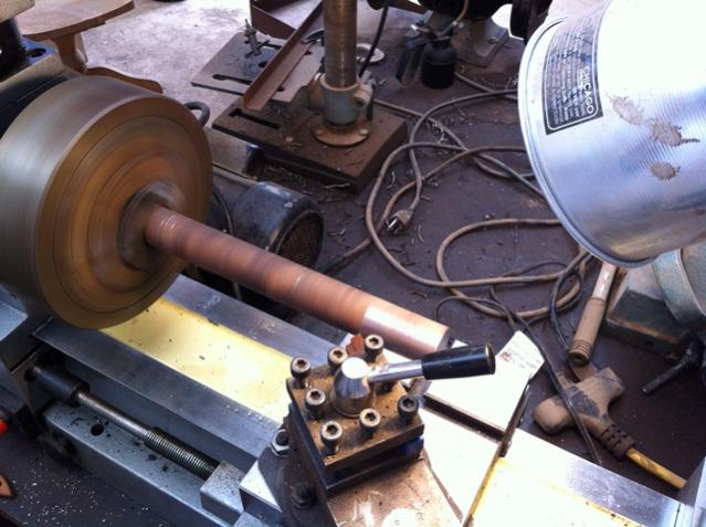

My low cost solution is going to be to remove the pin between the PHD gearbox and connecting arm (see attached images). I'm going to machine a shaft which will extend on either side of the gearbox. These extensions will allow a hanger to be placed on each side upon which I'll load plate weights. The calculations show that the gearbox will likely fail before the shaft is bent. Excellent.
I'm working on the shaft now. Will post back when hangers are done and installed on PHD.

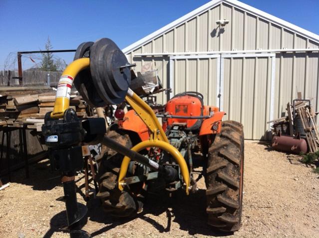

Now with more down force,... but not results I'm looking for
Change of plans.
While I was sizing up the PHD, and frothing at the mouth over the challenge, I observed a 3/4" hole in the structure at the top of the arch. As this is a new PHD, clearly a factory added hole. No sense in debating, I pushed a 3/4" steel rod through the hole, loaded it with 210 lbs., and off I went.
As noted in an earlier post, the increased down force does seem to diminish the tractor's ability to pull it up out of the hole, especially when loaded up.
I ran it into a few previously started holes with such great expectations. All dashed. Even with added weight, the auger just can't break through that layer of clay. But on the flip side, there were some soft holes where I struggled to control the rate of descent or else it would take off and seize.
Undaunted, my next option is to change the cutting edges. I will experiment with some different teeth and maybe reducing the added weight. I guess I've got to find that balance.
