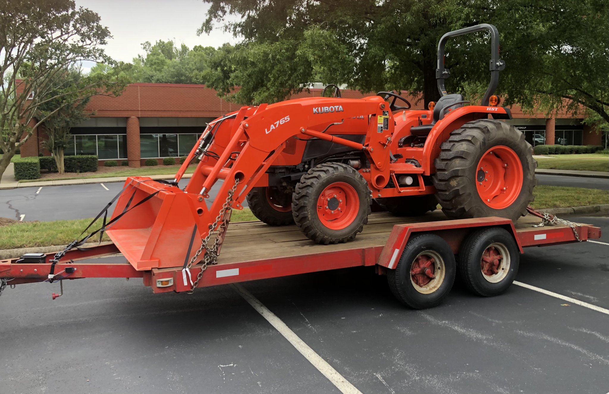

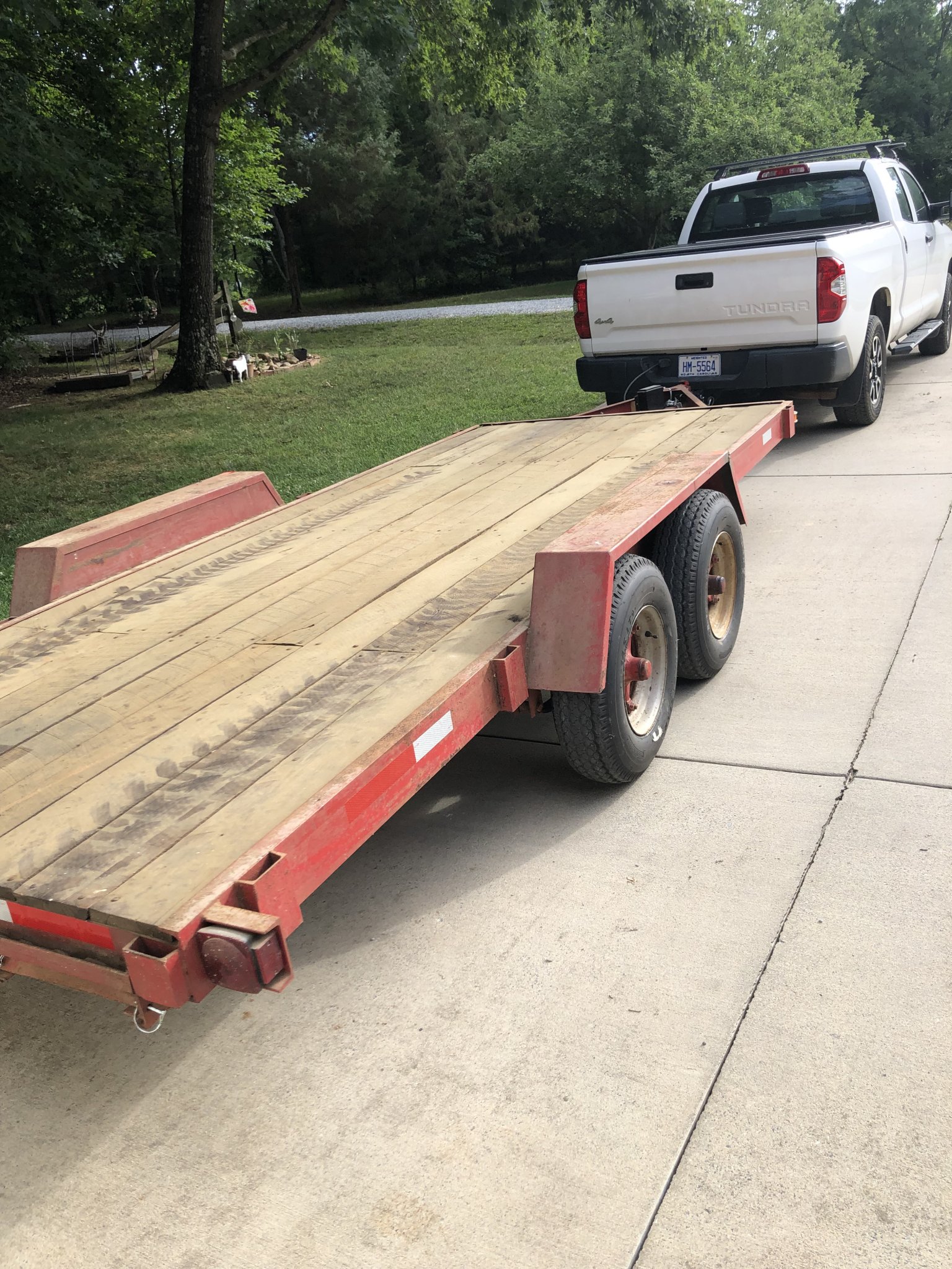

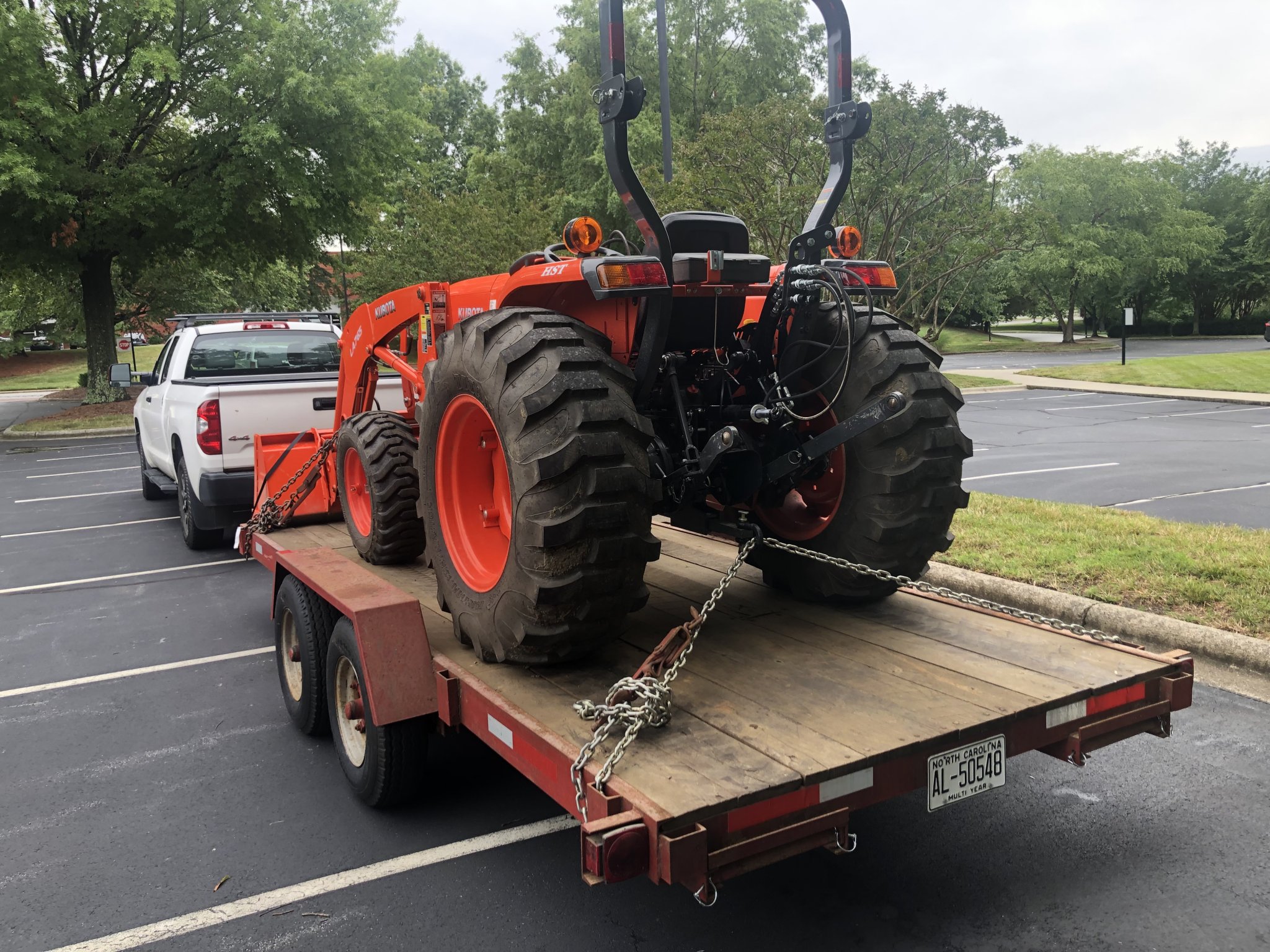

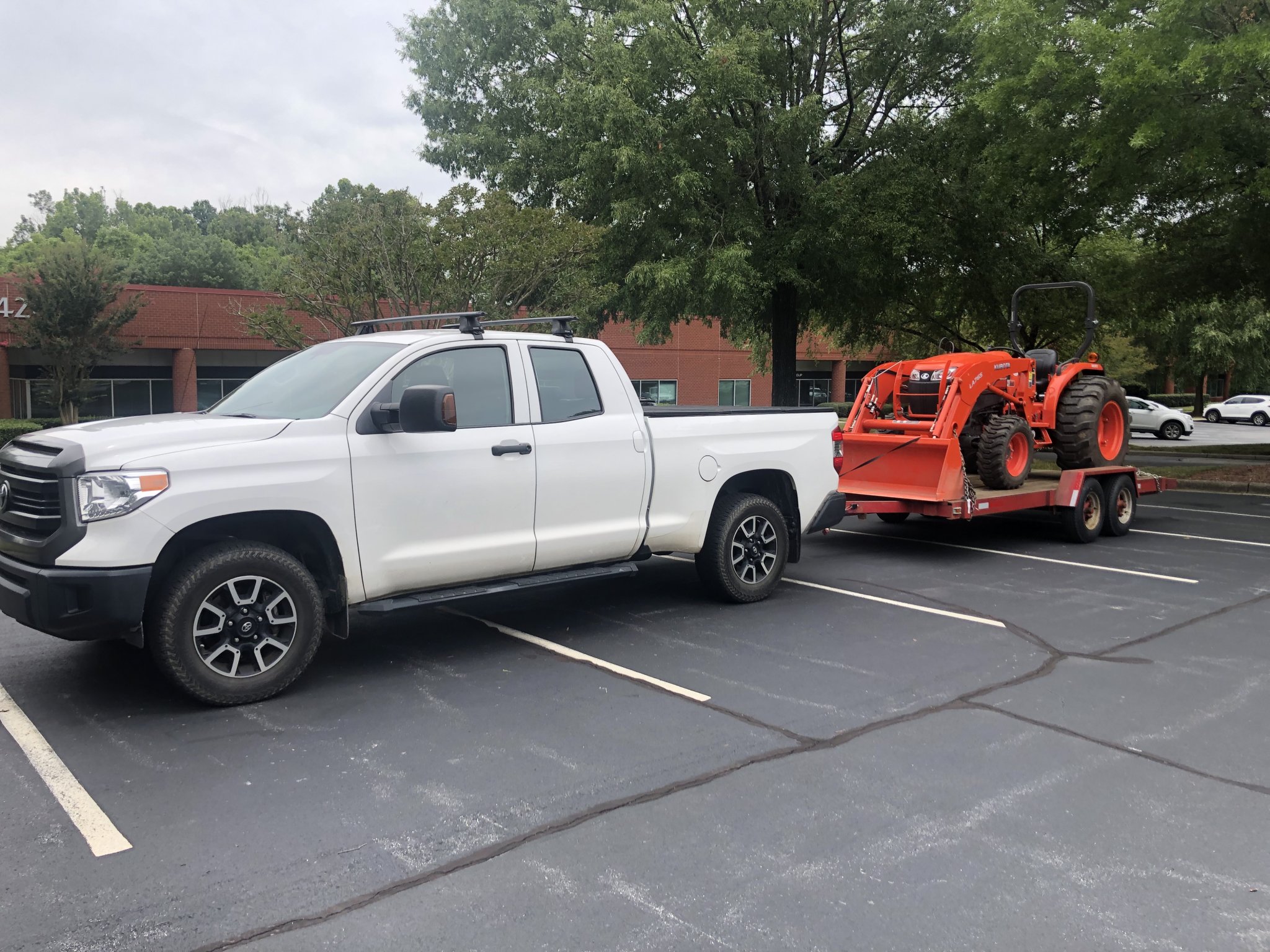

Hauled the tractor to the dealer a days ago with my Dad’s 40+ year old flatbed he gave me in exchange for my getting it to DOT spec roadworthy, fixing brakes, etc. and his retained right to use it whenever I’m not using it, which I rarely do. Slide in ramps are a PITA to use but as rarely as I use it, not a big deal on a trailer I’m $750 into. Was very pleased with its performance.
No problem with the tractor. Had them install rear remotes.
That trailer looks to be in great shape for 40+ years old. Cool tractor too.
View attachment 62483 View attachment 62486 View attachment 62487 View attachment 62488 View attachment 62489
Nice looking Tundra too.

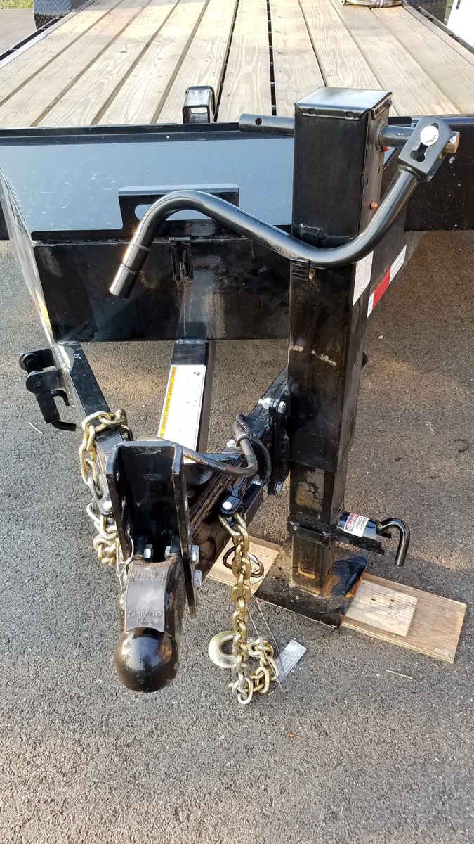

I tried to get the Curt weight distributing hitch installed today but it turned into a $hit show because the 7k lb jack is on the outside of the A frame and doesn't offer sufficient clearance for the trunnion bar. My PJ dump trailer has the jack inside the A frame so I'm going to move the jack to the inside and weld up both it and the hookup brackets to the frame.

@NCL4701, thanks for the excellent information. I'd love to be at the stage where I can think about the issues you mention but I'm still stuck on moving the 7k lb jack. I figured out that I need to "cock" the jack inside the A-frame so that the handle is free to rotate. If it's positioned orthogonally with the handle out to one side or out to the front it'll hit either the toolbox or the coupler mounting bracket. That means I need to build out some plate on the center tube to give me the angle and a mounting surface for the jack. I'll get there but it's been a pain thus far.

Hope you figure out something that isn’t too convoluted. I have a flip jack on the 5 ton; kind of a crappy pic because that’s not what I was trying to photo but it has a beam welded in the center of the A that runs straight from the hitch to the front of the deck. It’s just long enough to allow mounting of the rotating flip jack. You may notice it also has a plate right behind the hitch with a big round hole surrounded by little holes. That’s for mounting a fixed vertical jack like I have on the camper (other pic). Yeah it hangs down a bit but not as far as the weight distributing spring bars.

You can see that the jack is in the way. A hook up bracket needs to be added to the jack side of the frame opposite to the one I welded on the left side.

The drop foot and pin setup looks nice if you can keep it positioned and oriented such that it remains readily accessible. And wow, that’s a big jack for a bumper pull trailer.
Kind of a Chinese puzzle you got there. Longer I look at it the more of a PITA it looks like to move it. Sounds like you have it figured out, though with moving the bracket. 🙂

I think I've got it figured out. I'm going to notch the center tube (see cross-hatched region below), separate the jack from the mounting plate and weld it into the notch. I'll probably add a gusset at the rear of the jack and I like that the seam is on the side of the notch. The handle will easily clear the tool box and I'll have access to the foot and pin. This should work well.

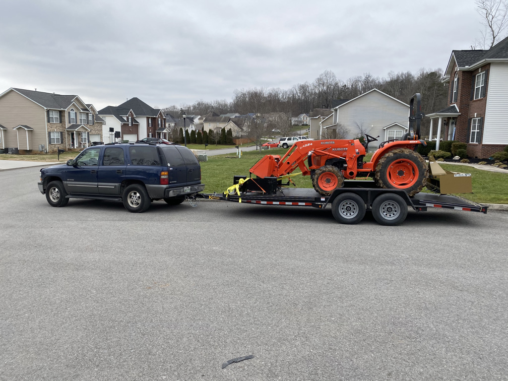

Here's my L3800, loader, and 5.5' box scraper on my 19' Kaufman trailer behind my 2000 Tahoe. Pulls pretty well, but I haven't had it on the interstate. Don't really intend to as I only move it between Knoxville and Oliver Springs (about 30 miles or so) once in a while.

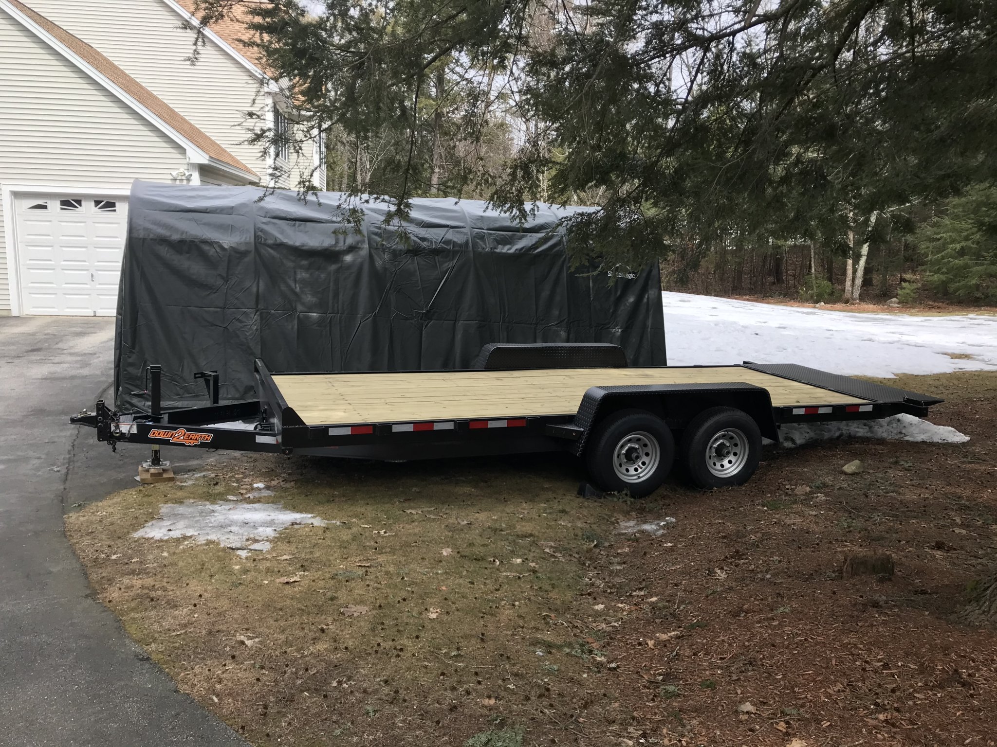

Thanks for the help ended up getting a 20’ gravity tilt deck haven’t bought the grapple yet ... still deciding on what type View attachment 56458
