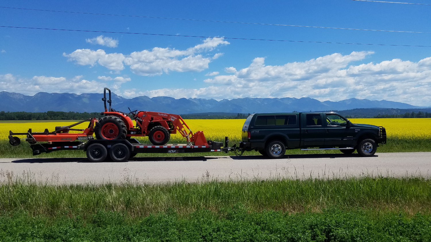

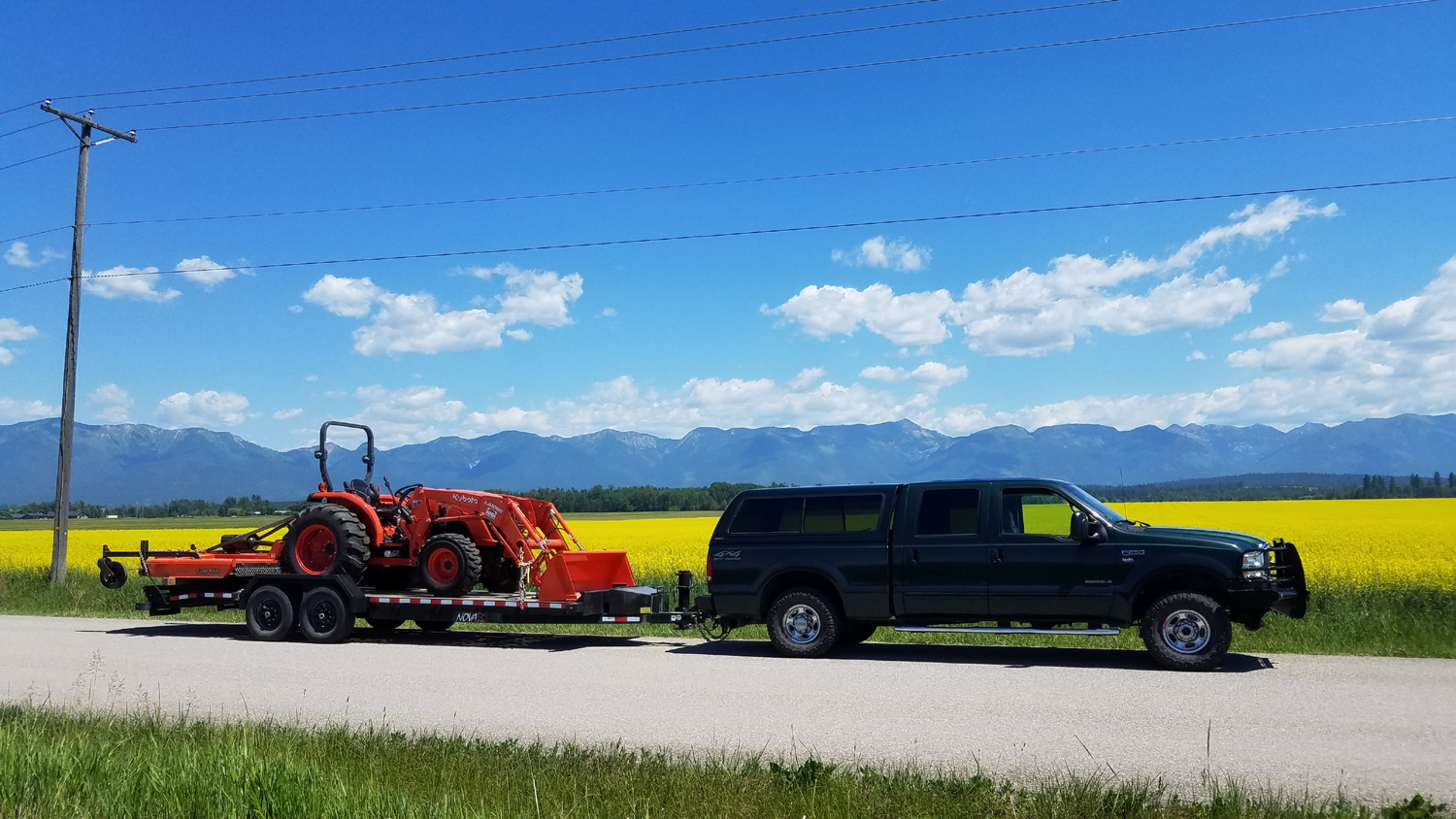

Another tractor/trailer shot coming home this afternoon after finishing up at my friend's place. I think there's too much weight on the tongue and if I didn't have the RCR1884 on the back I would have moved the MX rearward a bit.

Looking at your setup, heavy duty brushguard on front of the truck, yet the trailer tongue weight has your truck down on the overloads I bet. You might consider air bagging the rear axle or weight distribution hitch. Or you could detach the loader for weight savings. My guess is your total pull package is approx 11K in the pic.

Thanks for the link to the video. It was very informative, and the testing clearly showed that a weight distribution hitch would make a significant improvement. Air bags might be nice to have as well but they don't seem to be as helpful when it comes to towing heavy loads. I'll have to do some research.
I have a DPTuner programmer and chip but plan on doing a bunch more upgrades to my truck such as single shot injectors, an upgraded turbo, upgraded HPOP, fuel system, upgraded "bullet proof" transmission etc. I'd like to be able to pull the trailer shown and get up to speed much quicker.

The purpose of a weight distribution system is to move some of the tongue weight to the front axle, that improves steering and therefore safety. In addition, a bit of tongue weight is also transferred to the trailer axles. Air bags are simply additional springs and are needed only if sag is too much after hitching, whether you use a weight distribution or not.

I ordered a Curt 15k weight distribution hitch with sway control this morning along with a 2-1/2" replacement shank and an extra set of hookup brackets for the PJ dump trailer. It's highly unlikely that everything will simply bolt up but I have the tools and ability to modify any parts that aren't plug and play. Thanks very much for the suggestions.

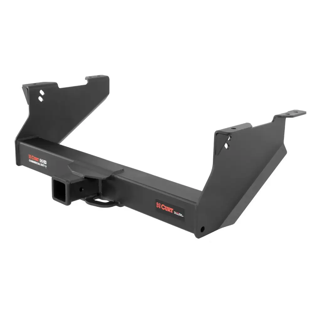

You are welcome sir. I went with a Curt class V hitch and air bagged rear for my Cummins Ram 3500 SRW. Got to concerned the cheap factory bumper beam hitch was junk.

I have a Titan Class V receiver bolted to the frame, and a Ranch Hand rear bumper that I could use for towing but don't.
