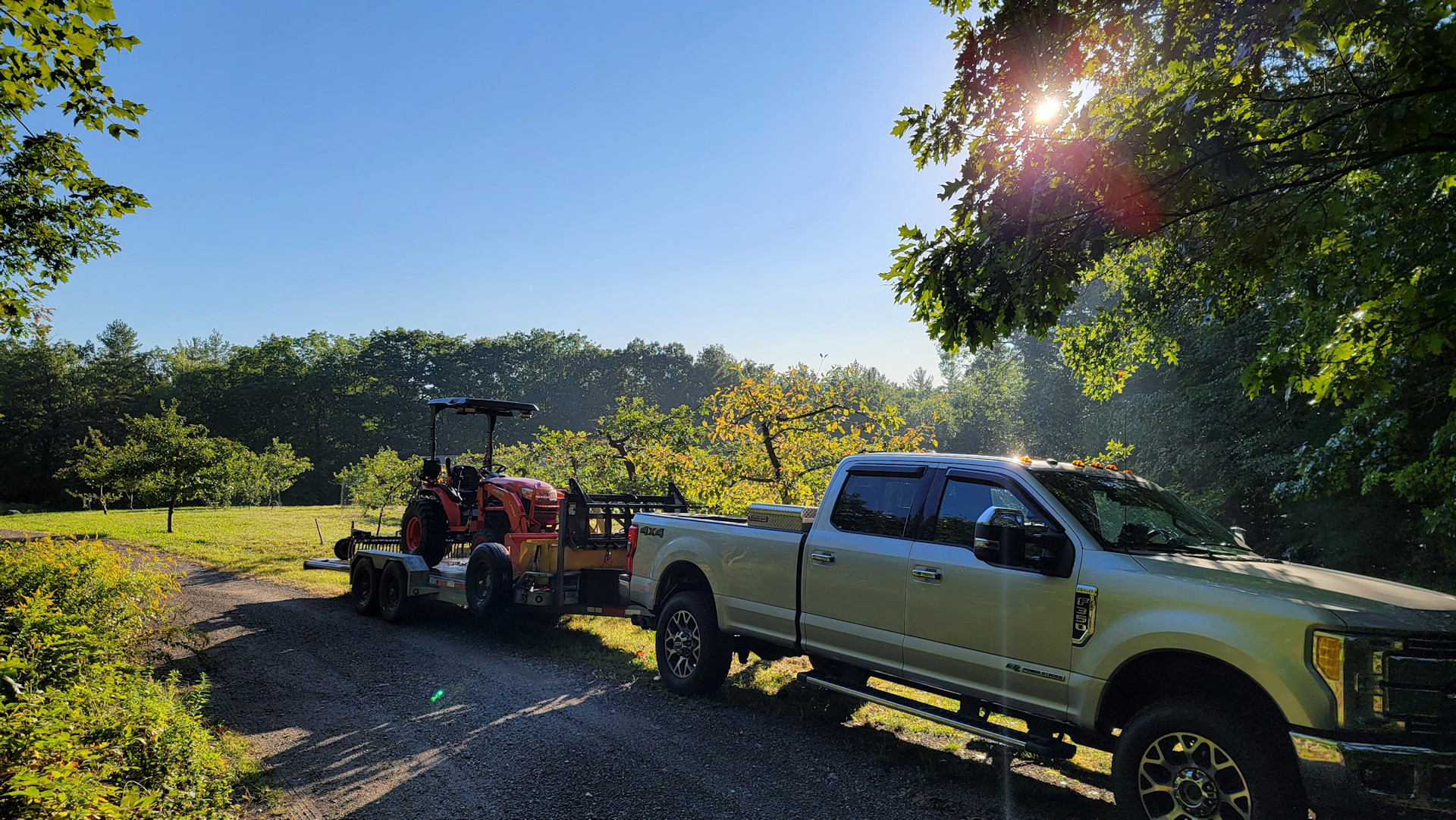

Sweet rig!
Never tried the wheel strap method. Still running 3/8” Grade 43 chains through shackle on drawbar on back and loader tube on front. Do you find the wheel strap method easier and/or better than chains and load binders?
Also, it looks like you’re using auto type straps on the fronts so that’s pretty straightforward.
What you doing for the rear? Looks like a standard strap that you’ve woven/wrapped around the wheel somehow. Have you found that to be reliable to not slip?
I tow a lot of cars and wheel straps are becoming the standard. The front are wheel straps for autos and the rear are just a strap wrapped around the back of the tire and crossed on the front. I do have to use 2 ratchets 1 won't tighten both ends of the strap. You can actually see the tire being squatted when you tighten them. OCD is part of the reason I started doing this. I didn't want to scratch my tractor. LOL

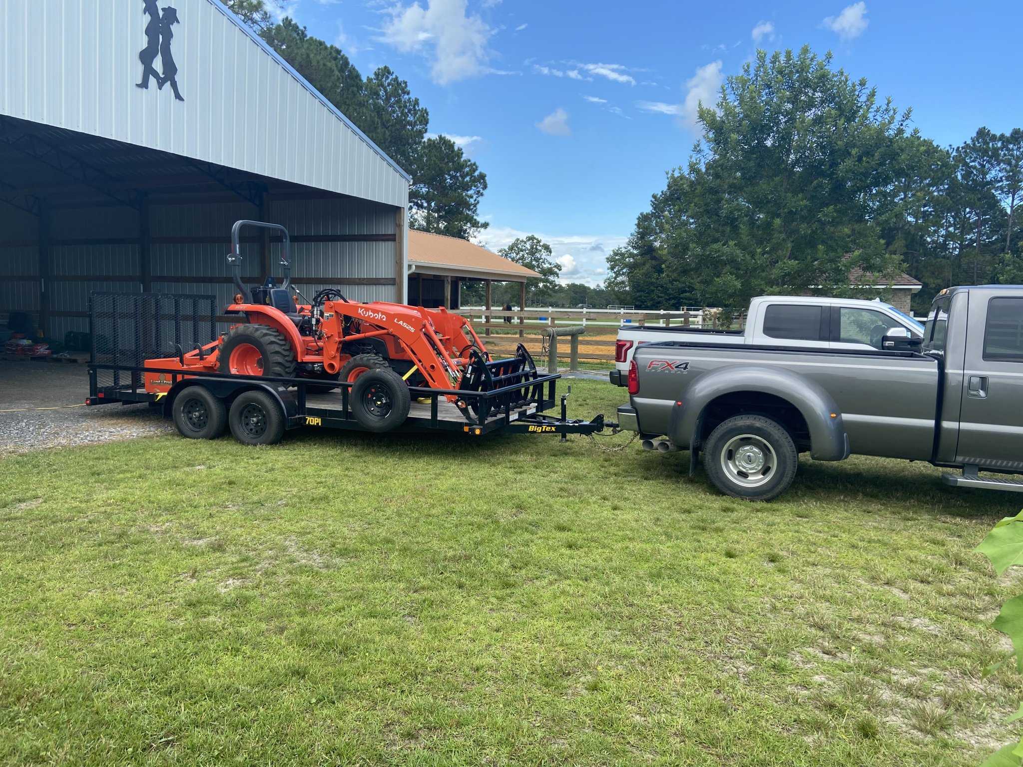

1100# tongue weight, total trailer and cargo here is 8100#.
Crash277
BX23S
Jan 17, 2021
844
621

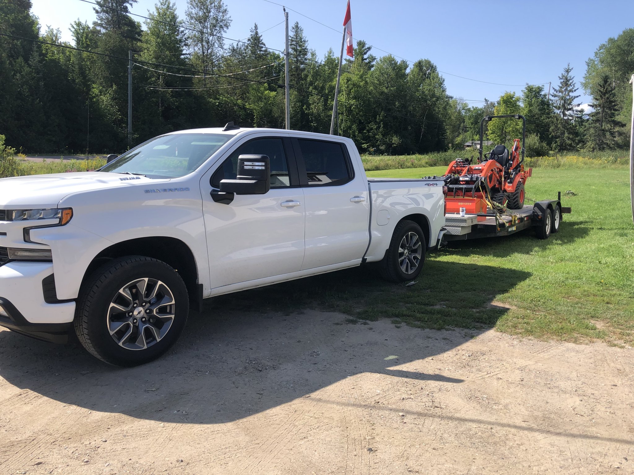

2021 Silverado with the 3.0L duramax, 2012/2013 18’ 7000lb car hauler. Did the math, with that set up I’m sitting at around 6-6200lbs. Max tow rating is 9300lbs. Side note: I will never again own a truck that doesn’t have tow mirrors. They are great!

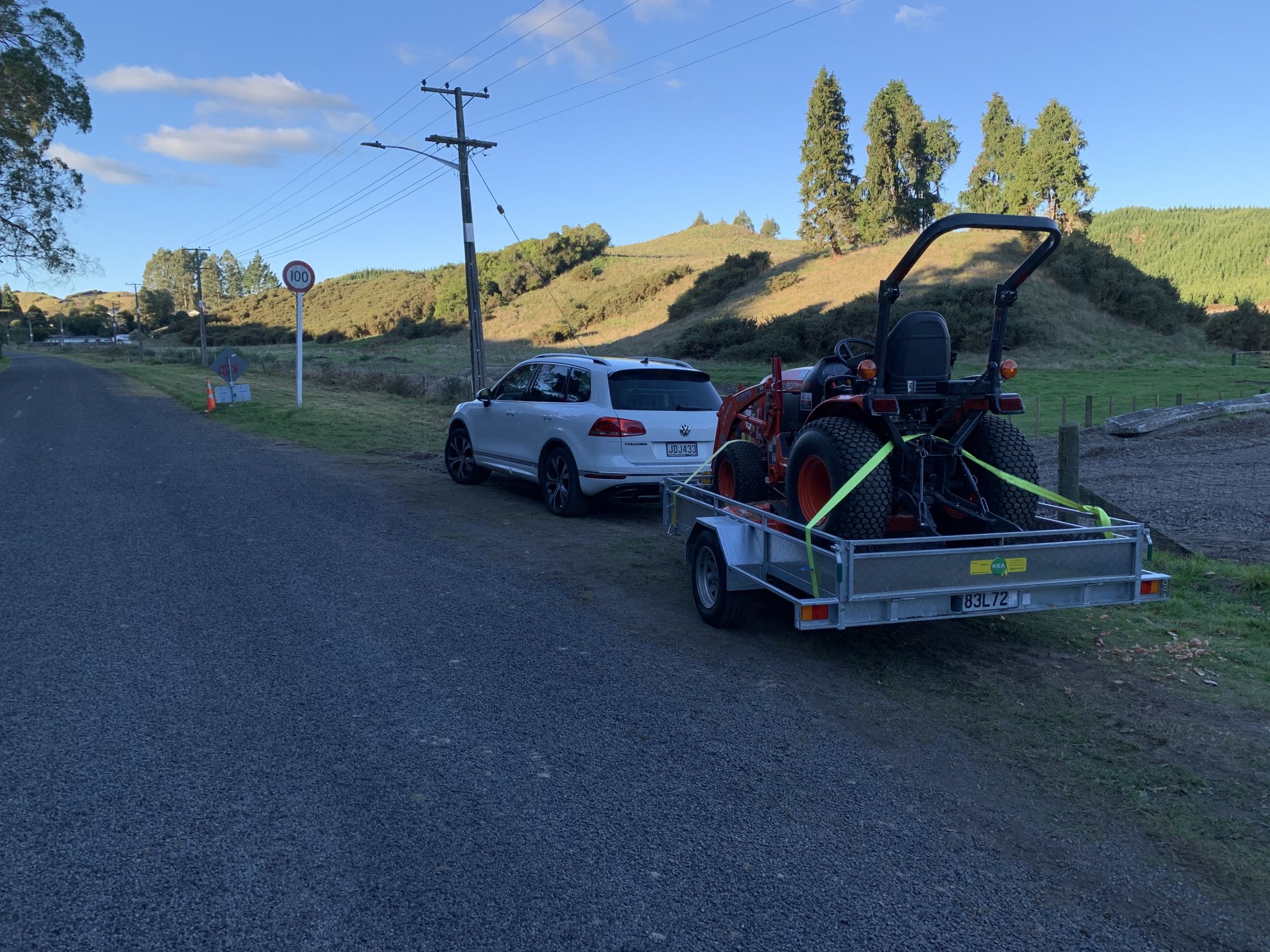

Going to mow the roadside a couple kms down the road.
I'm sure some will say that's not enough trailer. But by NZ standards it's a big trailer.....
I agree on tow mirrors! My F150 has the optional tow mirrors (not standard on tow or max tow packages) that telescope out 2" - these are basically the same mirror on the superduty's.
