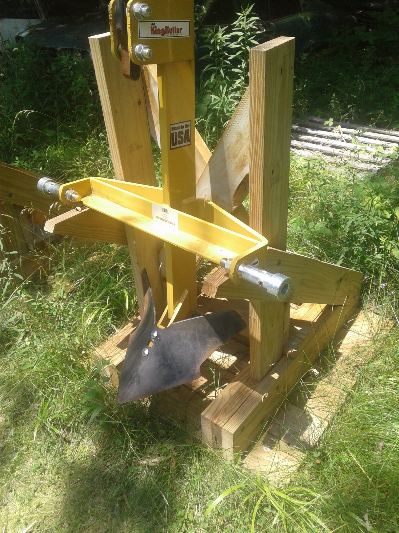

All 3 pins on the implement should be in the same vertical plane. Little or no adjustment of the top link necessary. The one exception is box blade (& land plane?) changing the top link determines if box blade scrapes up material, drags or transports it, spreads collected material.
The 3pt travels in an arc. If implements are connected/disconnected in the center of travel, no binding should occur (cured by adjusting top link). I'm old school implement shouldn't move when I back into it however, most of my stands could have casters attached.
If interested, some of my other stands can be found here
