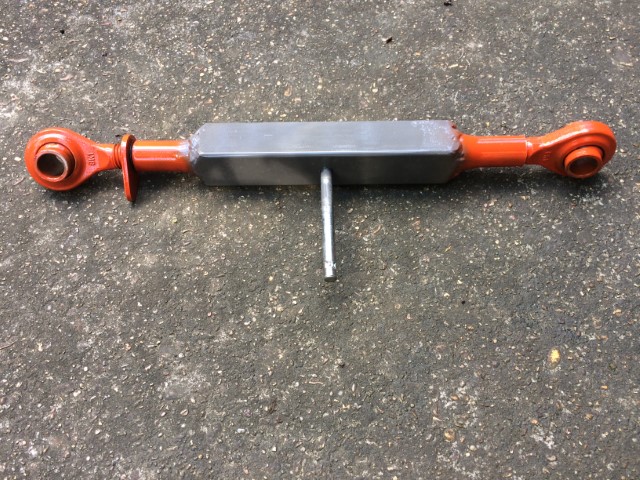

OK, I used the term sleeve but it is more properly called a bushing. LINK
Thanks, Magicman. So you are pointed out than an option instead of getting a longer Cat 1 toplink, get bushings and a Cat 2, which is already longer? How likely is it a more chunky Cat 2 toplink will be slightly too wide in a B series connection at the tractor?

I actually have 3 top links, all different and between them, something will fit.

You could use a cat 2 top link which is longer and then the bushings to adapt it down to the cat 1 pins.

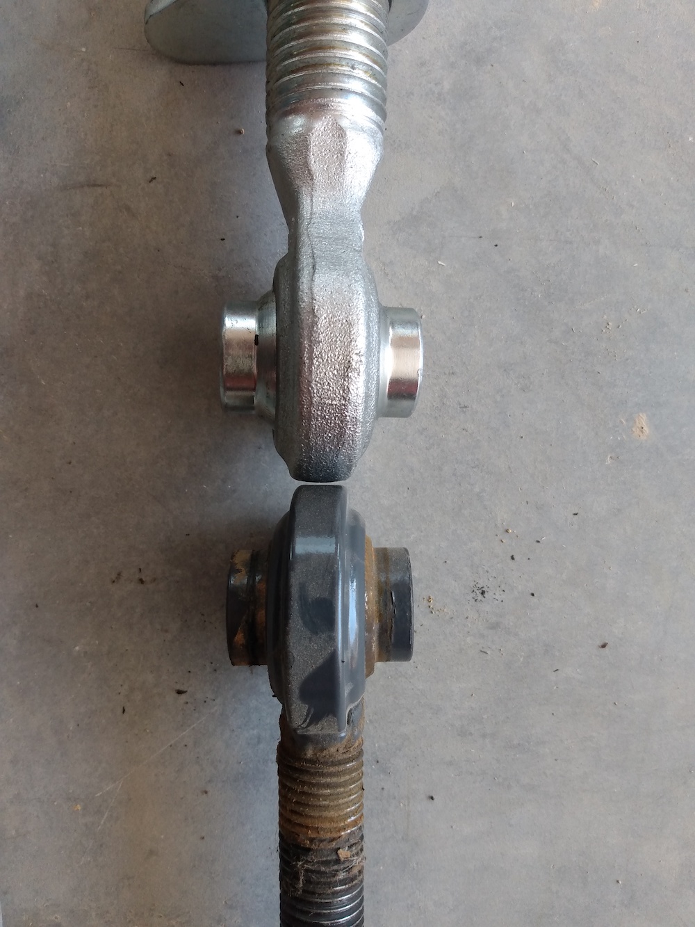

It's ALWAYS SOMETHING. Got the County Line Cat 1 extra long top link from Tractor Supply. Go to put it on the B2601 and it won't fit. Hard to tell in this picts but it is 2/16" wider than the stock top link that comes with the B2601 which fits snug. Goodness gracious now back to stores with a tape measure. If I can't find one that will fit guess I'll have to find a neighbor with a grinder and grind the County Line down to fit!

Thanks, Tom. On this thread or another, someone talked about having to grind down a top link this way. Maddening that Kubota designs it so tight and that aftermarket makers do not warn you or adjust for this.

I'll just put the angle grinder on it later this week when I can. Should solve that issue!

Just a follow up but the Pat's is a resounding success for me and the QH15 will be hitting Craigslist. Access to connect the PTO with the Pat's is sooooooooooo much better. Not having the frame of the QH15 blocking me I could get in a much better position to connect the PTO on my tiller and brush hog without my back killing me afterwards. Had to grind down the County Line XL top link to fit the B2601 but easy to do with an angle grinder. Very pleased with the Pat's!
