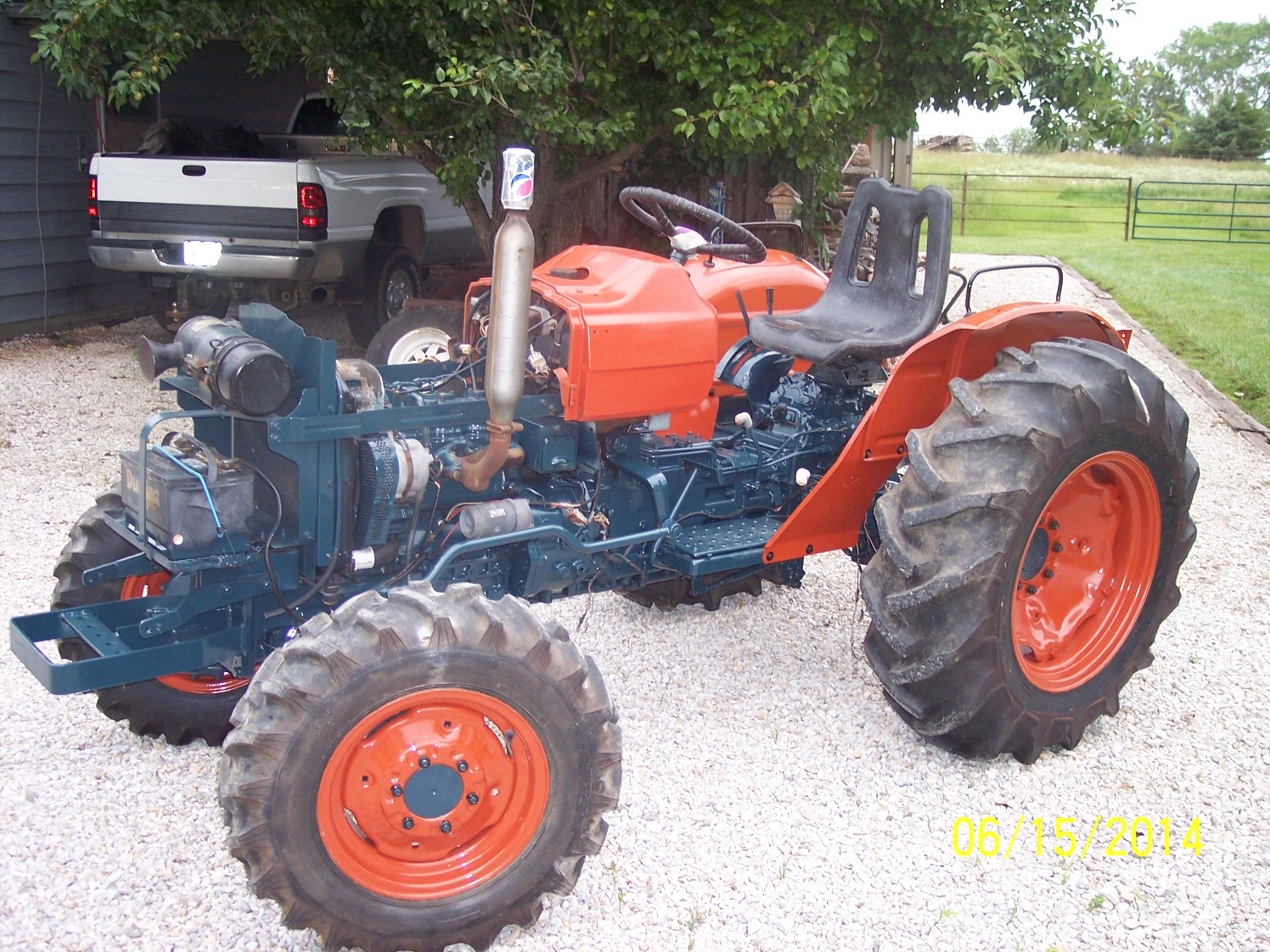

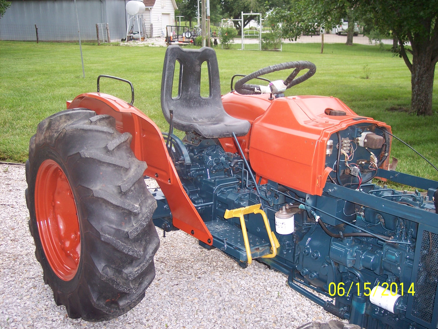

Here's a tractor I painted without having it totally disassembled. Cleaned it, protected all areas I didn't want paint on. I had the wheels off and tractor setting on blocks. Use good paint with hardener. I had the fenders off and the fuel tank cover, so I painted all the orange at one time and the blue/gray another time.

Very professional job!
OBVIOUSLY.........NOT rattle cans!
Thanks. It actually came out better than I imagined. I hate painting!!

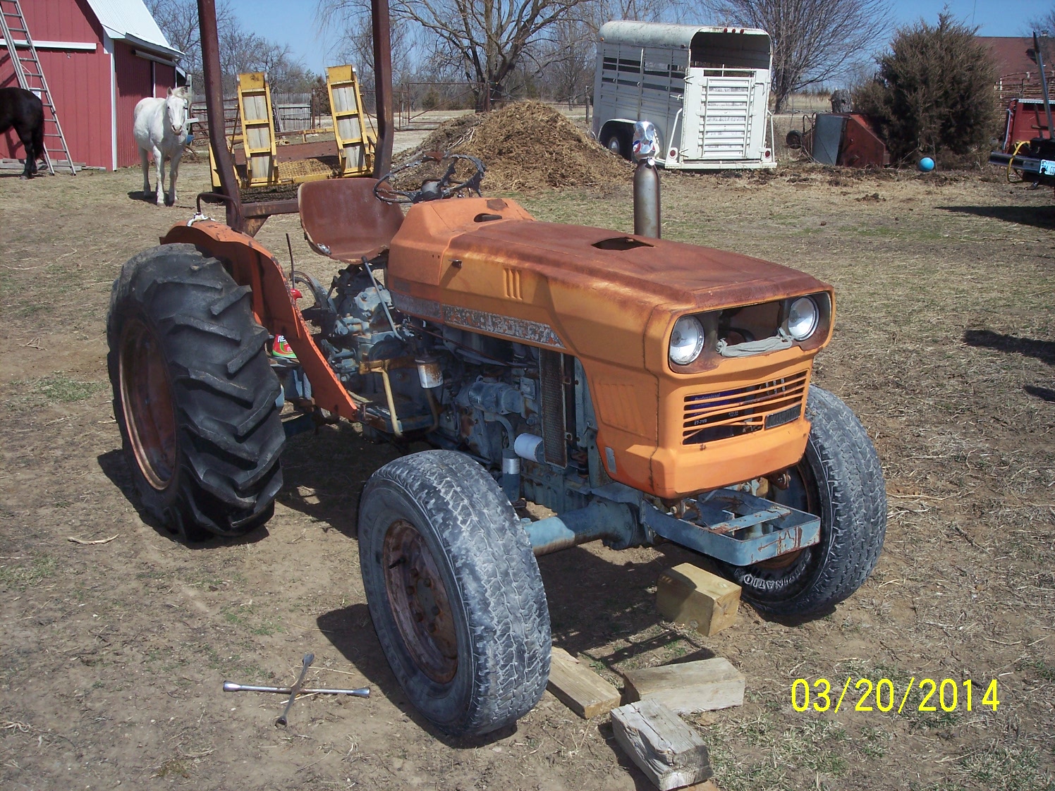

This tractor had been in a barn where the barn caught fire. Tractor had been setting outside 4 years after the fire when I bought it. It looked SAD. When I brought it home I couldn't figure out how to get the metal dash removed from the top of the fuel tank and found this forum. I posted a couple of pictures to show what I needed help with but the comments I got were to the effect it must be a labor of love because it will never run.

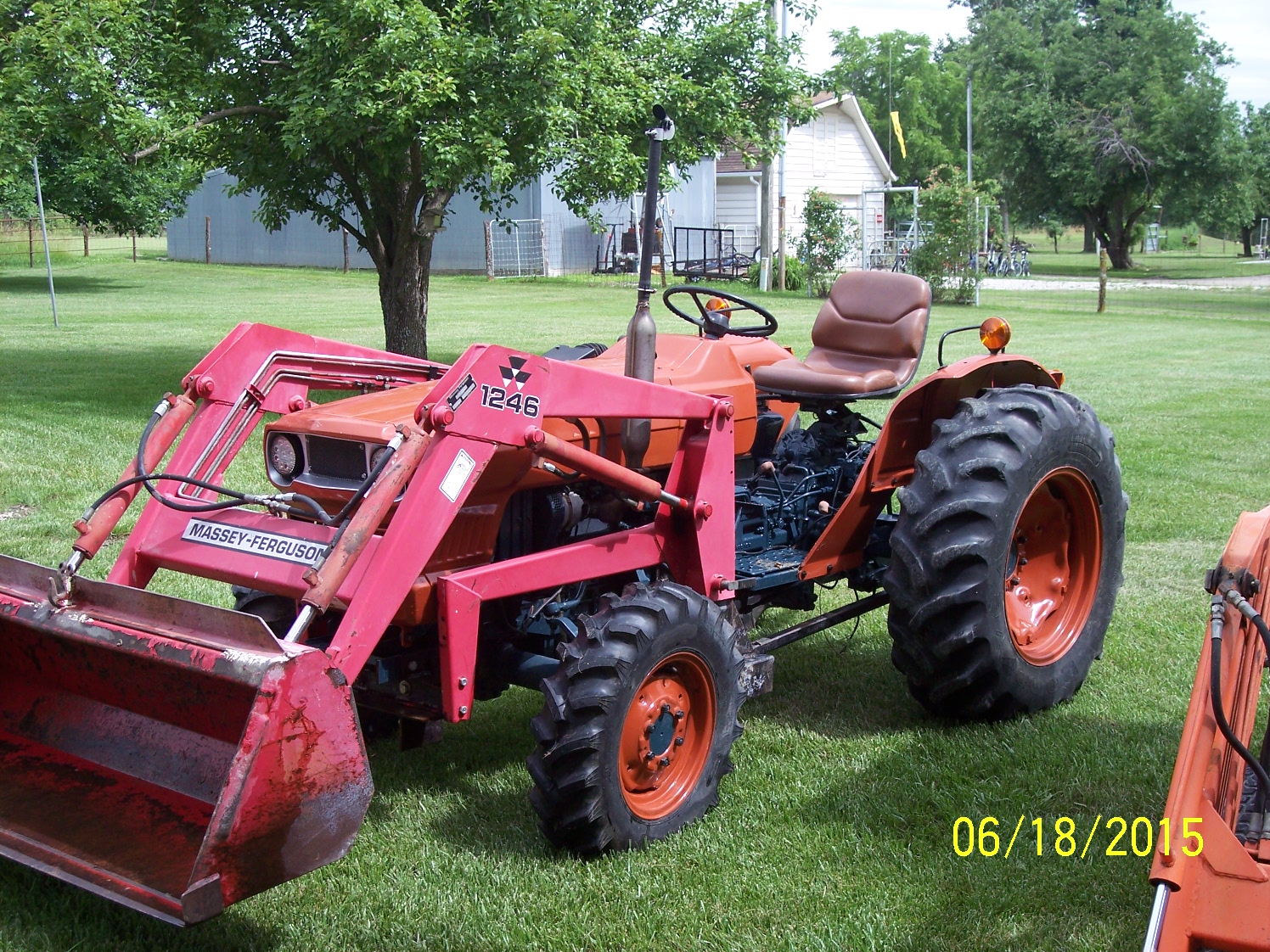

I eventually got it figured out. Went down to Beebe, Arkansas and bought a loader, modified it and built the mounting hardware, installed a nice new seat, new IP, tires and some small items.
