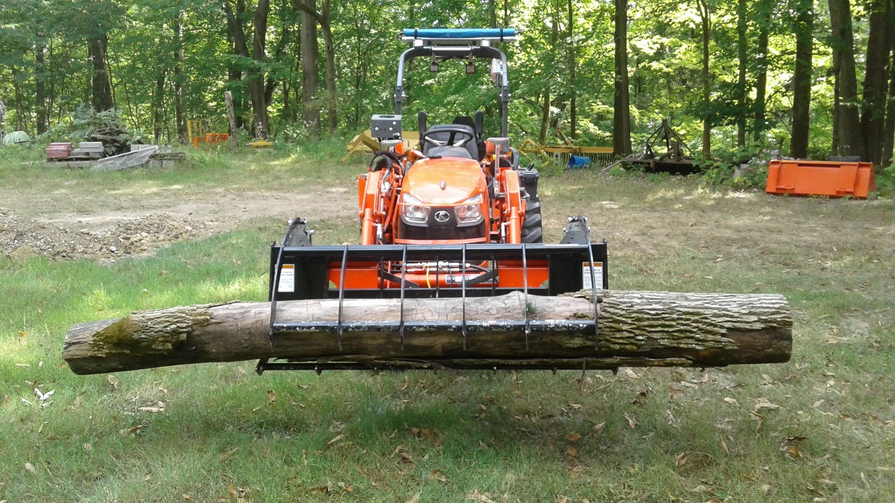

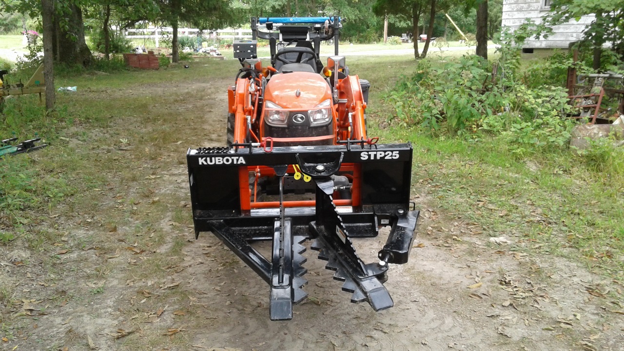

B2650 will max out at 3-4" tree if you get a good grip on it. Tree species and soil conditions will affect push/pull capabilities. Stumps will require grinder, backhoe or dozer. For 1 time job, best to hire it out, pros will have heavy duty equipment better suited for the job.
My tractor has loaded tires and 3pt ballast. LX2610 is newer version of B2650.

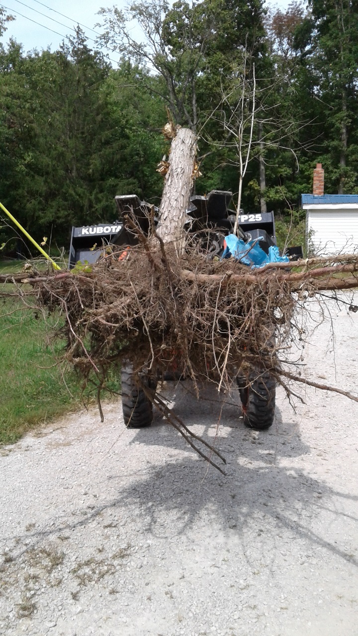

Did the 2650 pull that last pic straight from the ground, root ball and all? And where in central IL are you? Im from central IL too but its kind of a broad area
Hardest thing I ever pulled - cedar tree stump - top was cut off about 2 months before pulling. Had to rock tractor back and forth about 20 times. Each time a little more of the earth moved. Spooky when rear end left ground - impessive clamping action.
Under 1/2" stuff just breaks off, 1-2" FEL usually pulls it, 2-3" clamp on and drive forward. 3-4" may require rocking, sometimes let go and try from different angle.
If it won't pull I leave about 3' stump, rather bump into it and stop tractor than suddenly tip tractor and cause rollover. Working on my own clearing project.
