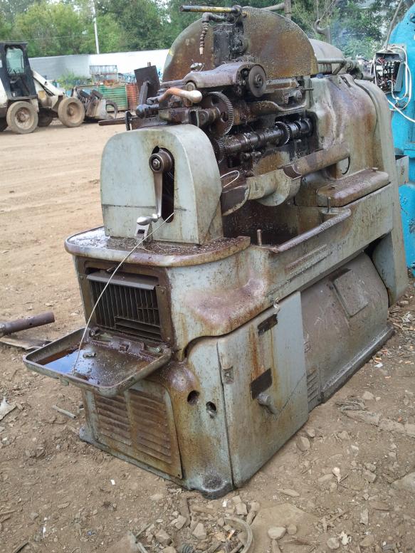

My TIG welded chrome exhaust, motor mounts, a lot of the materials are sourced from this scrapyard. I am so grateful to have them in my neighborhood just blocks from my home. The guys there really got a kick out of seeing the bike up close and listening to the motor. While there I found from a collection of dinosaur lathes and heavy equipment a louvered panel to attach atop my expanded metal radiator cover. I will trim the mounts closer to get the shroud really close to the cooling fins then switch the polarity to draw the air through being introduced by the louvered panel on the opposite side.

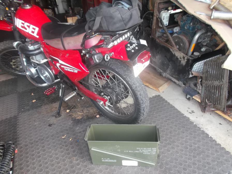

Yesterday I got at the local swap meet 2-40mm ammo cans to use for saddle bags. Time to bend up some 1/2" EMT and powdercoat the racks (and all the fabricated parts) in my oven! Good times indeed...
