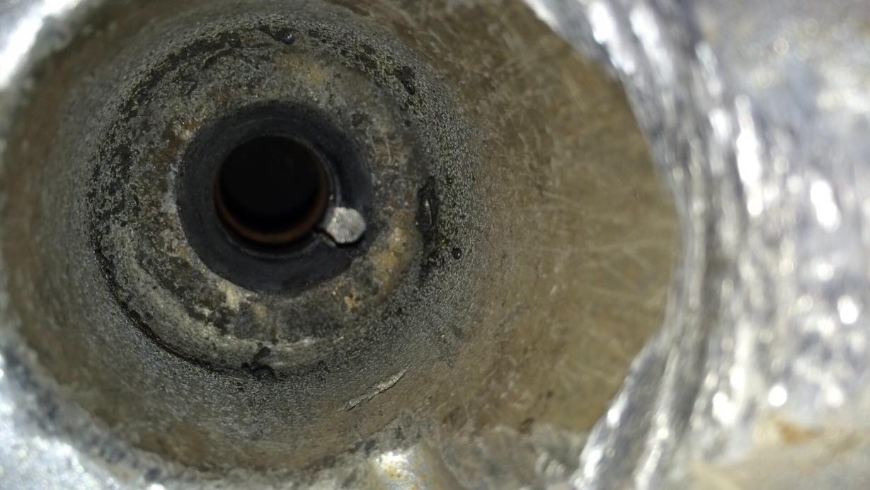

When i was lead hand in a shop, impact my be used to run up nuts, but must be hand torqued with wrench. Guys didnt like it, but managment supported me. image.jpg
Over done with impact, didnt have a clue how to get it off.
