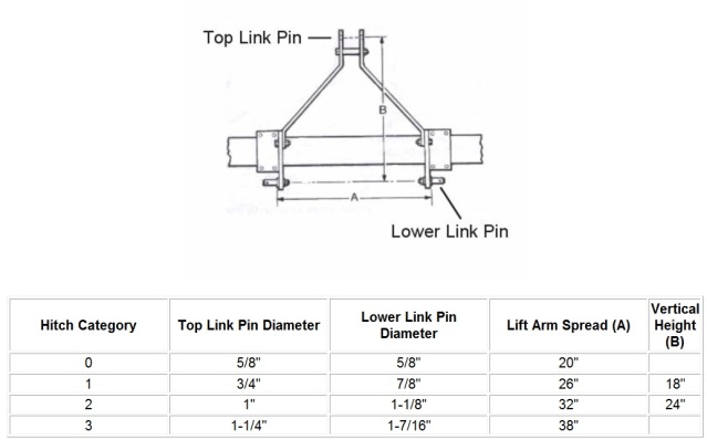

Of both the pins and bushinags I ordered from 2 different places, none of the bushings fit inside the pins. If they did, would have made a big difference being a tighter fit. Maybe I’ll take one of the pins to tractor supply and see if I can find some.
36,439
11,236
yeah 'supposed' to be....
It seems most are CAT1 on the TRACTOR side but NOT the implement side(usually CAT3 ! ). Causes no end of grief for guys who now need bushings, adapters, and a prayer to make it work.
Another possible problem is the height from lower hooks to top hook. CAT1 'should' be 16",though I've seen 18" as well in reference drawings !! Might be the hole spacing in the first picture ?
This is not true!
They are Cat2, and the reason they were done this way was for odd implements to slide in place with the assistance of a set of rolling bushings.
It's not a fault it was a design.
I really think most over complicate the setup, I have quite a few implements and they all fit the QH quite nicely.
