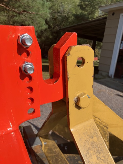

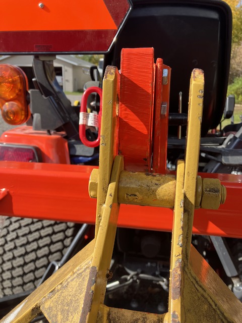

Here is 2 pictures, side and back to the blade I just bought. The hook has to come off in order to hook the top pin.

Looks like Cat0. It needs extensive surgery for Cat1
36,147
11,071
You have a NON quick hitch compatible implement.
To make it Quick Hitch compatible:
Take the bolt out of the bottom hole and move it to the top hole.
You will need to get a longer bushing to keep the spacing proper.
Pipe works for the bushing.
Then weld the rest of the angle bar onto the vertical bracket if the welds on it already are not sufficient.
Another option is to install a set of short carriage bolts from the inside out and put the nut on the outside of the slot.
Then the hook will work properly.
Moving the hook down will also work but if you have any other implement that are QH compatible you'll have to move the hook all the time.
I found it much easier to set everything up as the same pin spacing.
If the bottom pins are too narrow with the bushings installed you can buy longer pins.

Looks like if he pulls the bolt & moves it tp the upper hole there may not be anything for the 2 support arms that are bolted to the lover hole ?

Another possible problem is the height from lower hooks to top hook. CAT1 'should' be 16",though I've seen 18" as well in reference drawings !! Might be the hole spacing in the first picture ?
