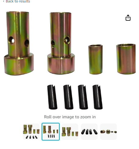

Having the same issue hooking up. The top hook on the quick connect is so large it won't hook underneath the top pin without me getting off the tractor, removing the pin, back in further, then put pin in. Does this on both ballast box and my back blade. Bad idea to grind down some of the hook? Got my bushings in from amazon. Only 1 set came in the mail. Was supposed to be 2 sets. Just batting a thousand at this point. Pissing me off though.
