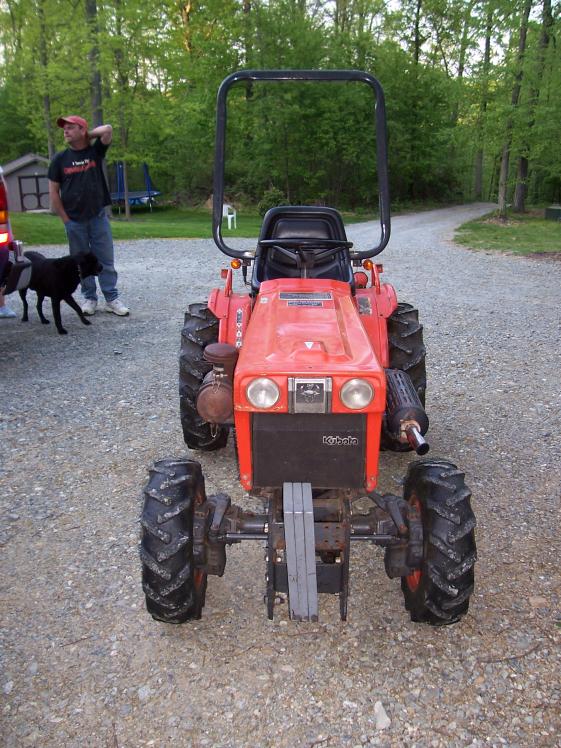

yours an older version?- and right below the radiator no pto? I have two, 90 and 92 and they both have pto's right off the crank, most that had a FEL that ran the pump off the front pto. It is covered with a shield. I know several members here have a FEL and use the pto off the front.

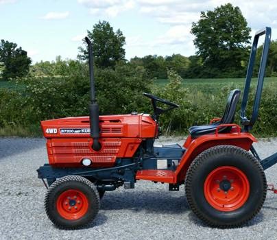

look in picture :
here is one (79 model) courtesy of procraftmike
look in picture :

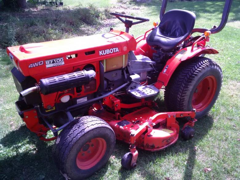

Nope, mine was the last model year (1997) and no front pto. See photo
