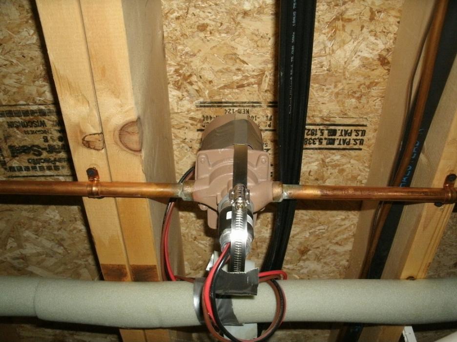

You beat me to it, Howling. This is a picture of what I use in my house to keep warm water readily available on the end of the house opposite the water heater.

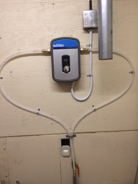

Put in a small point of use tankless water heater, you can run a 220 volt line to your homes panel and put in a designated breaker
