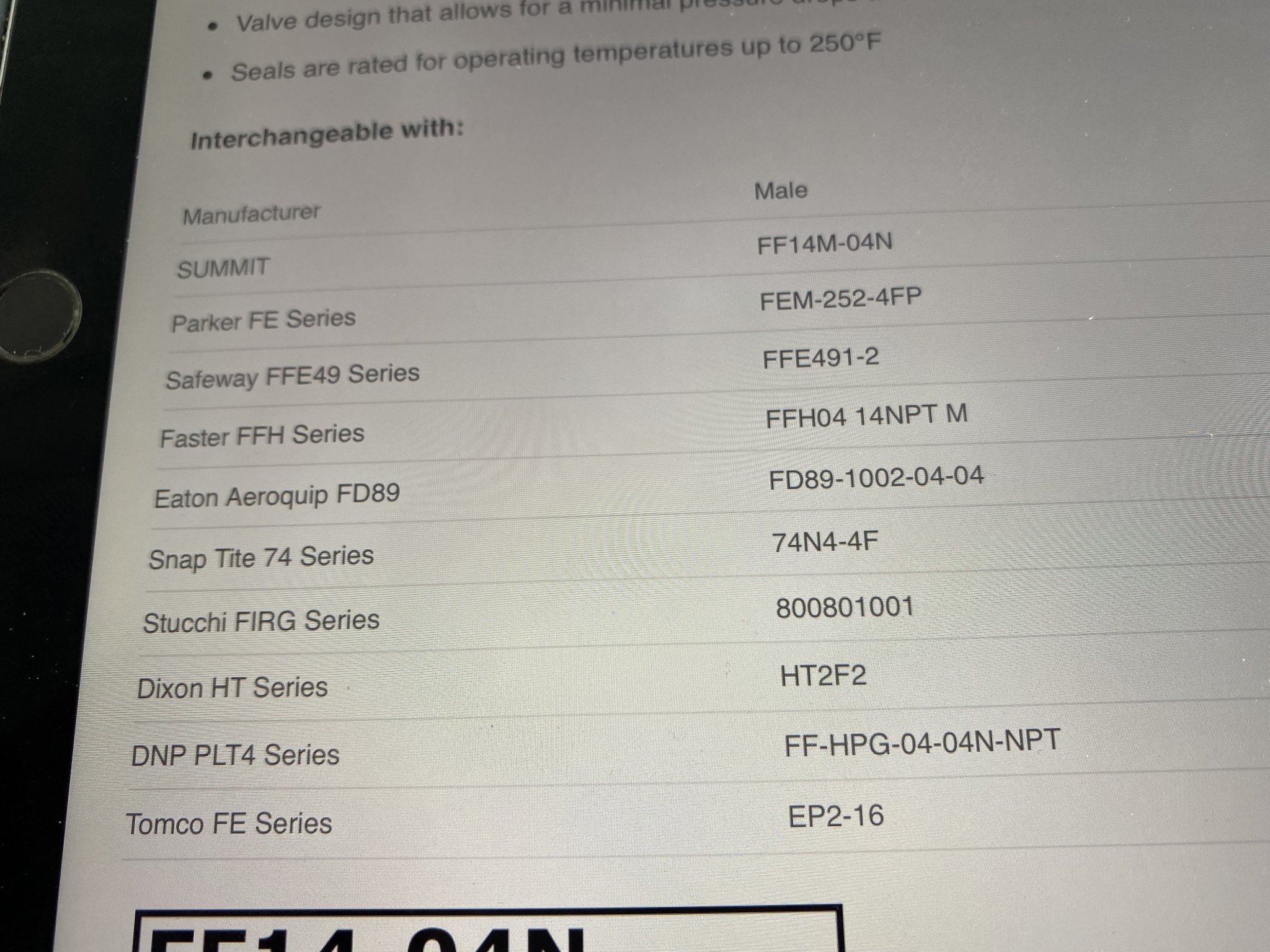

I have a kubota BX1880 that I bought used (it was only one year old) and the quad connector didn’t leak a drop until I moved about 30 yards of dirt. After that it leaked whenever I moved the bucket. I saw a forum that a guy had a kubota 2380 and he removed the loader quad manifold and put on 4 -3/8 jic x 1/4 npt fittings and 4- 1/4 npt summit flat face hydraulic couplings and it hasn’t leaked a drop since.
I got on the internet and the summit connectors are back ordered and say the may never be back. Summit had a bunch of interchangeable coupling numbers. The female flat face couplings I went with are Stucchi A/FIRG part# STU800801000. You don’t have to do anything to the tractor end of the hydraulics. This may just be a coincidence but from day one of my owning the kubota the bucket quickly started to sag. Now it doesn’t and not a single drop on the floor. Here is the list of interchangeable flat face couplings for your bx 1880 or bx2380 kubota
