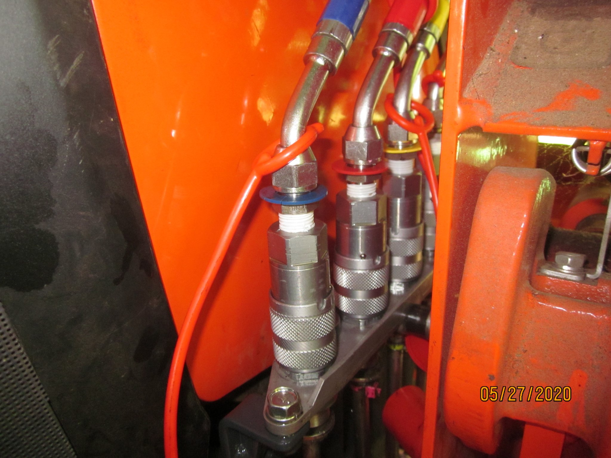

It's coming from the crappily designed quick attach hydraulics. It's a known problem. Many have been repaired/replaced under warranty only to have it happen again. Lots of us have replaced the upper connection with individual flat face couplers.

It's coming from the crappily designed quick attach hydraulics. It's a known problem. Many have been repaired/replaced under warranty only to have it happen again. Lots of us have replaced the upper connection with individual flat face couplers. View attachment 71253

The ones who went with flat face connectors, I assume they eliminate the mounting block that is pictured? And went hose to hose?
The female upper mount is replaced with four, individual, flat face, female couplers. The lower, male mount is not changed in any way.
Instead of flat faced couplers, I used Pioneer couplers (same as a snow plow would use.)
They were MUCH cheaper.
since the switch, I have had NO leaks or problems.
The stock Kubota quick connector is garbage.

It's not the flat faced couplers.... it's the quick connect manifold.
it's been documented many times.... But of course there will always be folks that never have a problem.
everything is fine until it's not.
If you do the conversion and eliminate the quick connect, flat faced or pioneers will work fine.

that manifold is a stupid setup.
Kubota even admitted to it and attempted to fix it a couple times.
In order to properly repair, they would have had to completely redesign the connection(s) and I don't think they were willing to do that.
it along with the easy-over deck is not something I would ever though Kubota was mass produce; it was nothing more the a marketing ploy to compete with Deere.
