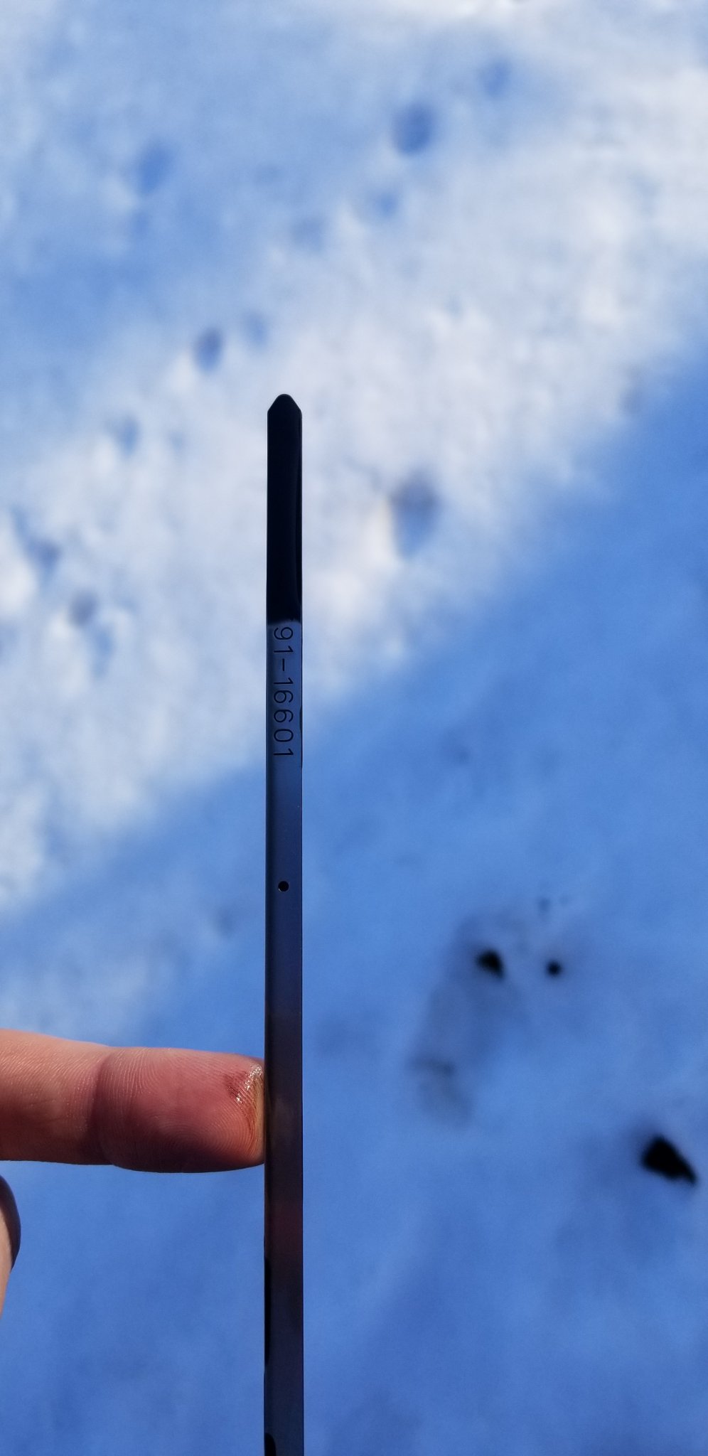

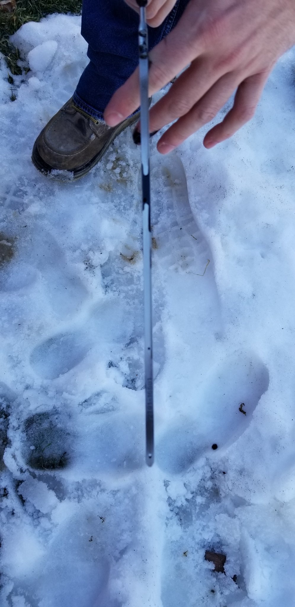

Hello,
This is slightly off topic, but I got my M59 towards the end of last summer and the previous owner had just had it to the dealer for all fluid changes so I have yet to do an oil change myself since I haven't put many hours on it yet.
Wanted some opinion on where the oil level should be on a cold engine on my particular dipstick (PN 32791-16601). My dipstick only has the 2 holes and a PN on it (see photos). Generally on a dipstick like this I would assume top hole is full, bottom hole is low. I figure this should be the same but the distance between the holes seems huge. When I check the level with a cold engine, it doesn't even cover half the PN. Am I too low?
When hot is covers more but not near the upper hole. Operator Manual doesn't give any detail on where it should be at any time.

Hello,
The upper hole is the Maximum fill level and the lower hole is the Minimum fill level. You are OK anywhere in-between. Most people fill to the upper hole with a cold engine.
6,101
3,389
Tractordata says the M59 engine takes 9.9 qts (probably includes the filter) You might do an oil-change and see where that puts it.
