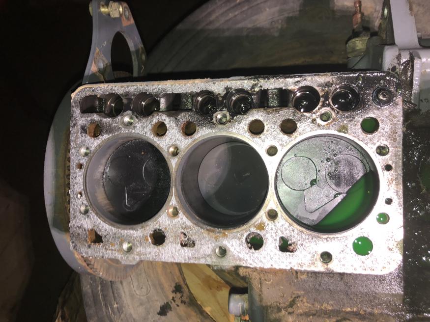

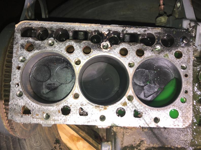

I read somewhere that the picture/word exchange rate is 1:1000.
jetattblue
BX1800; L2550
Mar 14, 2018
103
Arlington, TX
Hagrid, That's a fair point. Attached is a picture of the piston tops. It's a little difficult to decipher color, but this should help. Pistons 1 and 3 are black, and you can see that they have a wet or oily appearance - which I understand to be normal. In contrast, Piston 2 has a matte gray appearance. It's very light gray, and, this pictures shows that it is much, much drier looking.
Notably, the coolant in the closest cylinder was not there until the engine moved while removing the head. In other words, it was introduced into the cylinder during the removal process. It was not there originally.

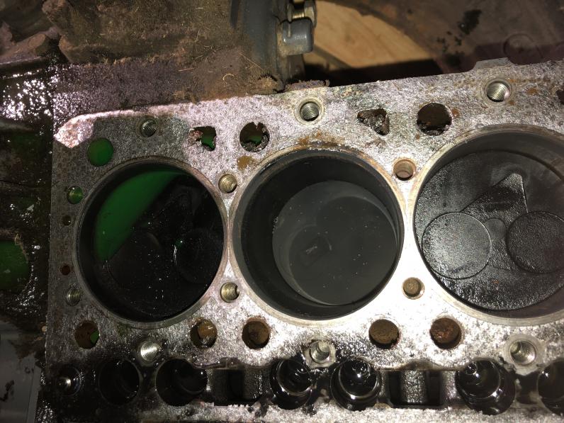

Here are the only other 2 pictures that I have at the moment. Again, while it's difficult to see the light gray color of Piston 2, you can clearly see that it is matte/dull on top, while the others are black and have an oily or sooty sheen to them.

Get the coolant out of the cylinders!!!!!
I think your looking at this backwards, looks to me that #2 was the only one firing and #1 and #3 were washing.
That looks to me like they have been over fueling those pistons and not burning properly, bad injectors.
Pull the oil drain plug and put a cup or so of acetone or lacquer thinner in each cylinder, and see if any leaks out the bottom of the pan.
If you get none or very little and the cylinder walls are smooth don't bother doing rings, because that isn't the issue.
Have the injectors tested, as I'm betting that's your issue.
EDIT: Relooking that the pictures, #3 is definitely being washed (can't see others clearly enough) and very likely has ring, liner damage.
# 2 looks like it has some discoloration where the head gasket seals. Could that be an indicator of the head gasket leak?
