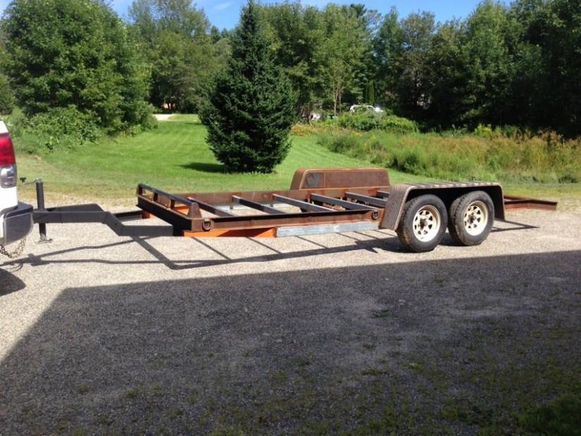

Figured I'd share my trailer build. I started with a 26ft camper trailer that had been set on fire. I started by stripping off everything down to the bare frame. Here's when I started fabrication.
Ryansweatt2004
2017 kubota L3901HST
Jul 2, 2015
205
West gardiner maine, USA

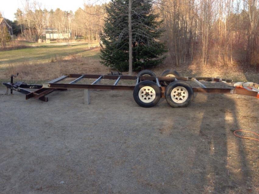

I cut the frame rails at 16ft, widened the frame from 55 inches to 72 inches, added a 2.5ft beaver tail, started building a new trailer tongue from 4 inch channel.

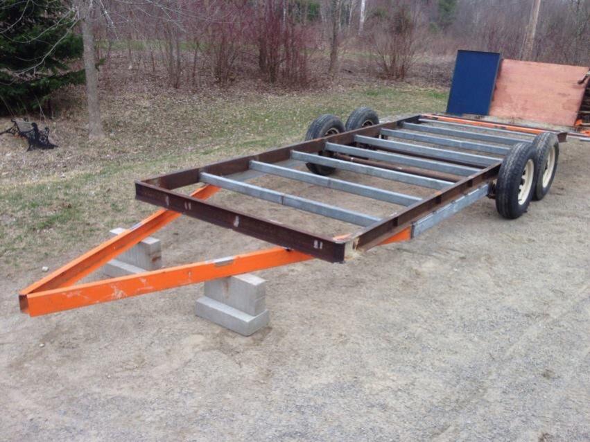

Fenders are on, started adding d-ring tie down points, hitch is all done and plated. Trailer is technically towable by this point. I also added a stop bar at the front of the trailer as well.

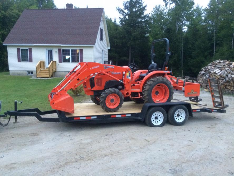

Not sure why that photo keeps turning but you get the idea at least. So far because of how busy life has been it's taken me three summers of fabricating in my front yard to get to this point. Tonight I finally got to load my tractor on my home made trailer for the first time.
Ryansweatt2004
Jul 2, 2015
205
I had hoped to have the money to invest in 5200lb axles but for now I've had to settle for keeping the stock 3500lb axles. Either way it holds the tractor fine. Don't mind the flat tire. It's been leaking air for a while now lol.

Nice job!
I kept scrolling down at the pictures and they all said "today" and I thought man that guy can fabricate things FAST. Then the last post explained.
10,425
2,215
outstanding work:).......... need to buy some AIR in that port side tire!!:D:):)

I see you put a long tongue on it: good for you. I detest short tongues on trailers!
Good job! Except for the tire! But you already knew that..... :D
Tooljunkie
May 13, 2014
4,150
59
Nice job. As far as tire goes, nothing a little air wont fix.
It will sit better once tire is repaired, as all weight is on back wheel. Looks a little close to fender with flat tire.

Thanks everyone. My profession has always been fabrication and welding but life decided to take me in a different direction. This trailer build was the prequel to me buying a tractor. It's been a long build and I'm just finally nearing the finish. It's got 4 inch drop axles so it already sits some what low compared to most trailers. I honestly hate seeing the homemade "car/equipment" trailers that every joe blow seems to build and post for sale all over craigslist. Everyone seems to miss the fact that these quote "heavy duty" trailers can't even fit a car between the frame rails let alone support the weight without heavy modification. At the time when I started the build I knew I'd need a trailer before buying a machine. I actually wanted to buy one but had recently been laid off from my job and couldn't afford one so I opted for the next best thing. One hand built by me and to my specs. During my build, life got busy, kids came into the picture and I didn't always get the time I needed to finish it all in one go. Weather also plays a big part in finishing any metal fabrication project when the project is being built out in the elements in the middle of your driveway lol. For now most of my fab work is done other than I need to weld on some loops to tie up the wiring harness, fabricate some ramp locking mechanisms and then it's on to stringing up the light and brake harness.

I would say that you have built a fantastic trailer - and if you EVER had to sell it would be money ahead. Nice looking machine too! :) Something about doing something yourself and then looking at the finished project, so much better than just buying something new. :)
