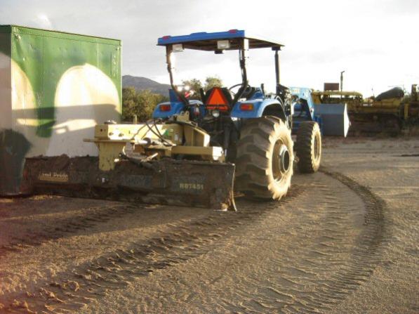

I'm not entirely sure what the OP is trying to accomplish here. If it's to get a totally straight line from tractor to blade, through the pivot points of the lower arms, that's not going to be possible, the pivot point height is lower than the implement draglink height.
So doing what others have said (lower the top link attachment point, or hydraulic top link) will work but there will still not be a clean line of pull through the pivot point of the lower arm links.
If I were trying to do this 'better' without monkeying up the adjustments for all my other implements or spending $$$ on an expanded rear hydraulic system, I'd make an attachment frame that mounted into the quick hitch system and started with the implement draglink frame level. This could be done with a welder, some angle iron and a new set of link pins.
An adapter frame like that won't fix the 'straight line' through the pivot point issue but it would pull from the middle of the adapter frame which would be roughly between the toplink and lower arms, pull wise, and that's not a horrible place to pull from, not optimal, but not horrible for a blade.
I haven't seen a simple constructed blade like that yet that looks right on a compact tractor. The ones with tilt on the main shaft look right when adjusted properly, but you pay for that feature!

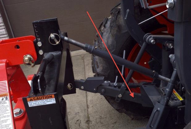

Ok here are the results of the latest trials. Not to worry, nobody has muddied any water as far as I am concerned, please continue with comments, I appreciate your patience with a newbie.
The problem I was trying to solve was to adjust the 3 pt so that the plow support beam was level at plowing height (so I could swivel blade around and not have one end dig into the ground) AND be able to lift the whole thing high enough up in the air that I could get out of the barn without it hanging up, and to be able to hike it up to go over a pile of snow if necessary.
1. Moving the left and right lower links up to top hole in the U shaped bracket got me from 6 inches off the ground max lift to about 8 inches max lift.
2. Moving the top link DOWN to the bottom hole on the tractor got me to 14 1/4 inches max lift which is just enough to get out of the barn without scraping. Progress!
So here it is on a "level" surface, blade more or less horizontal after I pulled it out of barn.
After futzing around with top and side links to get the blade support beam level:
The blade can then be offset and swiveled without getting cattywampus.
and swiveled.
The next two pictures show the angles of the lower links which are not downwardly angled as suggested by Diesel, and which actually show that the top link is roughly at right angles to the lift rods.
So...it might work fine in this configuration, which was the one suggested by mtn view and NIW. I expect if there isn't too much snow, 14 inches of lift might be enough. Comments? We often get 6-8 inches at once, last winter the whole mess accumulated to about 2 feet.
If not, Cerlawson and I earlier thought of putting shorter lift rods to get more lift (NIW doesn't think that's a good idea, and I am wondering what the forces are on these parts, especially if I hit something immoveable with the blade :eek:), and Diesel suggested lowering the angle of the "lower link" to use Kubota's terminology to get more lift. It looks like the latter could be accomplished by moving the pins to the holes closer to the body of the tractor??? I would guess that that might then require Shaun's modification to the quick hitch or a subframe?
The experiment I didn't think to do was to round someone up to run the hydraulic controls while I videod or at least watched what is happening to the angles when the plow is raised. Maybe next time...
Thanks!

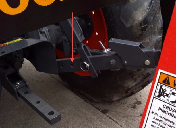

Have you tried moving the lift arms forward on the lower link? That will allow more movement, (if clearances allow) but less lift strength.

As someone else said, moving the lift arms to holes closer to the rear axle will increase the lifting distance quite a bit. But it also looses mechanical advantage of the lever, so will be able to lift less. Not a problem here I would think.

I didn't catch that the arms weren't in the forward holes, that will change the lift drastically! ;)
