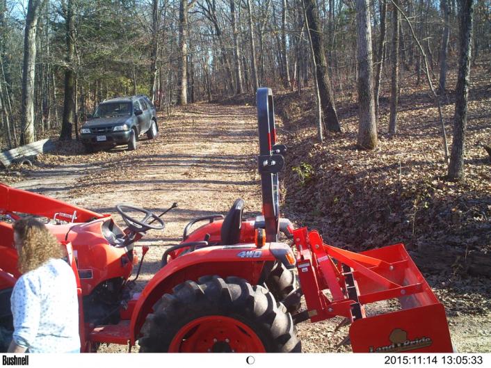

If you have the top link connected to the tractor in the bottom hole it is really easy to break both tail lights. I have a quick hitch on my L3901 and noticed how close it was coming to the lights and figured that if I moved the top link to the top hole it would add some room between the hitch and lights. It is still close when I have the box blade on the hitch and I have it set to dig, I just have to watch it the first time I raise it. I was thinking of getting another stop for the 3pt control to limit how high I can lift the 3pt.
I think you can see in this picture how close the quick hitch comes to the fender and lights.
