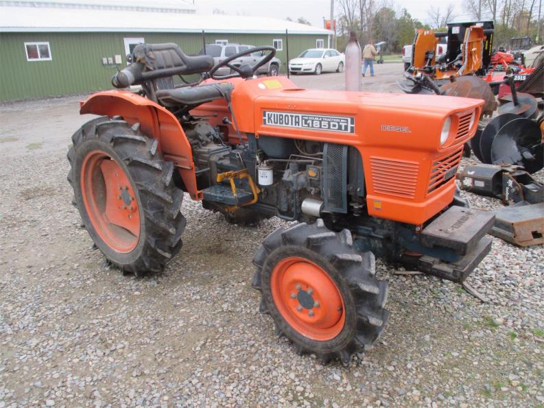

Ok so I'm looking to buy my first 4x4 tractor and I need advice. My choices are a very nice L185DT with the 2cyl (17hp) with 1745 hrs and a ok looking, not as nice B2150 with the 4cyl (24hp) but only has 854 hours and is a 1989 model. L185dt is $4k and the B2150 is $5700. I'm looking to use it to plow snow and I'd like to buy a tiller. So if someone can give me some pros & cons that would be great!!!

Kubota has lots of tractors that are just a bit different in specs and create a challenge in deciding but in this case it seems more simple, There is a more than notable 40% increase in power and in my opinion it is in a range where it is a big deal with a lot of implements that could be in your future. The 2150 is more than a decade newer and this really is more a matter if it is worth the dollar difference to you !! I see no advantage in the L185 other than nostalgia and price point. More of a personal question as the answer is likely different for a lot of us. Do you need the 24hp or not and does it fit the budget. I like the 4 cylinder larger engine and lower hours.
If someone else can tell us the L185 is a rock of a tractor compared to the B2150 that would be interesting and maybe another way of saying what you are asking ??

I went out and found both tractors in question and I can see the attraction in the L-185 from a condition standpoint, it really looks like a nicely preserved tractor, the B is obviously a lot more used looking and weathered. I also went back and re-read your intended uses and the L-185 sounds like it would get the job done in style for less money. It is a pretty tractor. If you can afford either then I would take the $5700 with you and let the tractors talk to you when you get there, the better choice will become obvious in person I bet !! That L is cool and clean looking and I bet the B is less appealing that the pictures let on in person, just my guess... The B was obviously deeper in rubber but the L was very adequate too. Enjoy which ever you decide.
EDIT: One more comment and it was most significant after doing it. Go on youtube and watch a few videos of both tractor models working !! I thought the L's 2 cylinder engine was a bit annoying to listen to unless you just happen to enjoy it, as opposed to the B's 4 cylinder sounding like a little 4 cyl. diesel sewing machine !! Watching the various videos irreversible swayed me to choose the B in this case... Final answer !!
