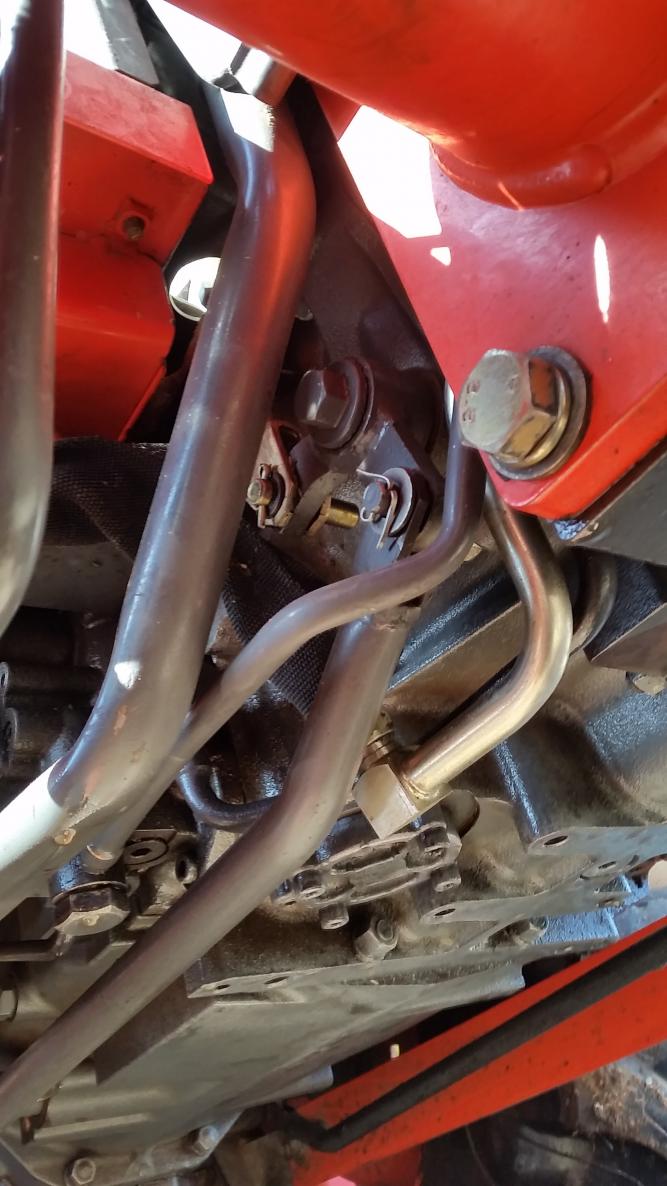

Working Dog, you inquired about the installation of the 3rd function kit on the L3540. The xx40 series tractors have the loader control lever on the right fender, not on the loader tower as others are. To install the kit requires much more effort. Like removing the right side rear tire and fender, draining some of the hyd. fluid, removing some of the loader mount.
I had the kit setting in my shop for a couple of weeks and when I saw what was required I took it back (with my tractor) to the dealer for them to install. I'm sure many folks have installed them themselves, but just a warning it's not as simple as some might think, if they are not familiar with this particular model.
Also the Kubota third function kit has steel lines going down the loader arms to the crossover tube. They mound in the brackets already on the arms. In my opinion, a much nicer setup then hoses as other suppliers provide. Whenever the Kubota kit is installed it is as if it was installed the day it was delivered. Perfect in appearance and function.
Here's a couple of pictures to show the lines. Notice all the lines underneath!!!
