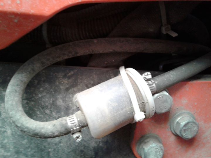

If you plan to use it for snow removal remove the mower deck. I didn't do that the 2nd year, had the deck locked in the top setting. The fuel filter under th tractor iced up. No room to replace it, darn hard to get heat gun aimed on it.
6-7' of fuel line, splice and hose clamps and I moved it out from under the BX where it can be easily serviced.

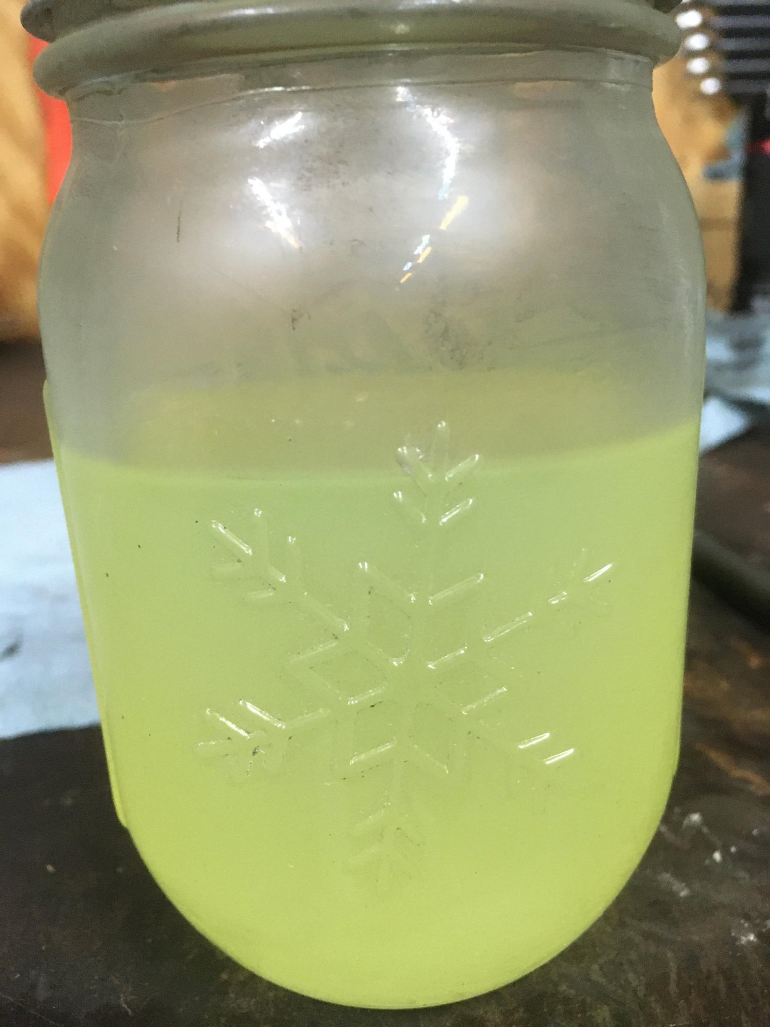

No harm done with the 911.
Most pump fuels are already treated for your regions average temps. The sudden and severe cold snaps is what gets us in trouble. That's what happened to TX last year. This is pump diesel when it's 20° colder than the average low temperature. It didn't gel but it was way into the cloud point.

That is very interesting looking. Is this something that could happen while operating the tractor? I ask, since the tractor will be stored in a heated garage, and the only time it should experience anything like a cold snap, or sudden change of temperature, is when it leaves the garage.
I wasn't very specific. Sorry. I wasn't talking about sudden temperature changes like going from inside to outside. I meant changes as in Polar Vortex/ Bomb Cyclone temp drops. Where the weather changes quickly and the fuel suppliers have not fortified the fuels to meet that low temp.
Straight diesel will cloud at 15°f. In Maine they probably treat it down to 0°f. But if it all of a sudden went to nights in the -20°s the fuel in your tank wouldn't be treated for temps that low. It happens especially with equipment like tractors where the fuel may have been purchased in the fall.
