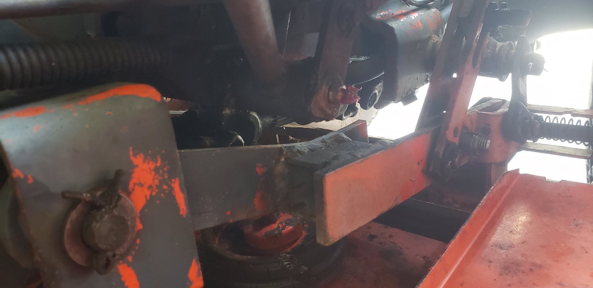

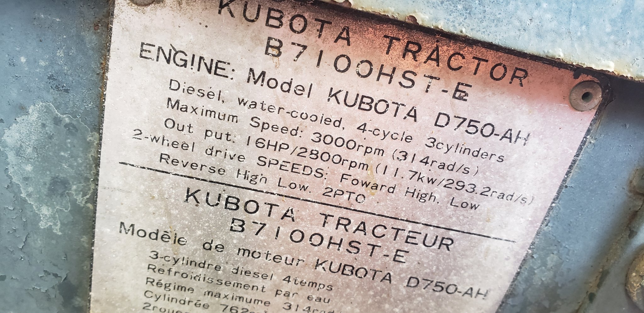

2nd issue, the deck, from the paint is not original, and is at least 60 inch, see pictures of the tag, after putting it back on, (what a pita!) I noticed it had been modified to fit, the 3 point also does not lift it due to the bars from the 3 point to the deck are just not right.. is all I can say.. again after putting the deck on and mowing for a bit in 95 degree weather I was done..

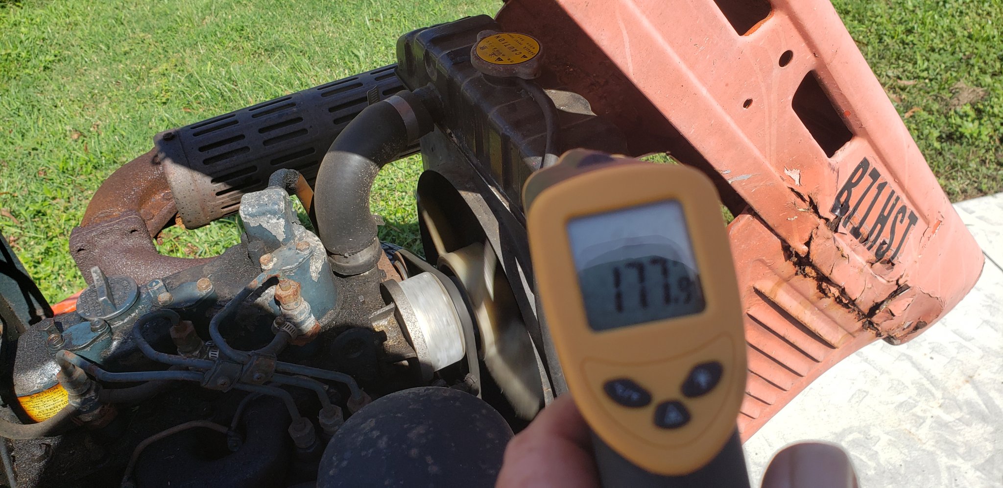

It also seems to run a bit hot the thermostat housing was 198 degrees after mowing for 15 or so minutes.

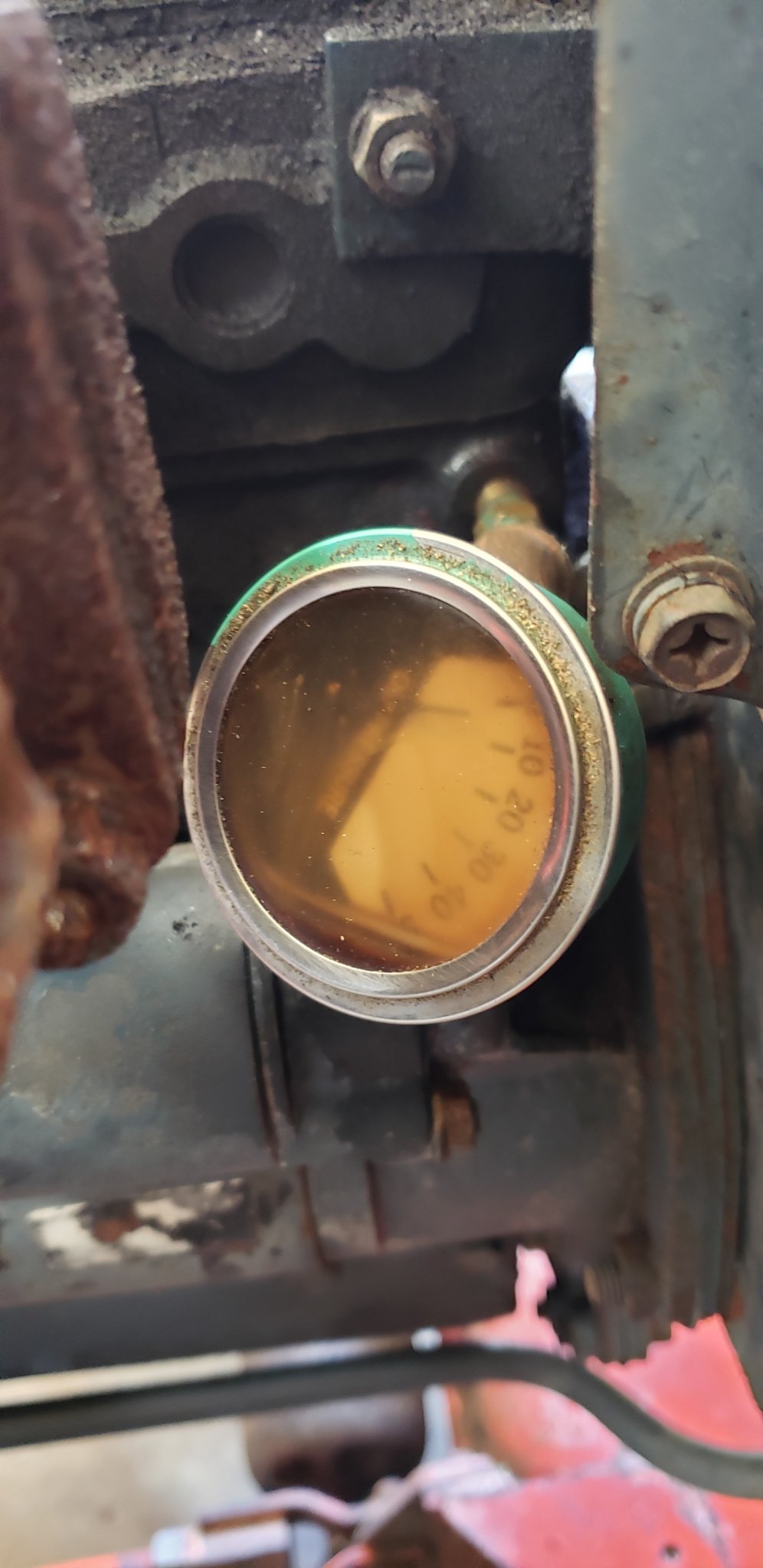

I plan to add a oil pressure gauge, I am pretty sure I have one laying around..
That mower is designed for a "New style" B7100. Yours is probably one of the "old style" B7100 tractors. (This is just a guess). That is why it needed to be modified to fit.
A B7100 does not have a thermostat. It also does not have a water pump. It is a thermosyphon cooling system. 198 degrees is not excessively hot.

Get the mechanical oil pressure gauge installed before you run it much more. If the oil pressure is actually low it is probably a plug that falls out of the front of the camshaft.

Will install the oil pressure gauge tomorrow.
Should I undo the oil pressure sending unit and put it there or is there a better spot to add it?

yours is an 80's model - easy to tell by the 4 bolt pattern on front rims

AS for the heat - get a infrared thermometer and check at top of the radiator once hot (work it hard) and check the lower neck where the lower hose connects. You should be close to 200+ at the top and something like 120-130 at bottom. You need 50 F+ difference to be in good shape. If you find too hot at bottom clean the radiator inside and out. Many ways to clean - pressure washer not a good choice.
As noted by Kubotasam, your tractor has the 4-bolt front wheel, so it is the older design. The RC60-71B is designed for the newer version with a forward facing PTO and 6 bolt front wheel.
Make sure the radiator fins are clean and clear of debris. Make sure the radiator is topped up above the bottom of the top hose, to ensure the thermosiphon cooling system can work properly. But 198° is not too bad.

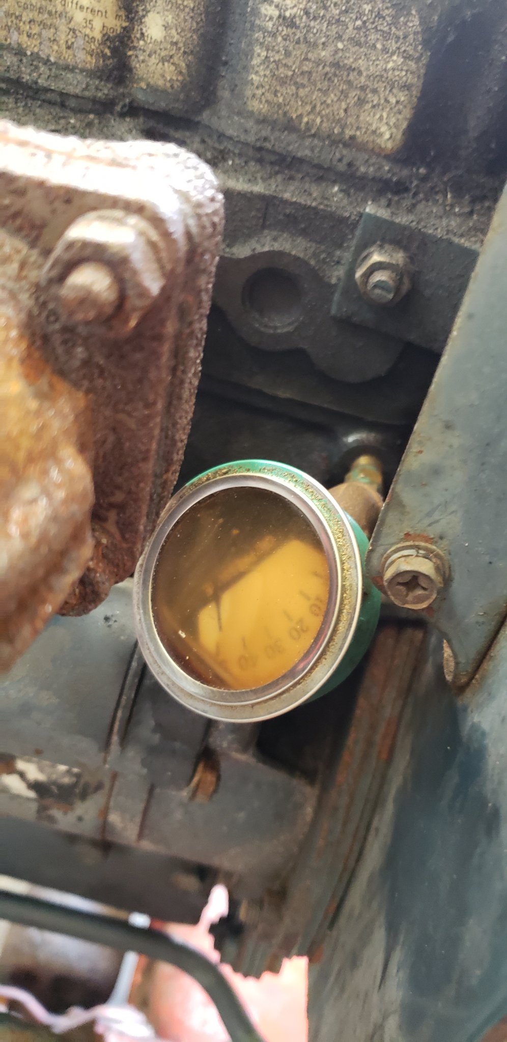

Rigged up a oil pressure gauge.. has very good oil pressure when cold.. going to five the engine a good pressure wash then mess with the deck lift mechanism

Ok well this is a tough old girl.. ran it in 95 degree heat and cut about an acre and a half and after mowing the oil pressure was still at 35 40 pounds..
Oil temp at 174, bottom radiator hose at 140 top at 190 at maybe 1200 rpm.. when I increased the rpm to maybe 2500 it quickly dropped to 170 degrees at the top of the radiator..

Also adjusted the deck lifting bars and now it will pick the deck off the ground.
