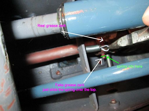

it is a spring, and the diagram shows it as a clutch release spring, and I think one end goes through a hole on a piece of steel bar spanning the clutch cover and it looks like the other end just goes under the nut of a zerk fitting?
I cannot see anywhere else it could connect, and the diagram isn't clear...
hard to see up there with everything in the way...
not sure why the spring is needed there, as there is a huge spring on the clutch pedal that pulls it back

On the B7100 there is a bolt holding the spring on to the collar.
I think I've seen a picture of your set up and I do believe that the spring is held by the grease zerk.
The purpose of the spring is to pull the collar back and hold it tight to the clutch fork otherwise the throw-out bearing can ride on the pressure plate and cause premature wear.
thx a lot for confirming my thought that it might just go onto the zerk fitting....this is kind of odd to me, but if it works, and Kubota thought it would be fine, then so be it.

I think this is right, you can't gain access to the side zerk right?
