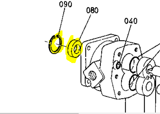

Do you wan to do it yourself?
There is really no rebuilding it needed, just replace the seal.
then before running it again make sure the system is set up properly to keep from blowing the seal again.

Yes I can change out the seal, just need to find out where to get parts and maybe a section of a shop manual or something might be handy.....

Just get the seal from a dealer.
And gasket
You'll just need a snap ring pliers to remove the snap ring then seal.
Simple as that.
I will caution you that if you have an aftermarket loader, a loader that was not plumbed properly, or a malfunctioning pressure relief valve, that could be causing a seal issue.
and even putting a new pump will give you the same issues.

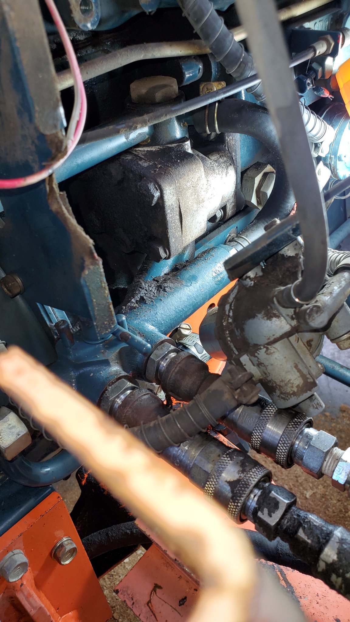

Good day
I have A couple questions regarding the seal replacement on my B 7200. I've done a fair bit of wrenching in my past but none on this tractor. So thanks for the help in advance.
1) Does the hard piping have to be removed from the pump body and if so and if so can it be slid out after taking out the upper and lower hard piping bolts shown shown in my picture mark up or is there more to do?
2) To replace the seals do I have to remove the two remove the 2 inner bolts connecting the pump to the block or the 4 outer bolts that hold the pump together?

To replace the shaft seal in the pump, you must remove the piping (they are large diameter banjo bolts), then unbolt the pump from the engine, then separate the pump body.

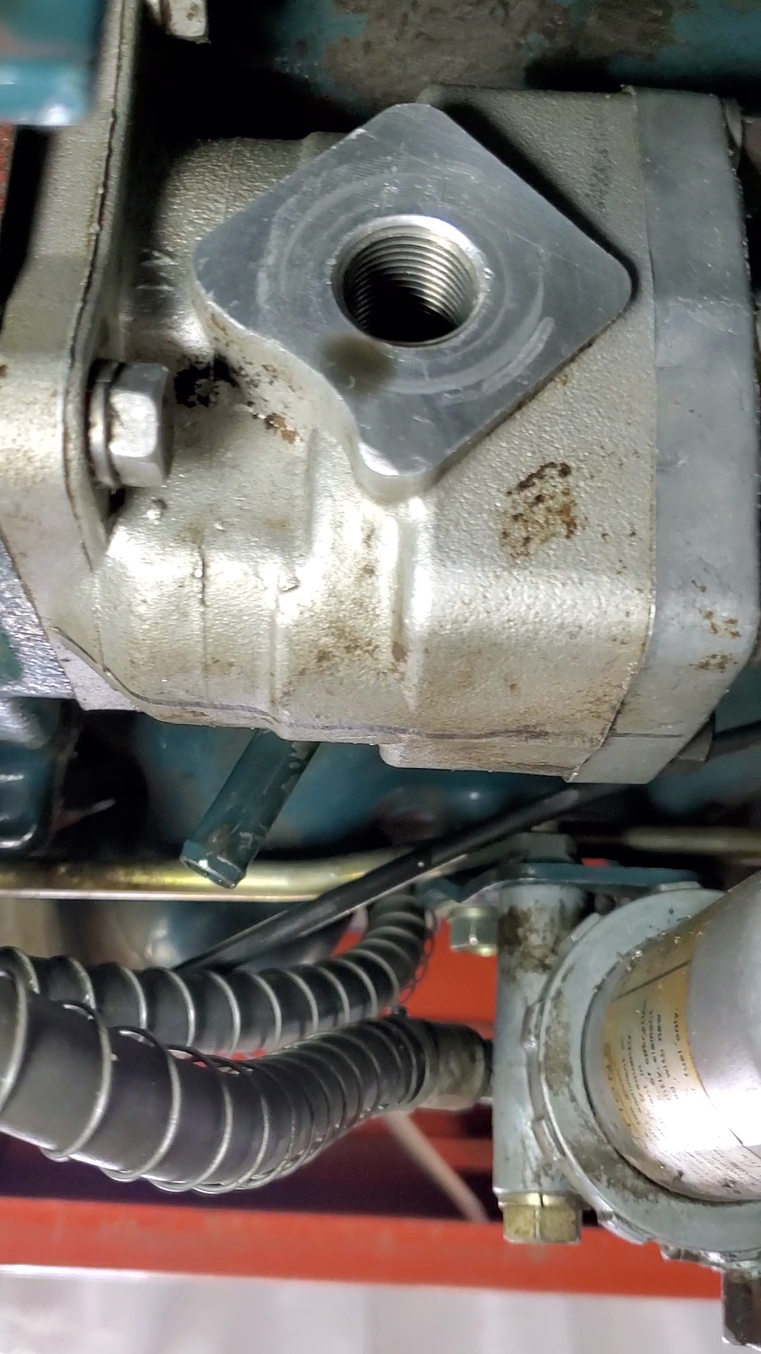

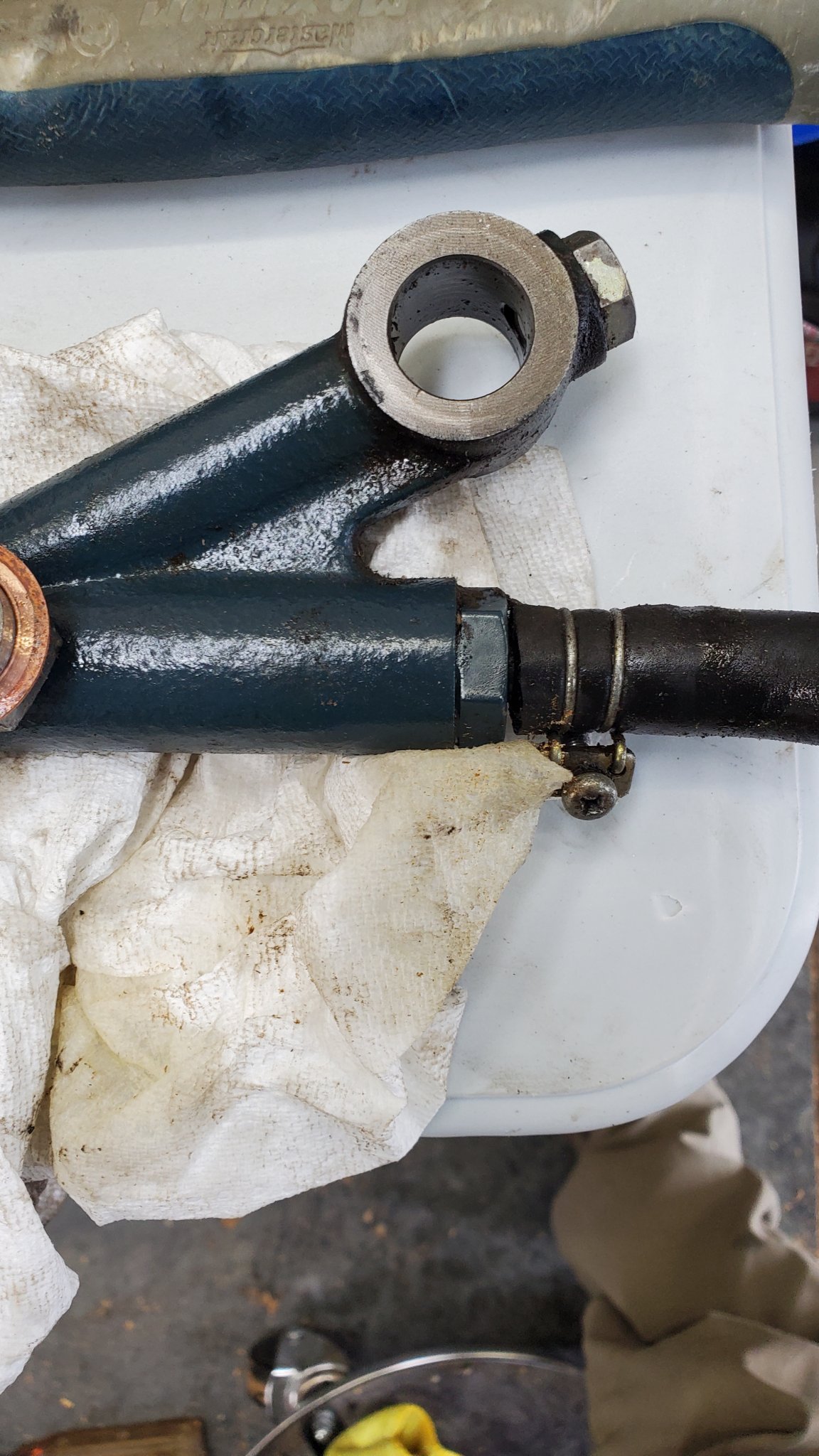

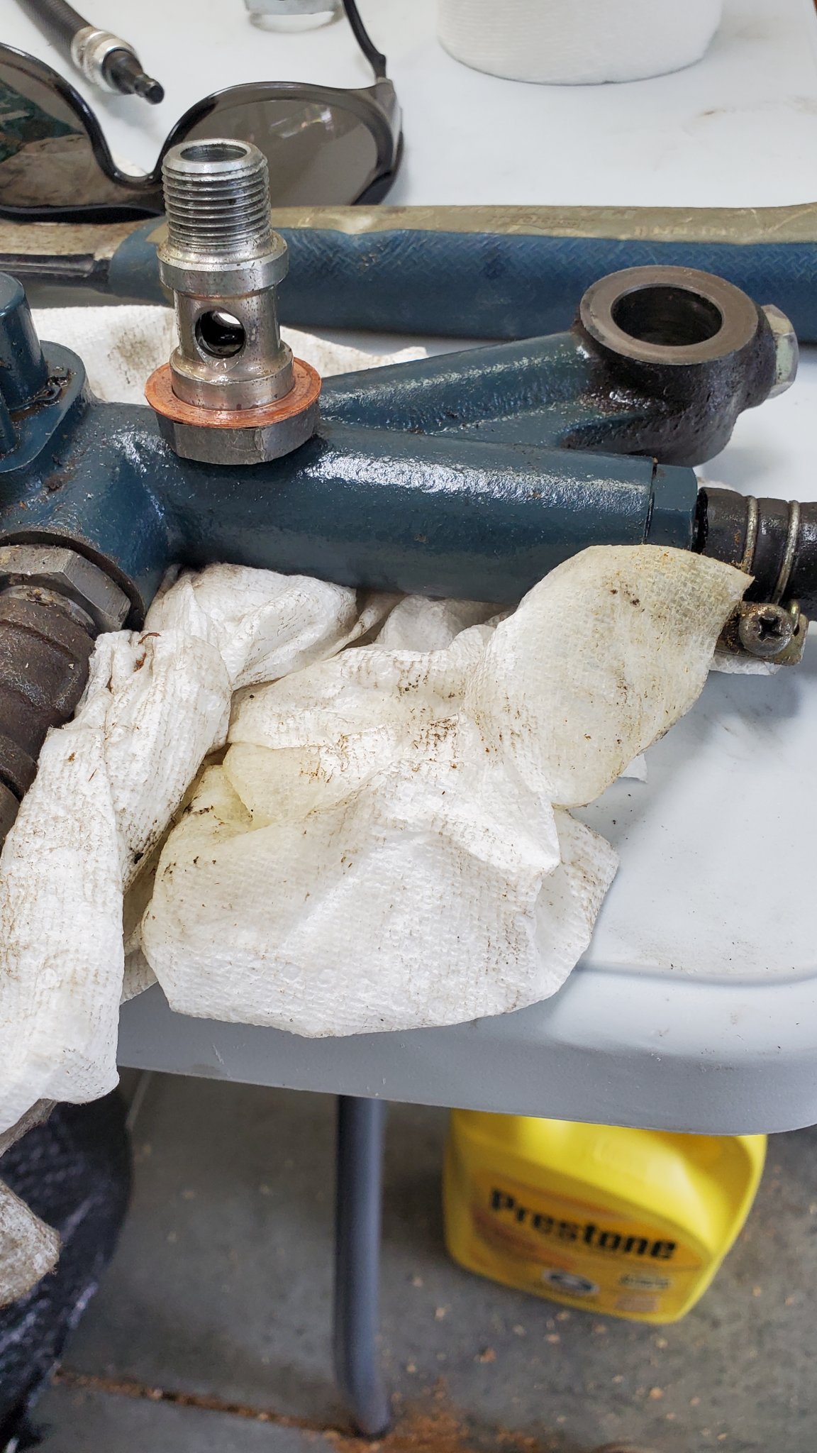

So I Removed the pump and piping, Installed the seal and new O ring kit that I got from the dealer. Re-installed the pump, fired it up and i have a leak on the top side of the outlet. I tired giving it an extra tweak but didn't want to strip anything in the pump housing. Any ideas about this metal to metal seal as there were no gaskets or orings that I saw during removal. Suction (inlet) seem to be fine and no leaks from the body to engine interface. So just not sure if I didn't tighten enough but it think it should have been enough. First pic is mating surface to pump body.
3rd is to banjo bolt. Any insight would be appreciated.
Cheers

There should be two metal crush washers on either side of the banjo. I see one on the bolt - probably the old one. New ones should be used.
