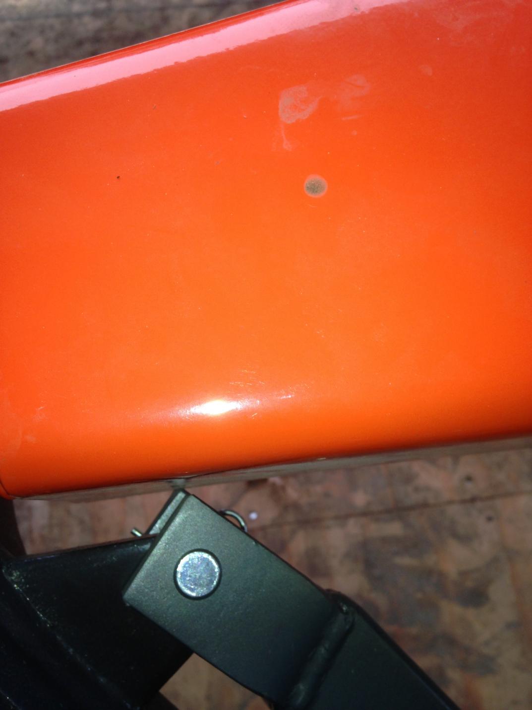

As I raised the 3 point, the corner of the stabilworks nearest the implement (blade) it would make contact with the blade itself :eek:, contact was happening at about 1/2 way between the blade being on the ground, and at full lift. Here is a pic showing the contact:
So looking things over, I decided I had to modify the stabilworks stabilizer, here is a pic of the modification I made:
Basically just had to cut off the corners nearest the implement, ground it smooth, and reinstalled it. Here is a pic of the modified stabilizer installed on the 2370 with blade at full lift
....no more contact! :) I am not sure all would have this issue or not, I am sure you would with this series of tractor and this particular model of blade. I am glad I took my time and raised the 3 point slowing testing the fit of the new stabilizer. I would imagine using it with out modification would have resulted in damage to either the tractor, stabilizer, or blade. I will forward my findings to Mark, as I am sure he would like to know about this issue and modify future stabilizers he makes for this particular series of tractors.
