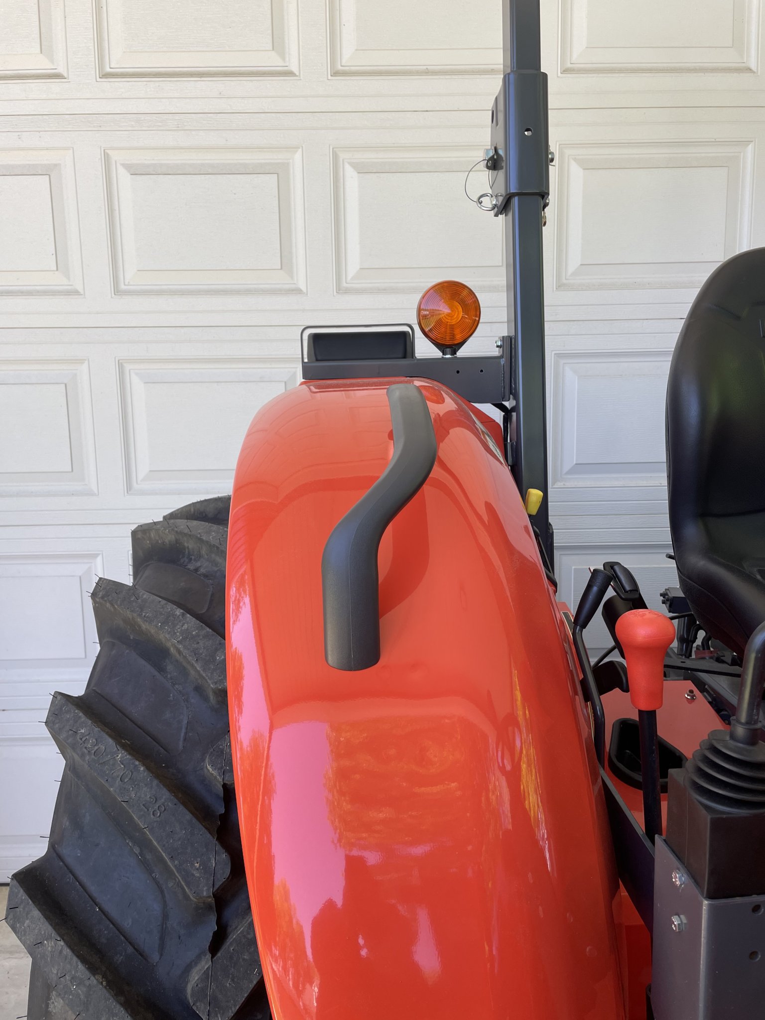

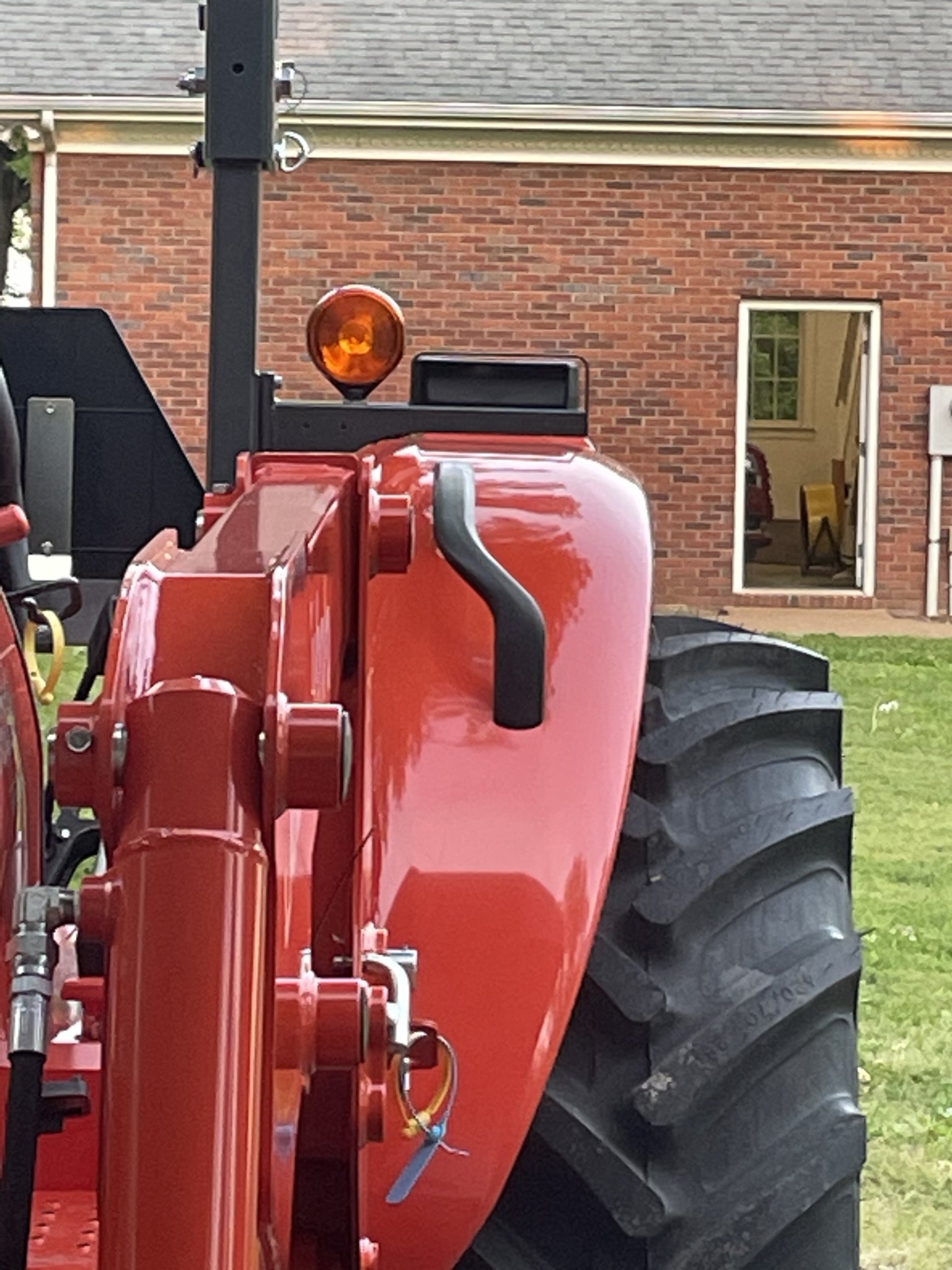

I asked my salesman to add a handle on the right side fender. The M5660 only comes with one on the left fender. I guess the parts man gave the mechanic the only part number that shows up for an M5660, so I wound up with the wrong handle on the right side. Who has put the correct handle on the right fender and what PN did you use?

#3 The left handle on the right fender seems to be common issue for dealers as mine came the same way and I blame the technician for not paying attention to his work. I pointed it out to my salesman and they ordered the right (no pun intended) handle and installed it. I don't have a part number for you as this was handled internally and I didn't receive any paperwork on the matter.

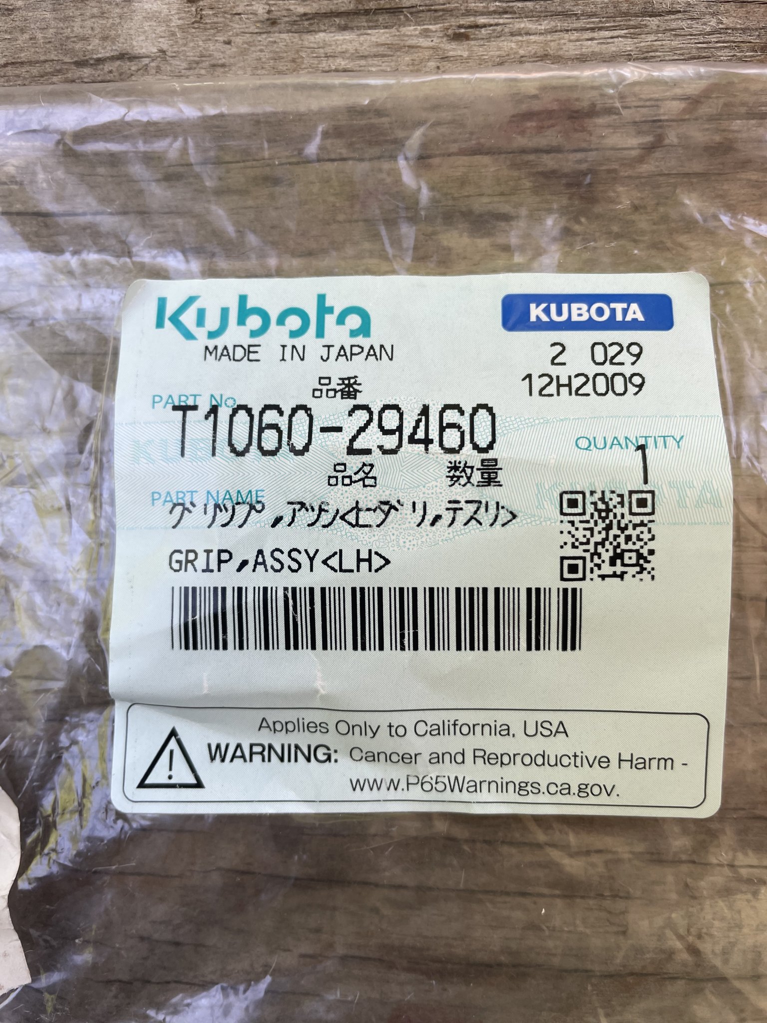

Update: The handle for the right fender on an M5660SUHD is a left-handed handle used in a right-handed application and the handle on the left fender is a right-handed handle used in a left-handed application. Anyway the part number of the handle that goes on the right fender is T1060-29460.

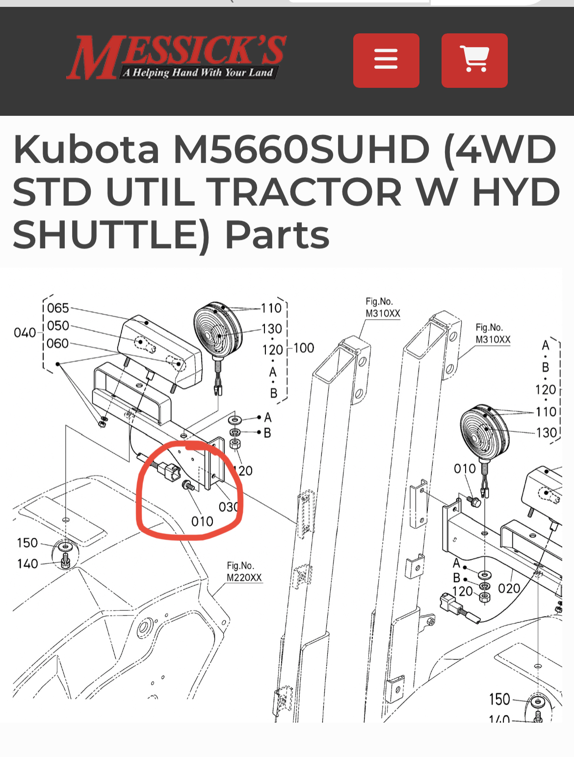

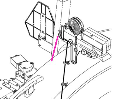

Update: The wrong wires were plugged into the round amber hazard lights on the rear fenders. @mcfarmall sent me a screenshot of the wiring diagram for his M5660 (my WSM is on order). You dang near have to take the fenders off to access the wires underneath the “stay-lamp LH” (020) and “stay-lamp RH” (030) because the bottom bolt (010) for each stay is not accessible except with the fender removed. I was able to remove the bolt (140) underneath the fender and bend the fender down enough to access the plugs.
Odd that the description says LH when it's on the right side of the tractor. Goes against conventional wisdom as to which side of a vehicle is right or left.
It’s used on the left side of an MX6000 and probably a lot of other models. I guess they decided that it worked better on the right side of an M5660. That’s how I figured out the correct part number, by looking at the handles on other tractors on the lot and the part numbers used on them.

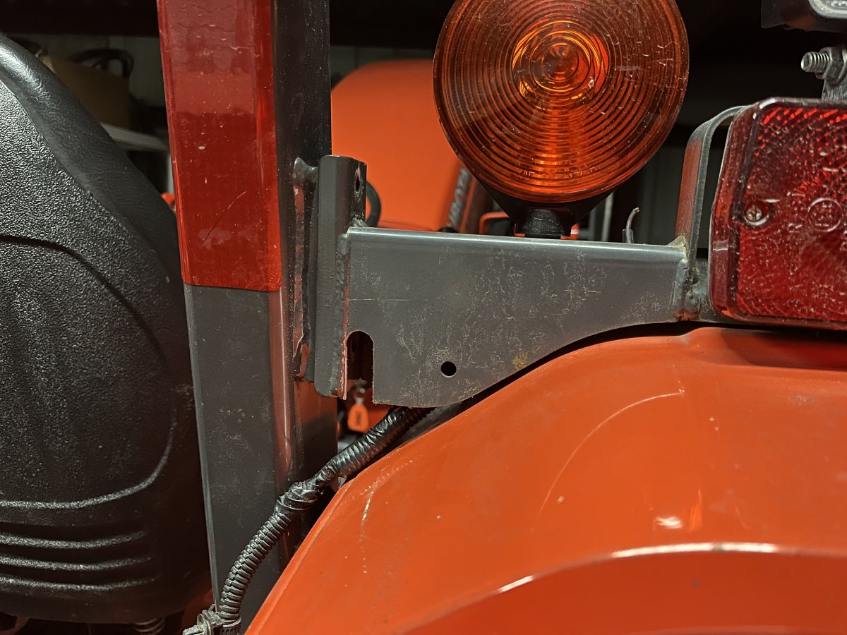

I landed on this thread because I was searching for a wiring diagram for my M5660SUHD. I wanted to comment on this. Yes, that bottom bolt #010 circled in the diagram is absolutely impossible to access with any tools. So if you ever need to replace one of those fender lights or do anything with any of the wiring, you've got to get that bolt out. Removing the fender looks like a lot of work.
I drilled a 1/2" hole in the aft plate, about an inch up from the bottom, then another one halfway between that and the bottom edge of the bracket. Drill them so the edge of the hole is right up next to the weld onto the vertical piece. I then used one of those vibrating multi-tools to cut between the holes. After that, easy access to the bolt with a 12mm ratcheting box end wrench. Doesn't affect the strength of the bracket at all. Much easier to do it on the aft side than the front side. See pic.
Hope this helps someone.
I did this because I was adding rear lights to my tractor and noticed a pair of unused wire connectors under there, so I figured it would be a lot easier to use the existing wiring. This is the same pair that OP's original problem stemmed from; flashers were connected to that pair instead of the other pair with similar connectors. This pair is tied to the lighting circuit, the other to the flashers circuit. And there's already a handy light mounting hole in the top of the bracket above the tail light.
