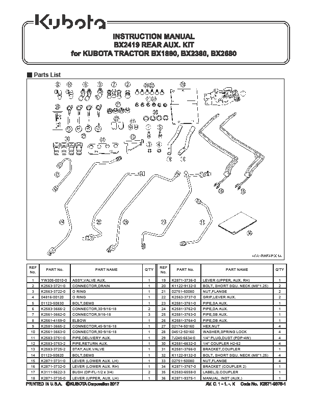

Actually I asked him what the 'empty slot' by the high-low speed lever was for he said dual rear remotes.
I've actually got the install manual for it ,'somewhere' on this PC....will look later.
now is later...

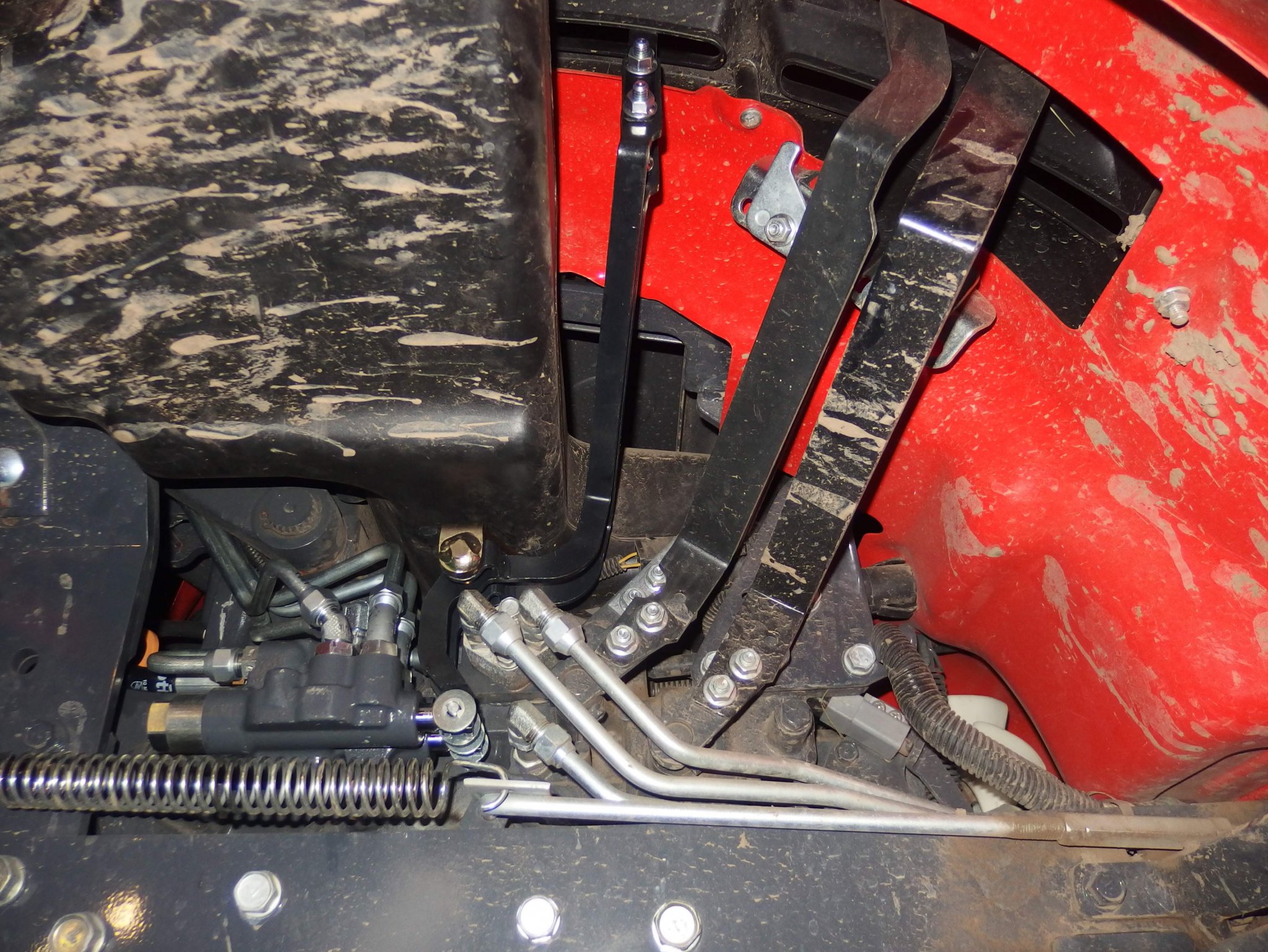

I'm not familiar with the backhoe subframe/mount on your 23S but, if I were to guess, it would interfere with the valve. Attached is a pic of the valve on my BX2370-1.
Hope this helps.
Hope this helps.
Regards,

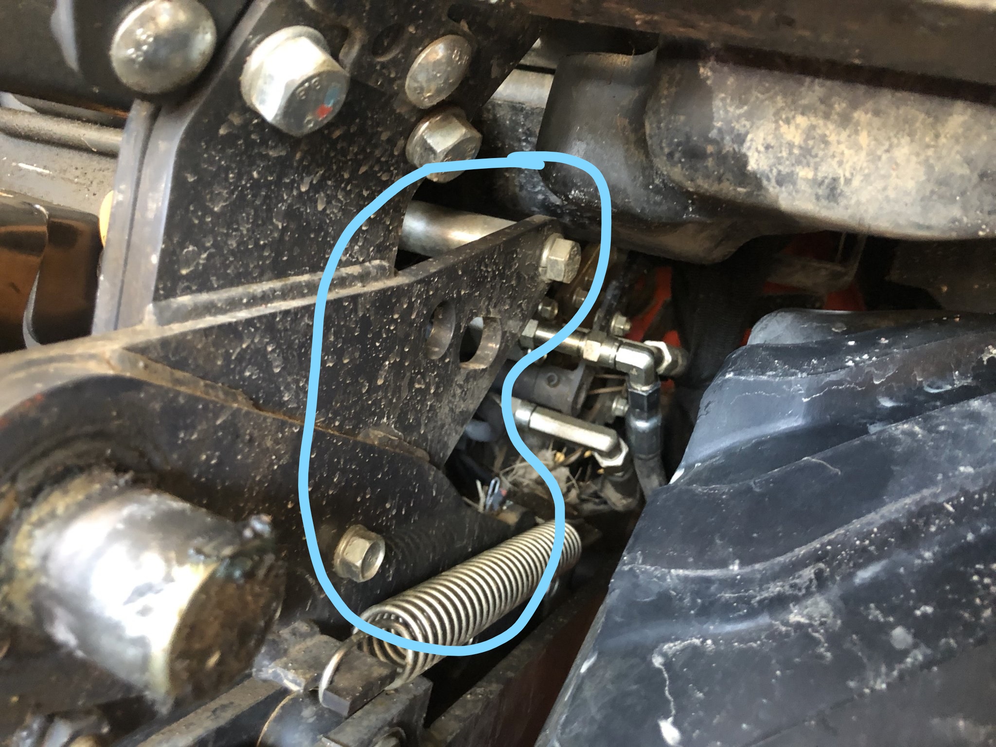

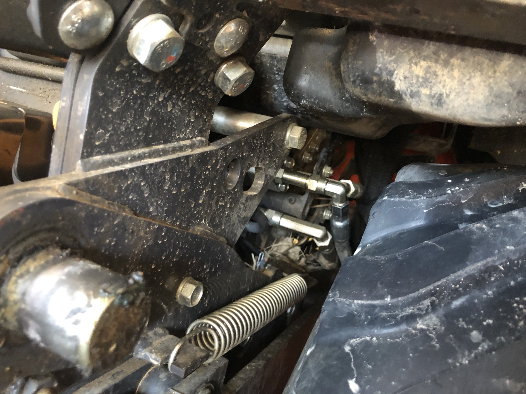

I will need to take the wheel off to get a better picture. This is a 2020 model
likely the hoe brackets highlighted will be your issue with the valve and linkage clearance. Nothing you couldn't overcome with a few custom bent hard lines. Though, the linkage could get interesting. When i bought my kit, it was cheaper to get the whole kit than just the valve, go figure!
