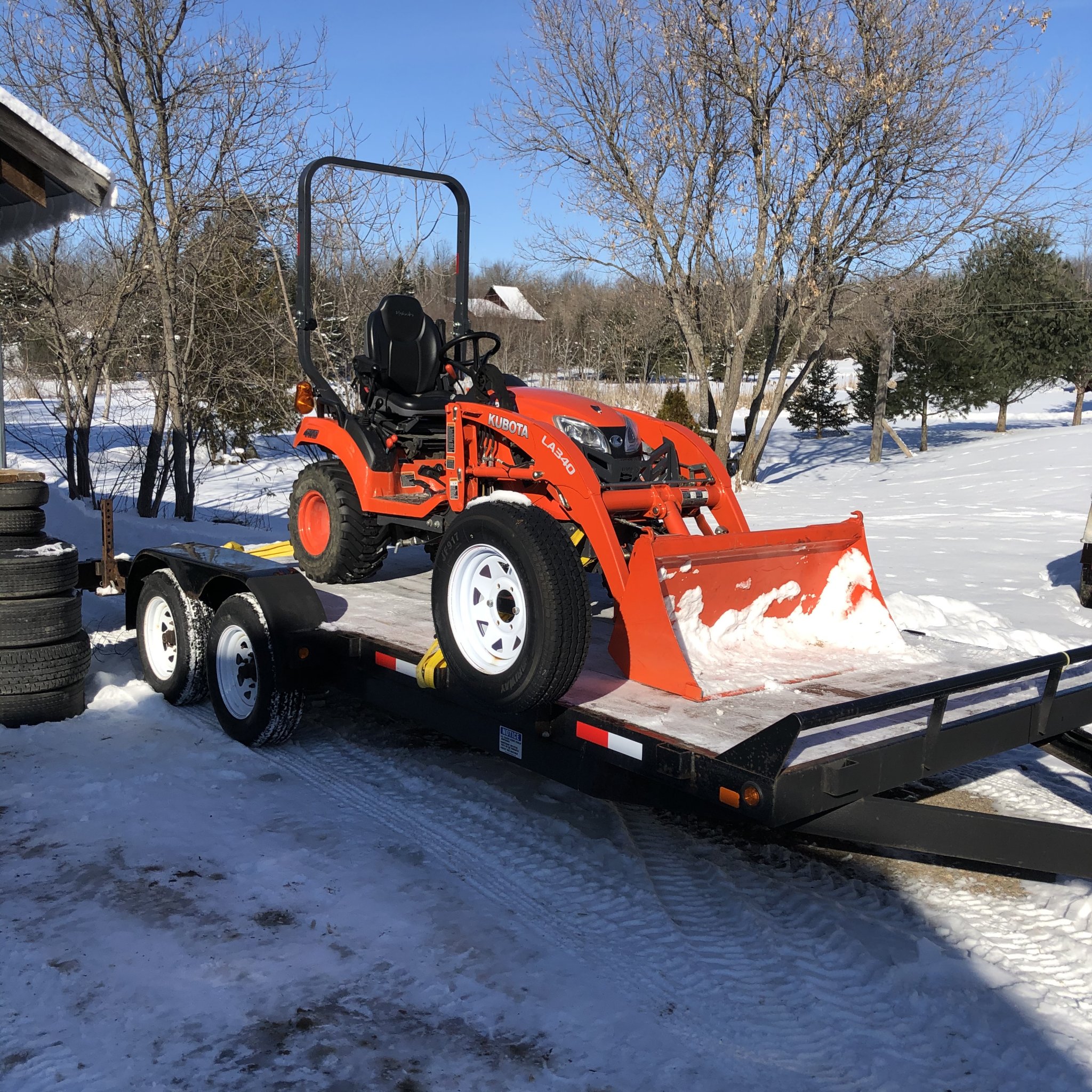

Loaded up. Dropping it off at the dealer after work. First time it’s been on that trailer. Just bought it a week and a half ago.
anyone know why they don’t build tie downs into these small tractors? My hook straps aren’t a big deal on the frame members but it’s corner to corner and not cross tied like it should be.

Don't know, probably due to the added cost...for something most owners probably do not need.
I see you are in Canada. In my state as far as I know the loader bucket (and backhoe bucket if there) must also be tied down to the trailer. Maybe someone can correct me if this is only for larger machines...Pennsylvania here.

i didn’t put the loader strap on yet. I had a few frozen ones from being in the back of the truck. they are in the basement drying out. We have to tie them down as well.

I made front tie downs, mount in two holes on the frame. Used once..then sold trailer...oopsy... Maybe Princess Auto has some 'D-tiedowns' that'll bolt on ?

Crash, you need LED's on that ROPS!

I agree that tractors that require binding to be transported should have provisions for that. It would be safer and cleaner than the average Joe's "guess" on where it would be best.
In the US equipment (over 10,000lb.) requires 4 binders. With "attachments" the "attachment" also needs to be strapped (how many depends on the weight and length of the attachment). After that every 10' in length add an additional binder. A purpose built loader bucket is not considered an "attachment" however a removable loader (like a lot of tractors have) would be.
Under 10,000lb, two binders. They do not go into "attachments" and securing attachments that I could ever find or get definitive answers on under 10,000lb. In that case they could default down to cargo rules.
I really hate guessing about this stuff and have spent a bunch of time looking it up and talking to a couple troopers as well as state DOT guys. None of them could state things definitively.

Well, at least you're in good company. They don't offer them on the larger L series or the MX either. My first project on the new MX5400 I picked up last week will be adding tie down points.

as soon as the hardware stores are open to actually go in, I will be picking up some U bolts and brackets to install my lights. I have them already. Just can’t get the hardware I need easily.

thats ridiculous.
