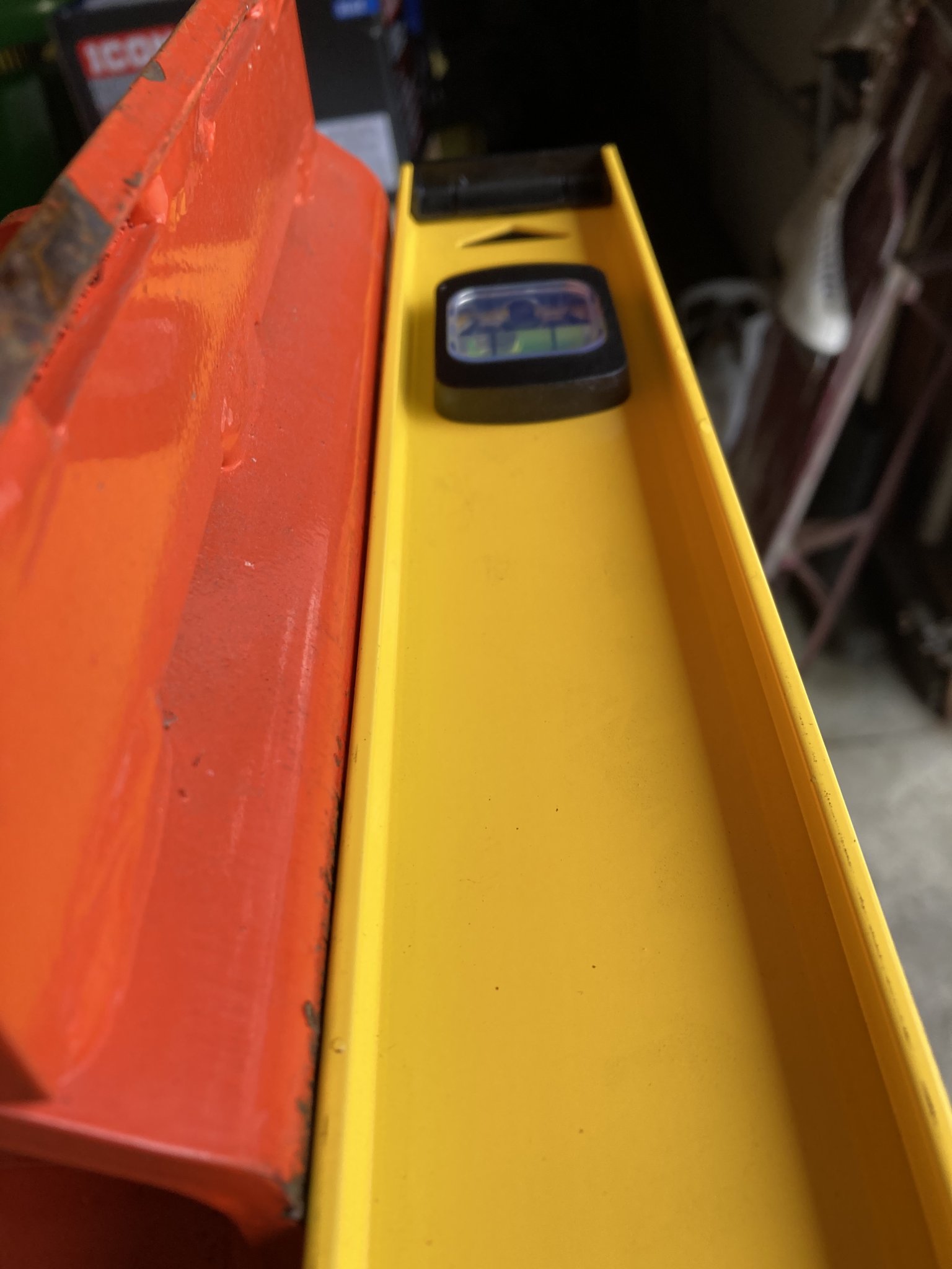

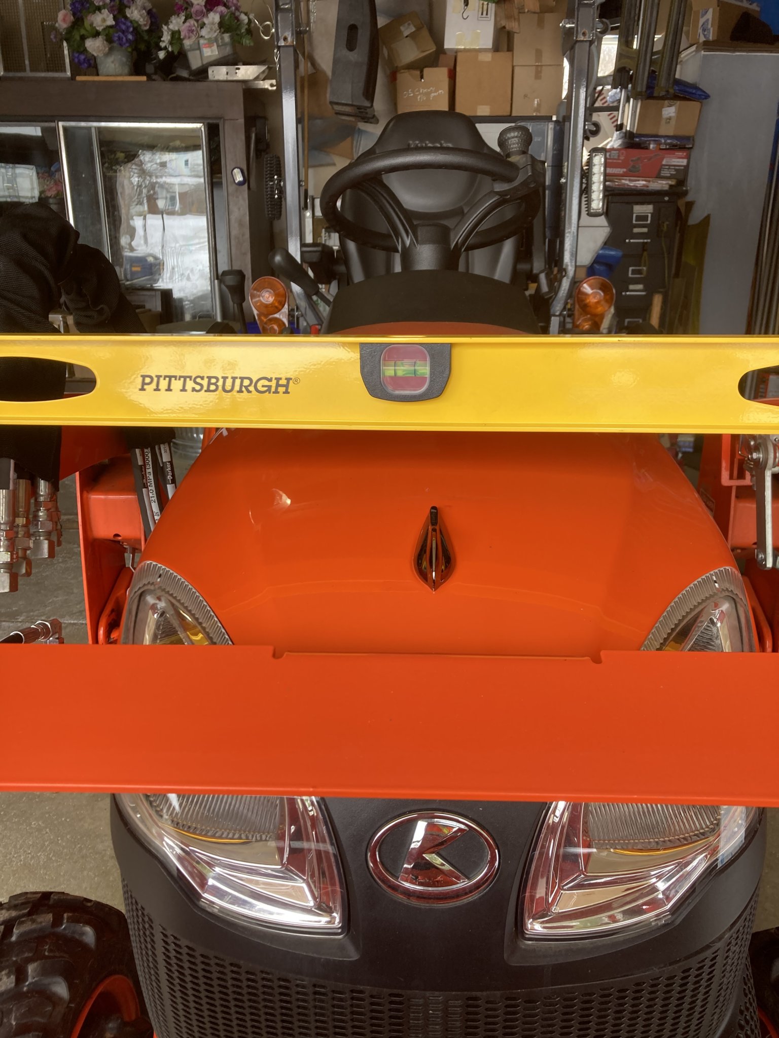

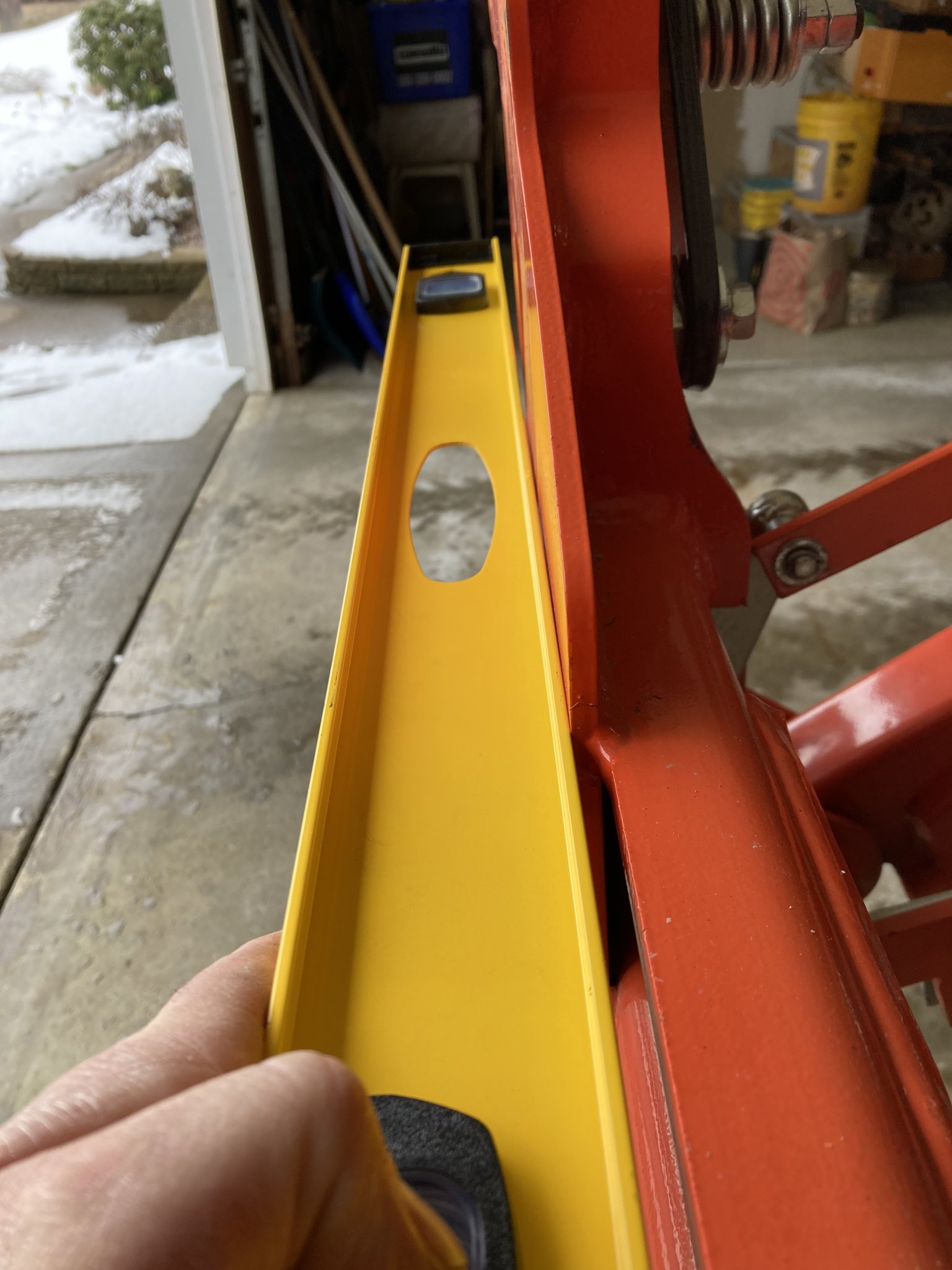

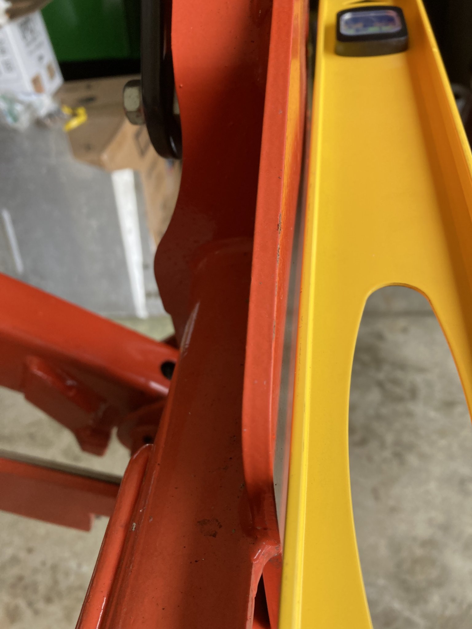

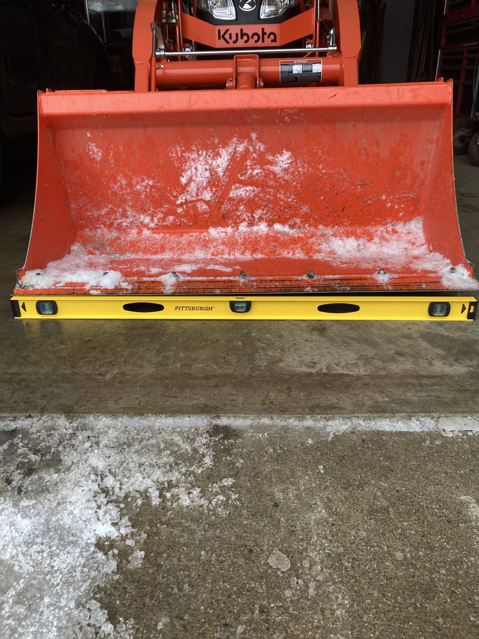

There’s some pics on 2nd page of this thread with bucket off. The ssqa plate has looked bent back slightly on left side. When I pointed it out to tech at dealer last June when it was there, he pretty much dismissed it. Right now the R14T tires are on it. I put 24psi all way around. I put the level across my garage floor, looks good to me. I need to get one of those tape measures that people who sew clothes use, so I can measure circumference of tires. Set of R4 tires that originally came on tractor were way off, 2 different years IIRC for the 2 rears. Dealer adjusted to the turf tires in June, their fix was 17 psi in right and 20 psi in left tire….first pic is rops bar, 2nd is top of bucket, 3rd is across loader arms…

well your floor's level, loader frame isn't ( bubble high on the driver's side )
re ssqa on 2nd page... yes, something is wrong there ! it should be FLAT or parallel to the floor
really need to measure ..here ,there ,everywhere to see what's wrong

Thanks for the pic's they helped a lot!
The issue is not in the tires or the loader arms or loader mount.
It's in either the SSQA attachment on the end of the loader arms, the SSQA plate on the back of the bucket or the bucket it's self.
If you would do a couple more with the bucket off.
Level across the loader arms again and level across the tops of the SSQA attachment plates.
And just a picture of the back of the loader bucket.
Measure from the front of the cutting edge to the front of the back of the bucket, on both sides (right and left).

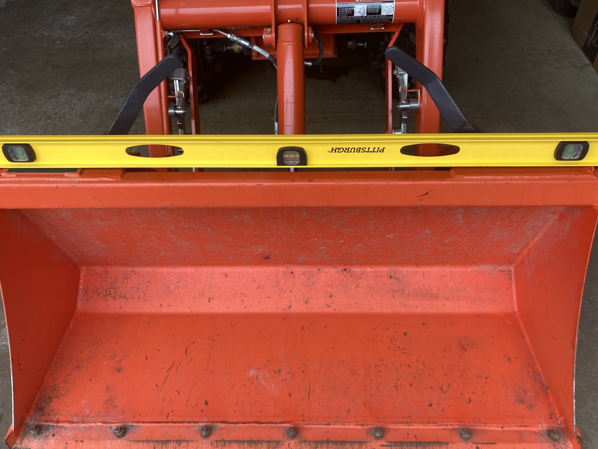

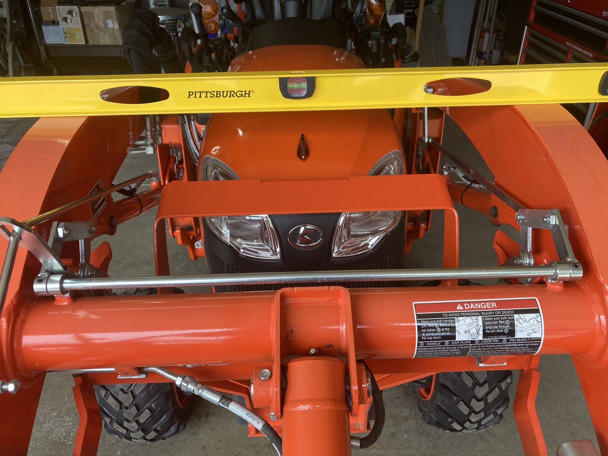

Forgot to get picture of rear of bucket while it was off. Measured circumference of all tires, each put at exactly 24psi. Rear tires- right- 81-1/8”, left-81-5/8”. Front tires- right-57-1/4”, left 57-1/8”. I forgot to measure axle to ground distance, do that on next day off on Friday…

I need a picture of a level on top of the SSQA latch plates and a picture of the level on the loader arms just behind it to compare the two.
Picture of the back of the bucket and measurements from the cutting edge right and left to the front edge of the bucket top. Maybe middle too.
The faces of the latch plates have no bearing on the bucket being level.

My thinking was that if the left side of ssqa plate wasn’t level with right side, that wouldn’t allow bucket to fully seat into slot. My snow pusher does same thing, not sure if it’s worn any now being I have the poly edge…

May also put the turf tires back on ( what
have you ever checked to confirm your level IS level ?
What does that have to do with the actual gap of bucket meeting ground? I'll try another level , but unfortunately it's another Pittsburgh one :ROFLMAO: :ROFLMAO: :ROFLMAO: ....
12,995
5,717
hmm, i've only seen a level in the pix, no tape measure with numbers
35 years ago, I found out that my $$$$ level was NOT level, after an addition was built
since then I check every level anyone hands me to use
