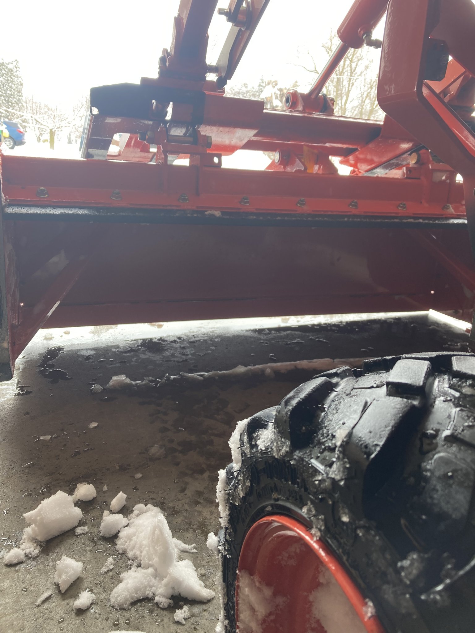

New BX2380 bucket meets ground unevenly....

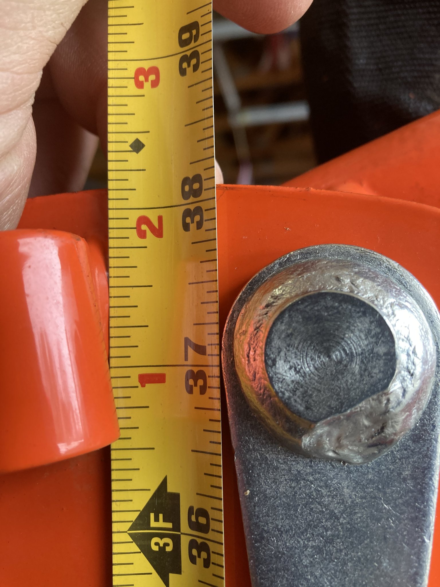

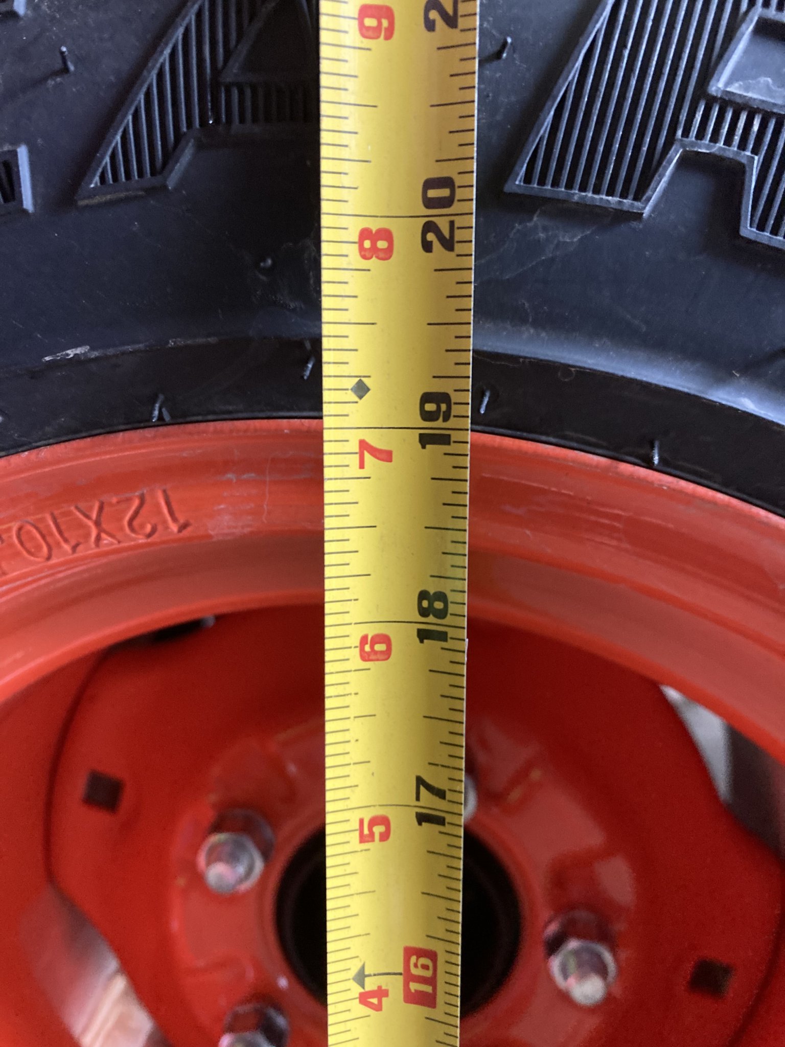

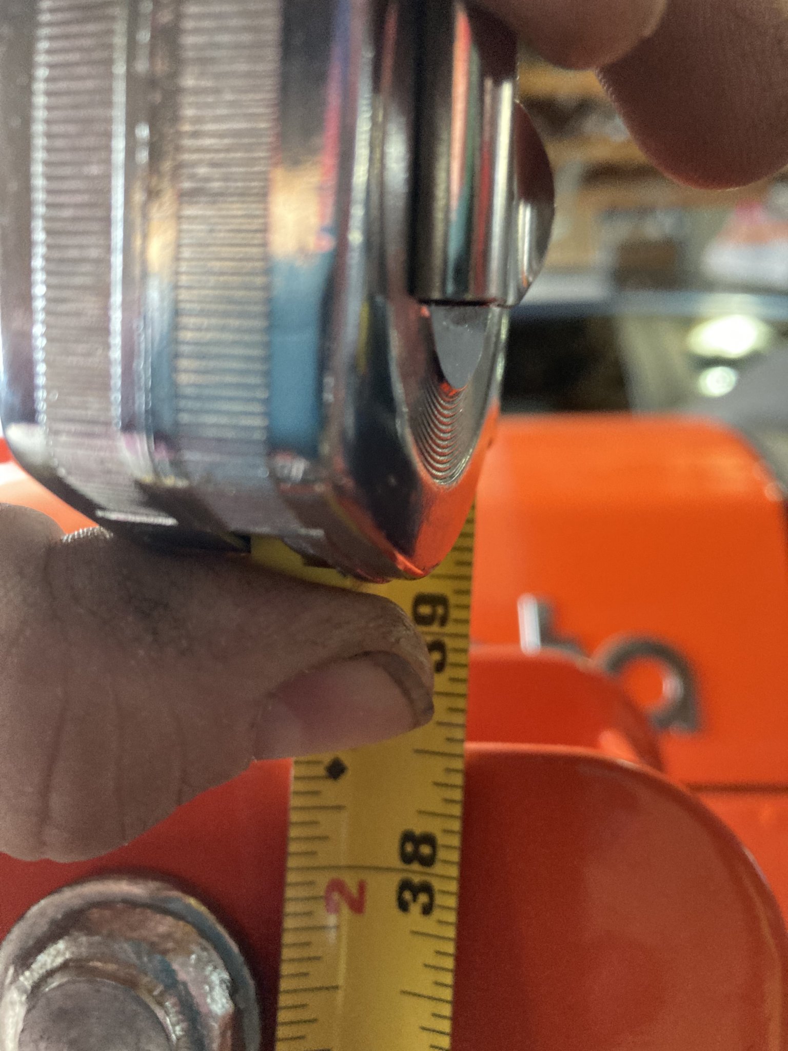

Left side measurements, tape measure edge on floor

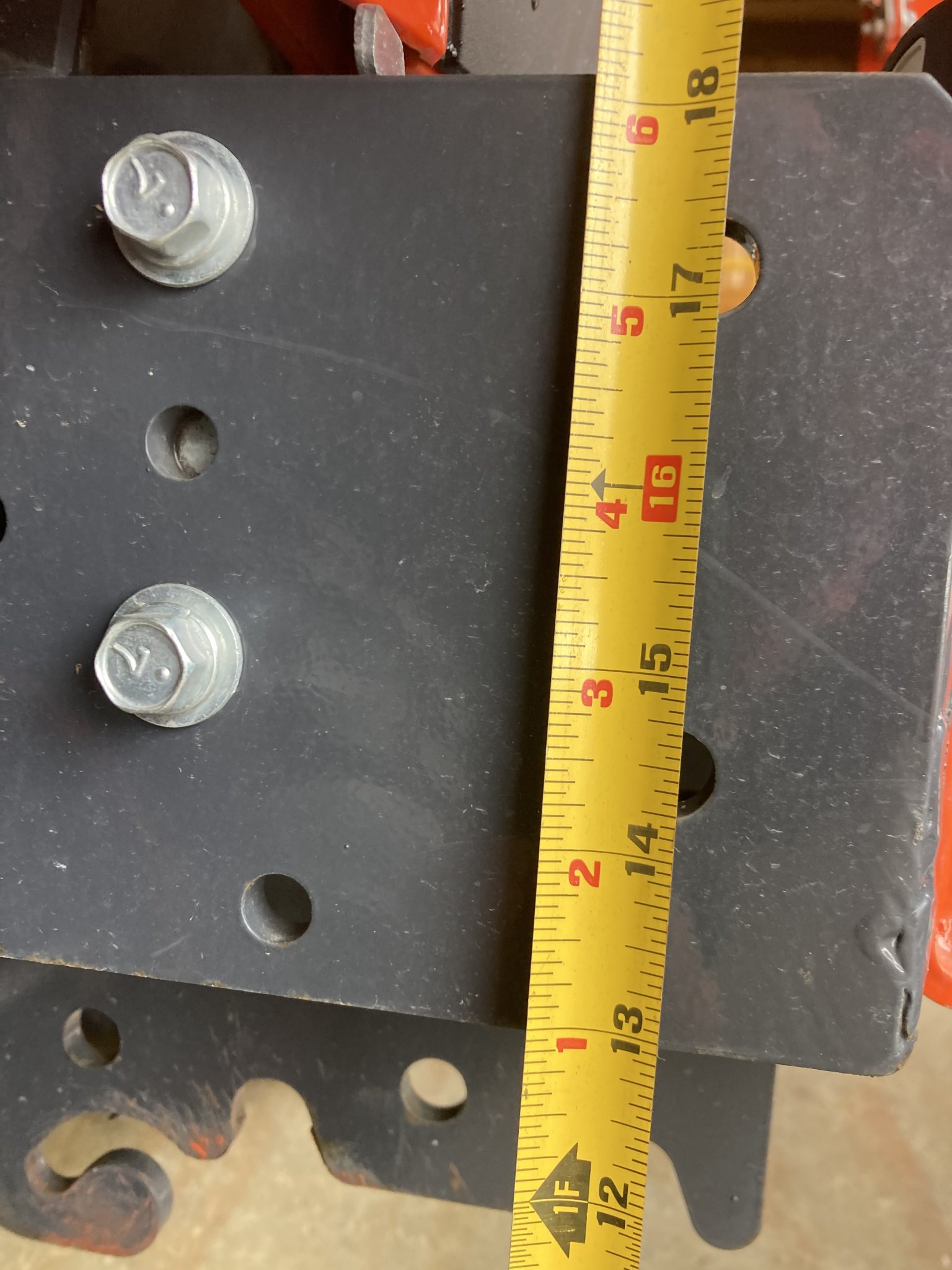

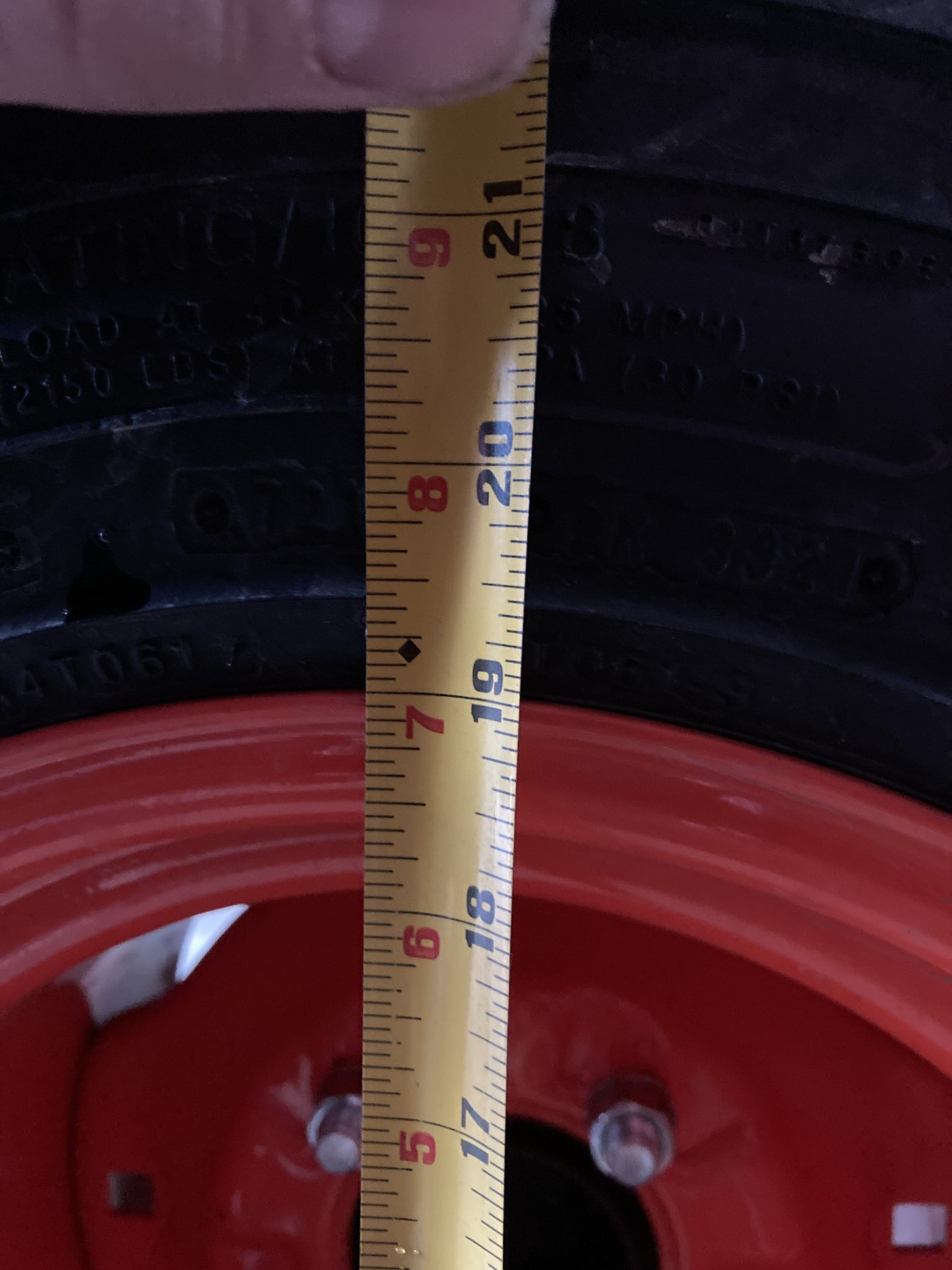

Right side measurements, tape measure edge on floor

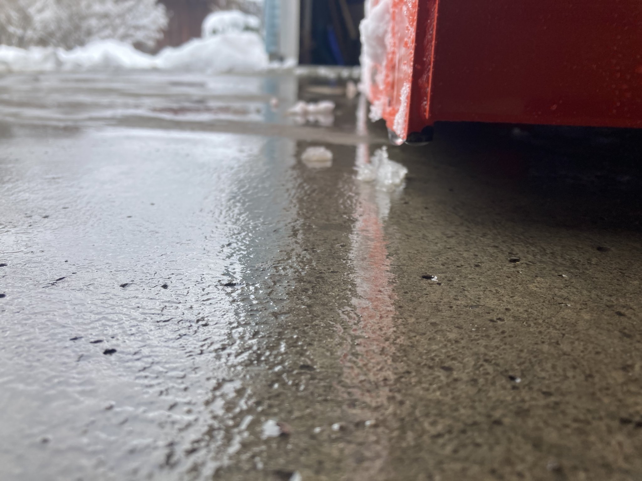

This unevenness REALLY sucks with snow pusher, especially when back dragging. Extra pressure on right side to make edge level hard on the blacktop 😡😡😡😡
12,765
5,554
my guess based on the last picture is the left side loader frame is 1" too high, or right side is 1" too low.
if you can keep the bucket as is, loosen the left frame bolts, it might slide down a bit. If not enough, tighten them, then loosen the right side,then raise frame up a bit.
I don't know if there's slotted holes for adjustment , but there should be something.
I don't think the SSQA plate is wonky, as you can get box /bucket on-off ok ?
hmmm.... where the loader uprights 'slide in and lock'...... Are the tractor sections the same height off the ground ? Nothing in the WSM about 'installing loader frame onto tractor', probably cause it's factory installed...but if that piece was high, it'd raise everything high....
I don't know what's involved with the latches to remove the loader frame but maybe it's adjustable ?
I've never had mine off ( or the backhoe) so I'm looking at this from a mechanical point of view.
I do know mine's level, spent 4 hours bucket scraping 11 neighbour's driveways......

Tractor frame is same height both sides. The bolt holes for the saddles that mount to tractor frame are not slotted, so really no adjustment. I have loosened the left saddle from tractor, as soon as all bolts are loose, bucket goes level. Last year I did the loosening of both saddles and tightening of them, didn’t make a difference. Nothing is an inch off anywhere. In the pics in earlier posts you can see what difference is from side to side. Might be something to do with latching system of loader, don’t know. When I put bucket on ground all the way, the left loader tower that sets in saddle rocks backwards quite a bit, not much movement on right side. I’ve put countless hours on this machine idling it trying to get this goddamn bucket to be level but to no avail.

dang, ..so quick recap...
tractor is on flat,level concrete
tires are all same
air pressure's the same
left and right frames same height from ground
loader saddles(mounts on tractor) are same height
bucket or box is high on the left side
with the tractor in the last picture....
measure several points starting at the loader /tractor attachment point.
bottom of loader frame where it locks in
top of frame, pivot point
frame arms at back,mid, front points
SSQA plate bottom and top
I know PITA to measure all these points but going from the frame out, each pair of measurements should be the same. When they differ by the inch, THAT is where the problem is.
