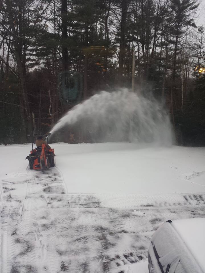

Last year I was fortunate to find a front mount 63" snowblower that was designed for the B2710 and I bought it immediately! I cannot believe the difference! No snowbanks, the snow is blown 50-80 feet away! IF YOU LIVE IN NH, BUY THE SNOW BLOWER YOU WILL NOT REGRET IT!
My next project is creating some type of enclosure (I don't want to spend $2,000 to $5,000 on a cab) that will keep the blown snow off of me. I have already mounted a canopy with new work lights and now I am working with my wife on creating the clear vinyl sides mounted to the canopy and held to the tractor with rare earth magnets. All total I will be into for about $275 for the canopy and $3,500 for the snowblower with a new subframe.
