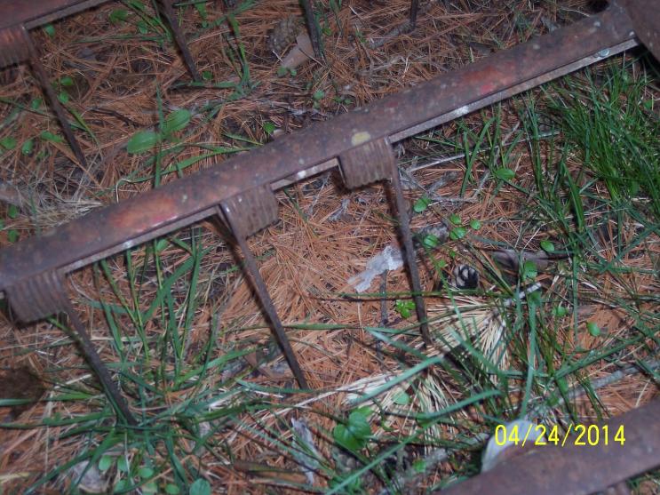

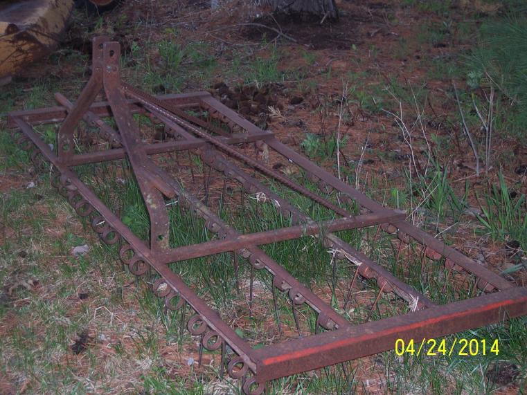

Your chain link fence should work OK for leveling small clods. If you've got some old chain link fence don't cut it off to four foot lengths, just fold it over on itself. Just extra weight and more iron to grab the dirt.
Your biggest challenge, I think, will be the pine needles. They're hard to rake when they're packed for a few years. A rock rake would work nice.
Here's what I made from an old baler pickup reel. Works excellent for what you're doing, and planting. The pickup reel from an old square baler works just as good as a big round baler. If you don't have any old junk farm equipment around, put some weight on an old box spring and drag.

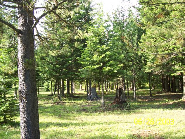

DSC04213.jpg [/ATTACH][/ATTACH]
here's what the area looks like. lots of rock, I think the PO cleared the lawn area and placed extra rocks out here. The area near the shop is a little more open, Ill go out and fire up the chainsaw, and start limbing. The ground is pretty rough, so I made need something a bit heavier to help level out the ruts.

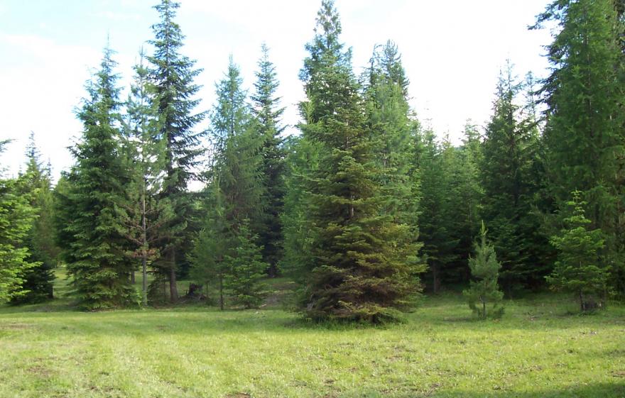

As I stated in post #10, here are some pics of what I dealt with.
