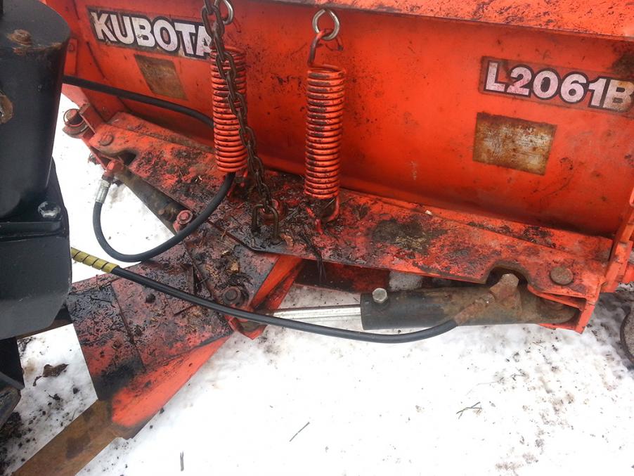

I bought a used L2061B snowblade for my old BX2200. It has obviously been remade at least once to fit various tractors and it included a power hydraulic pack which is need for my BX, since there is no auxiliary hydraulics on it and this would be so much easier for me. All the cylinders worked on the unit when I bought it but there was an obvious problem with speed of the power unit. It turned out the solenoid was corroded, sending a poor current to the motor, so that was replaced. Now, everything works great EXCEPT, I cannot get the blade to turn right. It is supposed to have: power up, gravity down plus power left and right with a total of 3 cylinders.
I've spent hours on this and need help. I disconnected the hoses to the left & right cylinders and they are not seized. They turn either way without power.

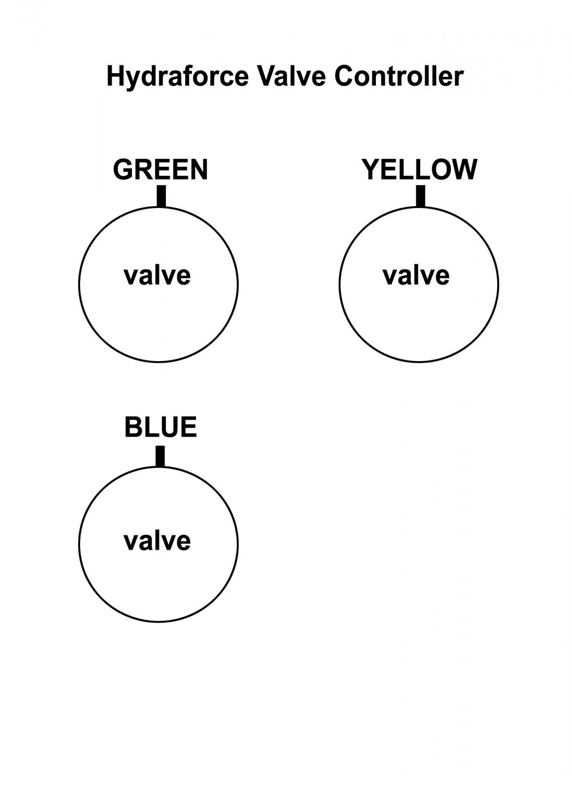

I have tried switching wires, even though nothing was changed, just leads cleaned and replaced where necessary due to corrosion. All wiring has been checked for continuity and all is good. It can't be the solenoid otherwise nothing would work. I've attached wiring diagrams and photos and would appreciated your help. The empty plug on the left/right switch seems obvious but it was never altered and no wires were removed.
Yellow allows blade to go down
Blue
Green
Orange 12v to solenoid switch
White 12v power to hydraulic motor

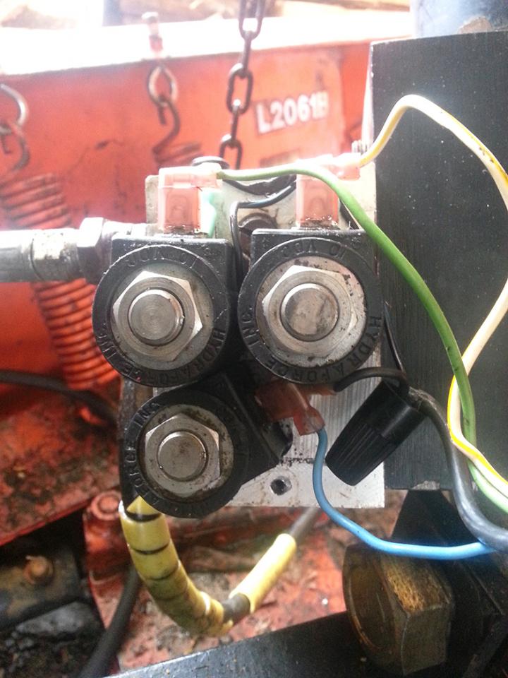

Have someone run the functions and test for magnetism on each of the coils. If one is not magnetizing try swapping solenoids to see if another function goes south.

If coils are working and electrical is OK, under each of the electric coils there is a valve. Take the nut off the top of the coil and it just lifts off. The bad one will be hard to get off. The turn valve is probably damaged. If you hit something hard and the pressure relief doesn't act fast enough the valve takes the hit. It will be bulged and needs replacement. After the coil is removed the valve can unscrewed from the body for replacement. Change the oil with a synthetic transmission/hydraulic fluid of your choice.

By the looks of the pictures, I can just see the corner of the pump/motor and it appears to be a Western electric/hydraulic snow plow pump. If that's the case I would suspect the valve that's by itself (the lone one). If the coil is strong, clean the valve and see if the valve moves a bit when it's out.

From the picture i can barely see the pump but it looks like an old western pump. Its either left or right that does not require any valve movement to operate just the motor to run. Does it go left

It is a western pump and id look at reliefe valve bc to go left you have to use the right valve and coil along with another the one the one for raise. So if it goes left then that valve should be good.

Have someone holt the controller to the right and see if you are getting 2 valves to magnetize. Use a wrench and hold it inside the nut that holds the coil on and if there is resistance to pull the wrench off then both valves are working and it wouldnt be a controller issue. Have you tried pushing the right side of the plow into a tree while holding the controller right yet? This will see if the crossover relief valve is stuck. A cylinder is a cylinder so i wont matter if they are kubota or western. As for the meyers on another site the valve to test there is the green wire pull the coil and use 1 1/4 socket to remove the valve with a small screw driver put it in the center of the valve and see if the plunger will move in and out if not then the valve is bad if the coil is getting magnetized. If there is a way to send me a private message i can give you ky number and help you out. I have been working on plows for the last 15 years and known them inside and out.
