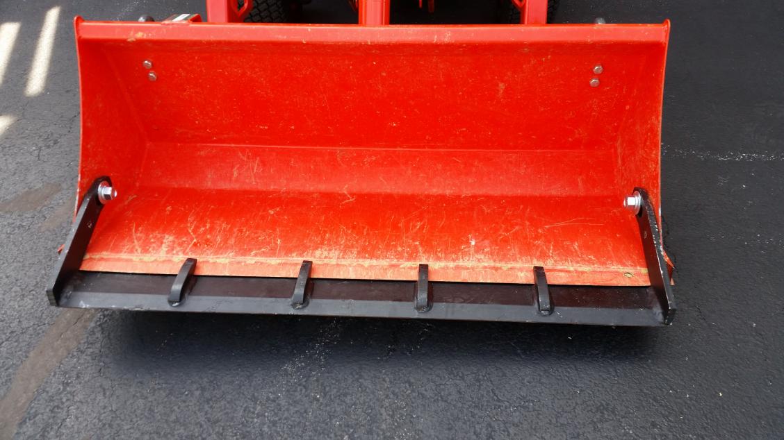

Check mine out it works as we all want them to and it's on it's 4th or 5th winter and still looks good. I used 1/2 inch black iron pipe welded directly to a piece of flat stock 3/8th's thick standard grade steel. The original cutting edge is hardened ( at least it appeared to be much harder when I hit it with the file to test it ) and being it was in experimental stage I didn't want to screw it up, marked the new piece to match the holds in the original one drilled them out then welded the 1/2 inch pipe directly to the new edge keeping it as close to dead center on the middle of the edge as possible. Cleaned it up and give it a few good coats of paint and bolted it on. Now before I go any further it appeared that the angle of the blower was wrong or pointed to dig in at to much of an angle so I loosened up the bolts and tipped it backwards so it wasn't pointed down so far where it tended to "jab in" then tightened it back up bolted on my modified edge.
It works awesome! No more nose diving into the ground just enough round radius to roll over instead of catching on every bump or lump. Before it was peeling sod like a loader bucket on a mission and now it sort of glides over everything but mole hills that need shaving off anyway. I do an area in my yard to the side of the house that's 20' wide and 125' deep then behind the house 40' wide and 100' long plus some big pathways to be able to get to the car hauler or storage semi trailer and my yard is rough the opposite of a gold course for sure and none of it is tore or skinned up.

....Cleaned it up and give it a few good coats of paint and bolted it on. ..
Think we know what your describing but for shiatz and grins could you take another pic or two? Since you painted it Kbota Orange the pic presented makes it hard to see your Fabrication except maybe someone that has a memorized mental picture of what a bucket edge looks like.
