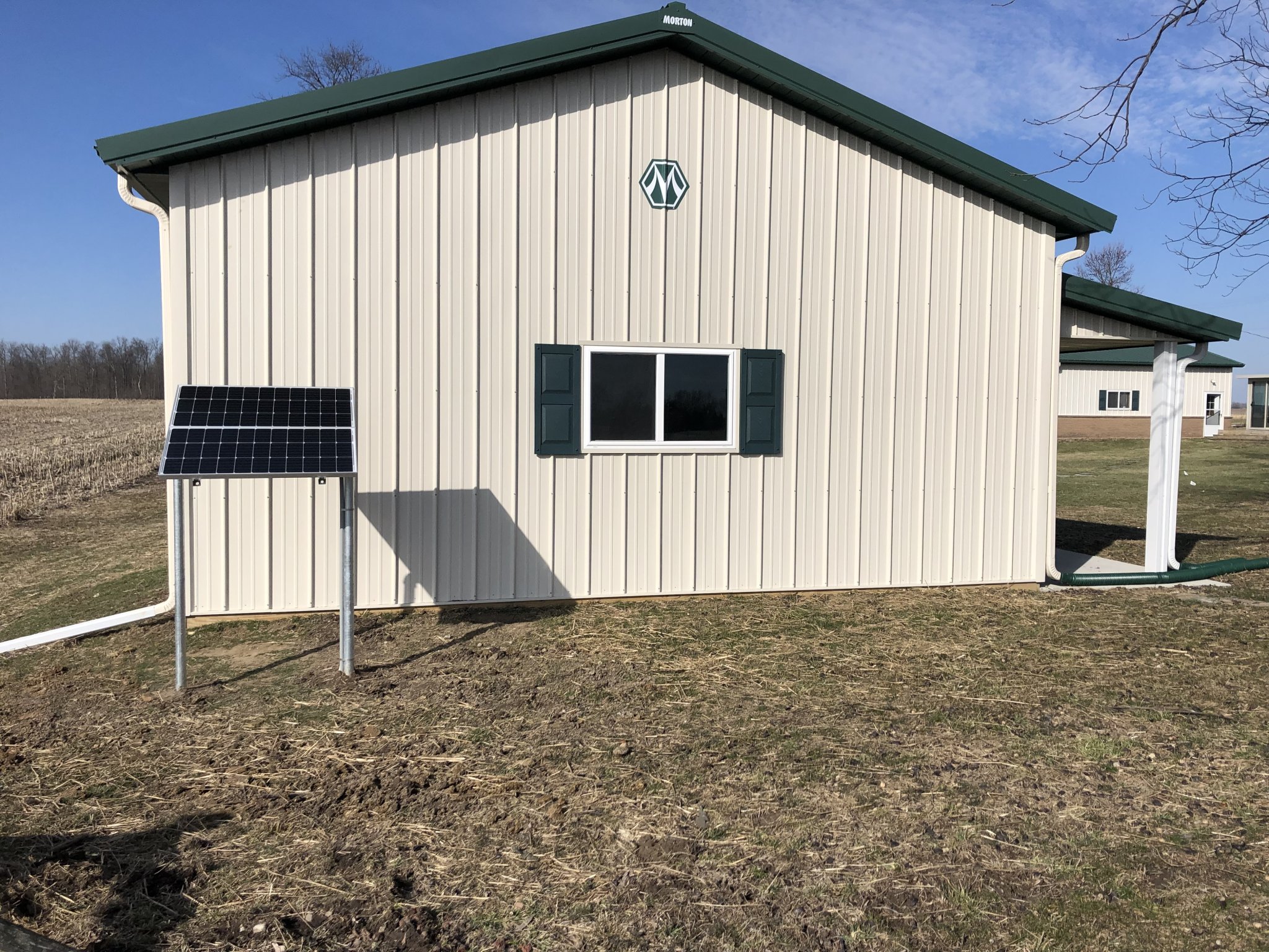

BXHoosier
BX24
Jan 21, 2018
492
572
Indiana
My experience with Morton went well. I sent the local shop an email and had a response within a couple days. Luckily, I had my building built in 2019 before the world went crazy and prices started to skyrocket. They built it in the same colors as my existing Morton garage that was built in 2000 by the previous owner. At least in my area, Morton does not install overhead doors. I bought the doors myself from a local door business and installed them with a friend’s help.

@BXHoosier what dimensions are your shop? I think that's a perfect size for a secondary shop ( I don't have a tone of space without taking down more trees) but it adds a nice look with the porch!
It’s 24’x24’x10’ with a 6’ porch. The doors are 8’x9’ and 12’x9’. I would have liked to have gone 24’x32’ but there’s a perimeter drain for my septic system about 6’-8’ out from the doors. I hooked up a 200W solar setup with 12V lights and to run an inverter for 120v power. My other Morton building is visible in the background.
Reactions: 7 users

@BXHoosier that I think is the winner. I have a Triple attached already however I’m running in the same boat as you with grade elevations, trees and property lines. That inverter concept is really slick, when I built I brought 400amps to the property, with 200 to the house and another 200 for the future shop.
The porch is tastefully done. Great work!
