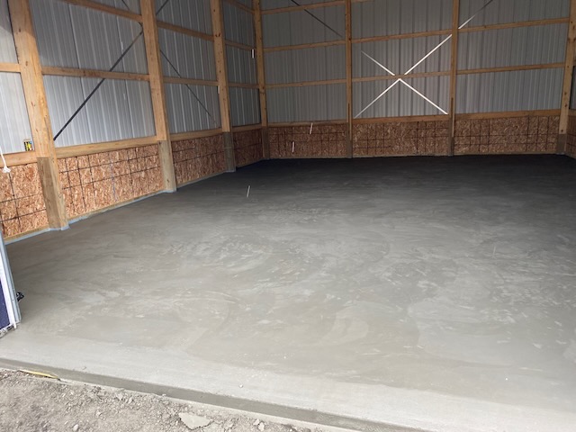

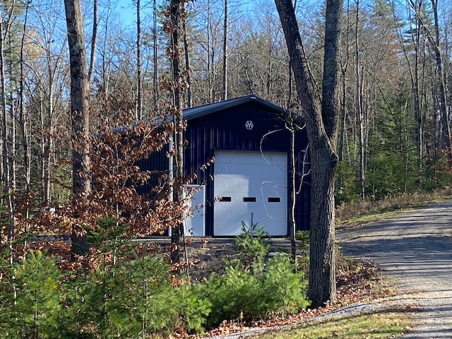

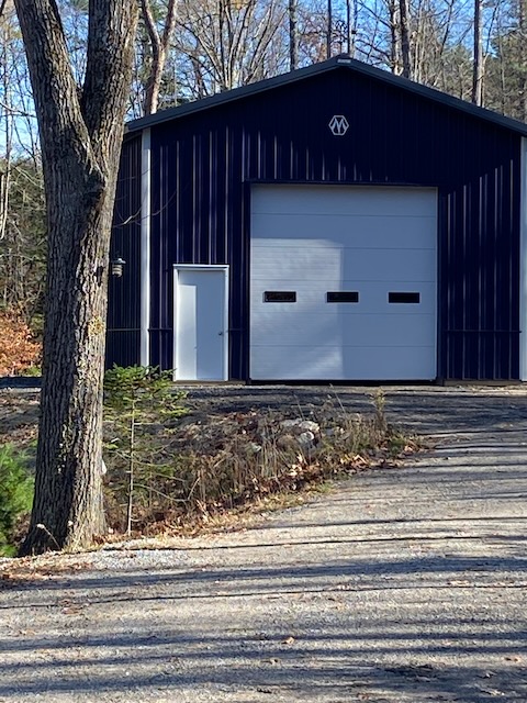

Well.......we finally got here.
Cement floor was poured today......it had some wild moments but overall it came out well. The second truck evidently mixed in more calcium carbonate than they should have so there was a little "urgency" to some of the work. There was also about 2 yds of cement "leftover" that was piled up wet outside the door that the contractor and I teamed up with the B2601 to take about 6 buckets of wet cement out back and dump.......I didn't have a great plan for extra cement. I ended up making a small pad off to the side of the yard that I can drop the pallet forks, box blade etc. on for storage......I flattened it out with the tractor bucket then tamped it down with my hand steel tamper......glad I had one.
Came out well overall. Gotta let it sit for a couple days and dry before putting some "stuff" in there.
I also need to think about what I want to spread around outside the building to raise the grade a touch......gravel, stay-mat etc
EDIT: Just looked back at my original post.....May 25th.....so roughly 6 months to the day from start to finish when I gave my deposit and then through the site work, inspections etc. Targeted a budget of $50K and came in at about $57-58K for those who are interested.

Too late now but for others...... I use a 2X4 or better a 2X6 of the most rot resistant pressure treated wood to close off the entrance edge of the concrete. Then I form an apron in front of it at the approach to the door. I leave the outer edge of that apron open so the truck can back (or if you are lucky, drive) up to the internal pour. When the floor is filled I ask the driver how much concrete is left and adjust the outer form to accommodate the remainder. That way the overage you must order to be sure of having enough becomes an apron approaching the door. The pressure treated 2X6 stays in place dividing the apron from the floor to avoid cracking. I have been doing this for 20 years with great success. Recently I put 1"-2ā€ of blue or pink insulation under the apron just before the concrete goes down and it does not heave due to frost here in the north land. If I am really thinking I frame another pad in front of the man door and the last bit of concrete goes there too. If we run out I mix it later in my borrowed mixer with gravel from the perimeter back-fill and Portland cement with rebar and insulation. It always feels like I get something for nothing as the concrete would be wasted otherwise.

Solid suggestion......... Honestly I wasn't supposed to be involved in the pour etc. at all, this was going to be a "just write the check for the guy" type of job. Then when I checked on them I sensed a high degree of urgency and they were kinda pissed off due to the change in mix they didn't want.......
Then the next time I came out I saw a goodly amount of extra cement sitting there.......so quick first solution was to get it out of there before it set. I wouldn't have minded a solution suggestion like yours above if that came out in the heat of battle, but unfortunately it did not.
All good......have tractor......will spread a solution eventually :)
