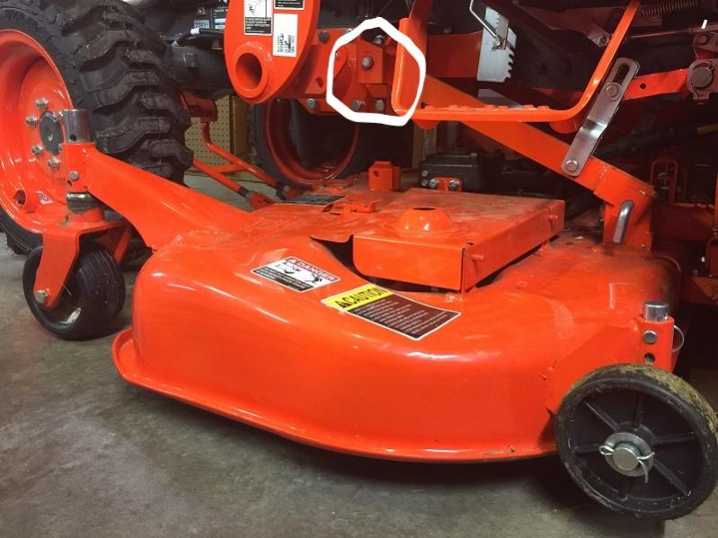

Okay old thread. Trying to install my RCK60-30BA to my B2650
Is this bracket welded on to the loader or a separate item bolted on.
I have a bolt on bracket for a tractor without a loader and a loader without this bracket?
Or are there two different bolt on brackets, one for without loader one for with a loader?
